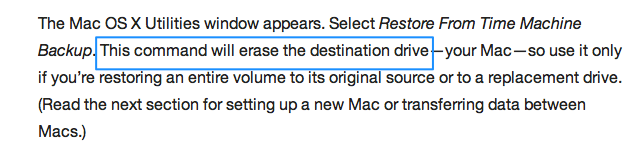

Yes, it will. If you erase then reinstall the OS, and then use Migration Assistant to pull in data from a backup, that may help. But if you reinstall the OS then "restore" from Time Machine, it overwrites the OS install you just did with the OS and data from the Time Machine backup. It is a complete waste of time and accomplishes nothing at all.

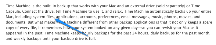

Not true. Time machine does NOT backup the core OS. Time machine is designed to restore your settings, data and apps to a new OS installation. Go look it up.
I'm sorry, but you are far far off here. Time Machine most definitely backs up the OS. There are countless threads here about users putting in a new, blank drive and doing a full system restore (including the OS) from a Time Machine backup. I just did it myself two weeks ago on a friend's Macbook Pro.
Read this.
You can also read more about it here.
Please read up a bit on this, because your posts are incorrect and it is confusing people.
A Time Machine backup does include the entire OS and it can be used to restore a system onto a completely blank disk without first installing the OS.
Again, if you install the OS, then "restore" from Time Machine, you just installed the OS for absolutely nothing because the TM restore wipes the drive and replaces whatever was there with the restore. Read this.
I know it is very confusing, and frankly Apple has not done a very good job explaining how all this works, but you are quite wrong.
Sorry, you are quite wrong. System files are NOT the core OS. Apparently you don't understand how UNIX works.
Time Machine backs up the entire disk, including the OS. If you read the links I posted you would see this.
You want more proof. Okay... here, here, and here.
I don't see what is so difficult to grasp here. Just about every other day there is a post here about a forum member using TM to restore to a blank drive. So you think they are just making that up?
