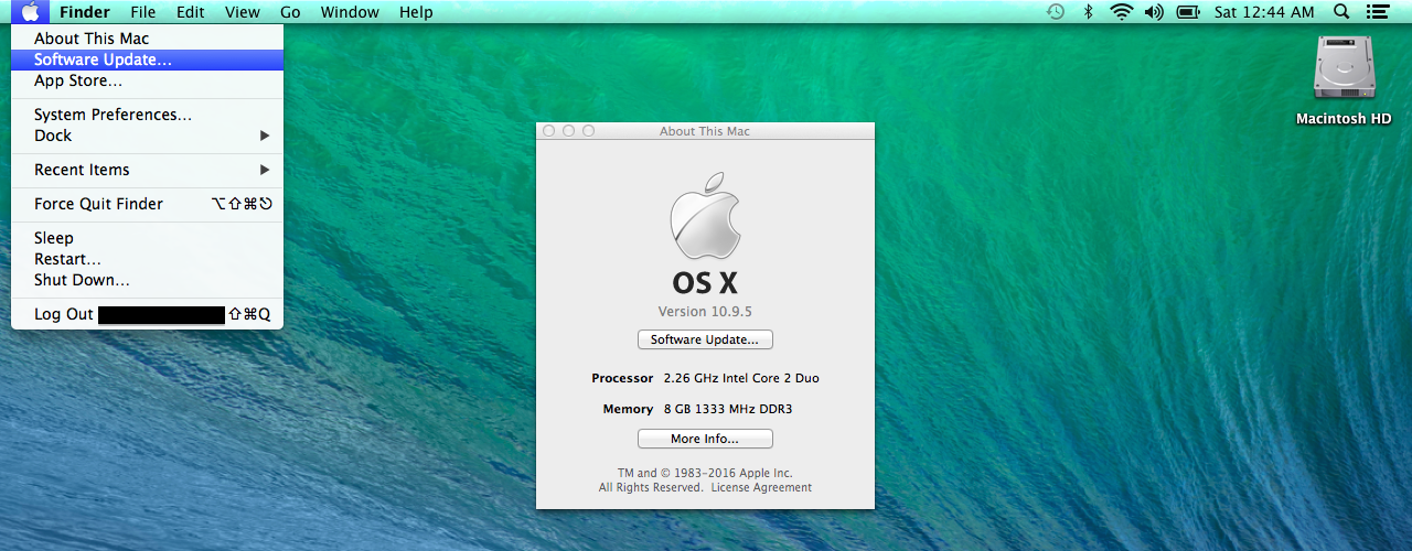

In Mac OS X 10.9 and older, Software Update is a separate shell from the App Store, available from the Apple Menu. This is why you're able to get updates without connecting to the App Store.
In Yosemite 10.10 and newer, Software Update is integrated into the App Store.
You cannot perform Software Update independent of the App Store.
*Mavericks 10.9 is the oldest OS X I have that can still connect to the Mac App Store.
**Software Update will download updates for most of the OS X going back to Tiger 10.4. I haven't recently tested anything older.

As you can see, in 10.9 and older the Software Update and App Store are completely separate functions in the Apple Menu.
So you can download OS updates without access to the App Store.
