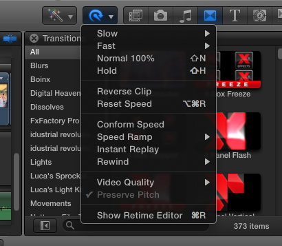

FrankieTDouglas: basically you add your 60fps clip into a 30fps project. If you do nothing, it will play back at regular speed (by eliminating every other frame) without you noticing the difference. Now if you want to slow it down and play each frame, you just click the retime button and then conform speed and it will make the 60fps clip 2x as long (slowed down) and play each frame. Here is a screenshot of what it looks like.
