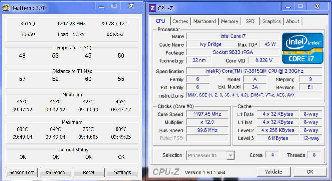

Just installed bootcamp on a base retina pro, comments and cpu boost speeds, temps, etc below...
Bootcamp installs very easily using the utility in OSX.
Let it create a USB stick from a win7 x64 ISO file.
Once installed just go the WindowsSupport directory on the USB stick and run setup.
Everything gets installed , video driver, wireless etc.
The video defaults to full 2880x1800 at 150% scaling and looks mostly great.
After rebooting programs look blurry with 150% scaling.
To try and solve that go into the programs properties/compatibility and turn DPI scaling off, the checkbox may not available to change with older programs.
I installed CPUz, RealTemp and Prime 95 and did some quick testinig.
Cpuz reports:
The memory is clocked at 1600 with rather slow timings 11-11-11-28 1T.
The CPU idles at 0.81 volts 1.2GHz
Under load uses 1.0 volts hitting 3.1GHz and rarely 3.2GHz

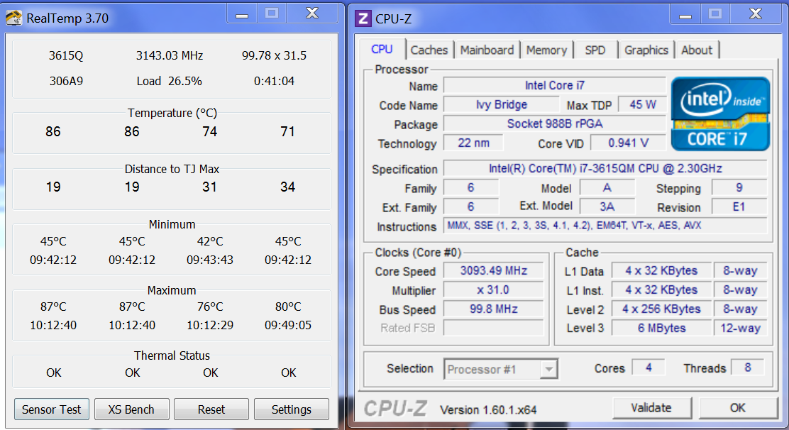

RealTemp:
Idles around 45-53C, but
under full Prime95 load it quickly SKYROCKETS to 90-100C !!!
Even under smaller 2 core loads it heats up quick.
I shut the load down when I seen it rising so fast.
Interesting I did not hear the fans kick in at all or they are very very silent.
Couple of screen shots attached one idle and one at 2 core P95 load.
Maybe others can report their findings,
the load temps are a concern
but maybe its an issue with the RealTemp 3.7 software.
If not I guess the CPU will be throttling a fair bit?

What you see is pretty normal. Prime95 is highly optimized, so it uses all available processor resources (similar to x264). Ivy Bridge should run 30-60 percent cooler, compared to Sandy Bridge, but not with Prime95 or x264.
Its does the same with games or other less demanding apps too.
Once the one or more of the CPUs hit 100% temps rise and rise fast.
A quick test in OSX and iStat is reporting normal temps, so its just a bootcamp issue.
I can live without bootcamp will just uninstall it, not going to melt a 2K machine for games.

It happens for a simple reason: fans are not working in bootcamp! You need an app to control them and you will get the same temps of osx, I was using " lubbo fan control" with my 2011 Mbp, try to google it and see if it works with ivy bridge
People aren't hitting high temps on OS X? Are they putting full load on it as well? On my Air (2011), full load on BootCamp AND OSX == 95C+-5
One of the reasons why the temperatures rose so quickly is that Apple reworked how the fans rev up within the past couple of years. Before they'd spin faster as the heat rose. Now they turn on just as the CPU is nearing its maximum temperature. The second way is how most non-Apple laptops have operated for years. Nothing to be worried about. If the Macbook Pro feels hotter to the touch it's because it's made of aluminum. Aluminum has good heat conductivity, unlike plastic, and actually helps cool the machine.
