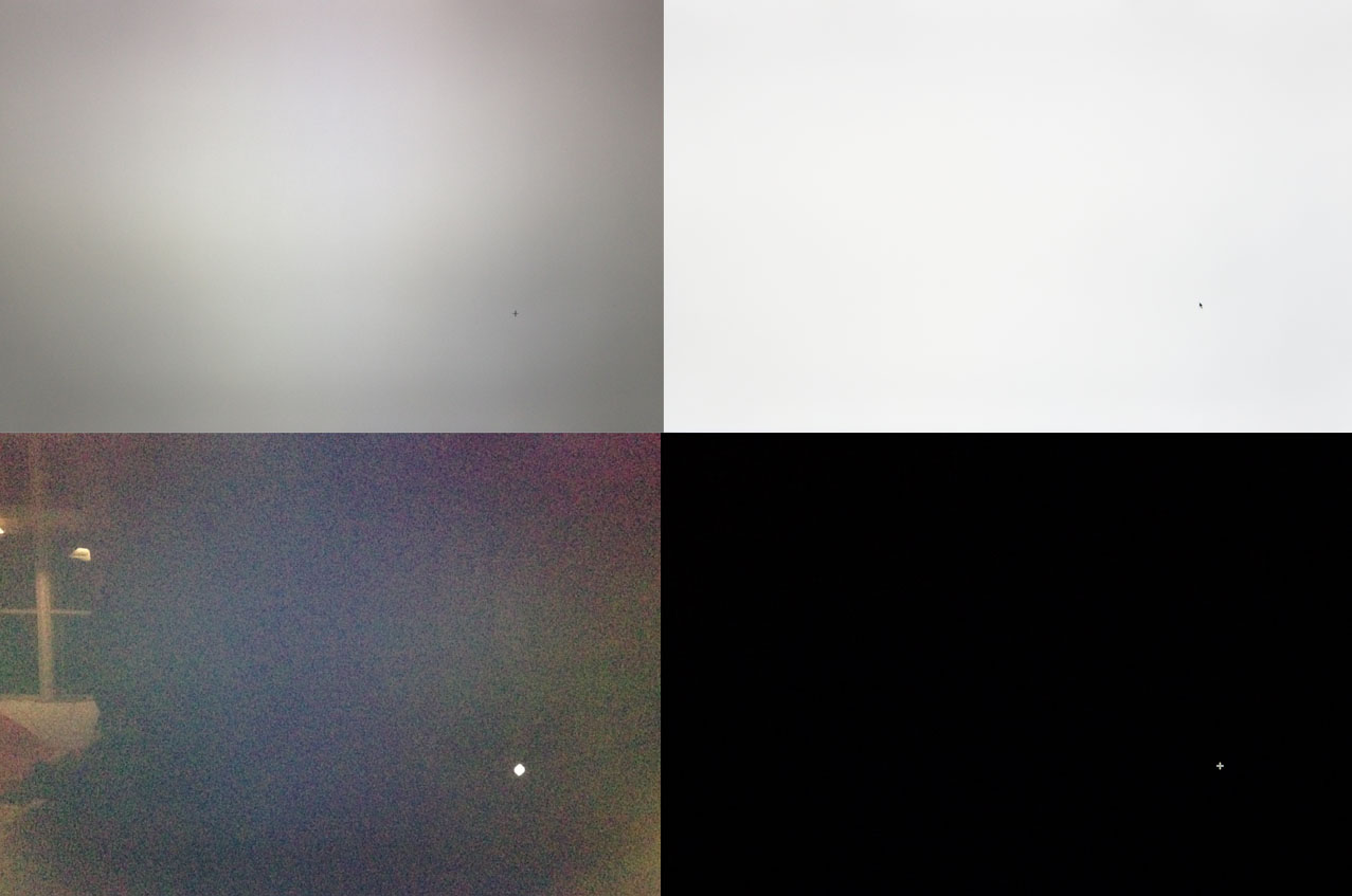

There are many, many threads concerning tint, backlight bleed and uniformity issues of 13" and 15" Retina panels. One thing that repeatedly comes up in those threads, is the question whether a single photo of the display is really representative of real life, or not.
I did this quick and dirty demonstration to show you the issue. I've taken some pictures, and made a composite for easy comparison.
Take a look at the picture below. Which one do you consider the better display, the one on the left, or the one on the right?
Here are my thoughts.
On the left: Purple tint on top, and dark corners, horrible uniformity. Might be a tad yellow too. Horrible backlight bleed, and the rainbow in the dark is quite awful.
On the right: pretty much perfect uniformity, no backlight bleed to speak of. Whites pure as snow.
After you've done the comparison, I'll let you in on a secret. All four images are of the same screen.
Why are they so different then?
The ones on the left are taken with an iPhone 5. It's an OK camera for a smartphone, but it still suffers from many of the issues all small cameras suffer from, like vignetting caused by the small objective, and noise caused by the small sensor. The pictures are also taken at point blank range, so the edges of the display are suffering from color shift caused by the viewing angle. These are straight out of camera JPGs, just cropped.
The ones on the right are taken with a Sony NEX-5N and a Voigtländer 35mm f/2.5 @ f/5,6, ISO 200 and a 1/125s exposure, two meters away. These are RAW-images, processed in Adobe Camera Raw, where only white balance was set, no other corrections were applied.
These images exaggerate the issue on purpose, the ones on the left are taken about as badly as I could manage, kind of a worst case scenario. But they actually bare shocking resemblance to many pictures I've seen posted in the threads, and that have been used to judge whether the display in question is good or not.
I know there are people with real display issues out there, and by no means am I downplaying or trying to dismiss them. If a display has clearly visible uniformity issues or image retention, then it should be replaced, no question about that.
TL;DR: What is the point of this post? It's this: if you don't see any issues with bare eyes, you most likely don't have any. If these issues are only "revealed" by taking a picture of them, then the problem lies more likely either in the method, or camera, not the display itself. By looking for problems, you might actually be creating them out of thin air. So stop looking for "hidden flaws", and enjoy your computers 🙂

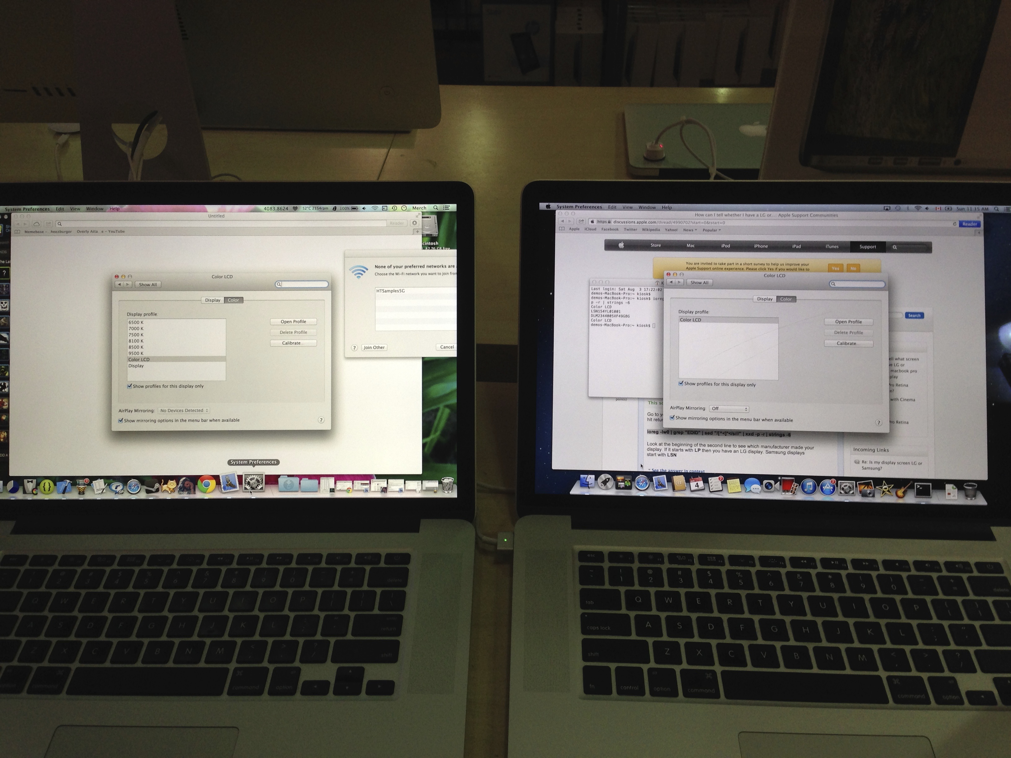

I don't get the point of this thread. Many people have had the following experience: they bought a 2012 15" Retina MacBook Pro and got a display with amazing colour and contrast. It developed image retention. They got the display replaced and immediately noticed a yellow tint compared to the display they just had. This is well documented on the Apple support forums. I'm one of them. A photograph of just the display isn't great but a photograph of their new yellowed display sitting next to a display showing colours as they remembered them is a good demonstration that Apple is selling displays with a bizarre yellow tint. These displays are used as replacement displays and on brand new machines. So I agree: a single shot of a single display is not as good as a shot of two machines side-by-side such as mine below. If you're in doubt whether or not your display is yellow tinted, take it in to an Apple store or other electronics retailer, set it next to a machine on display, and take a photograph. The difference with a yellow tinted display will be extremely obvious.

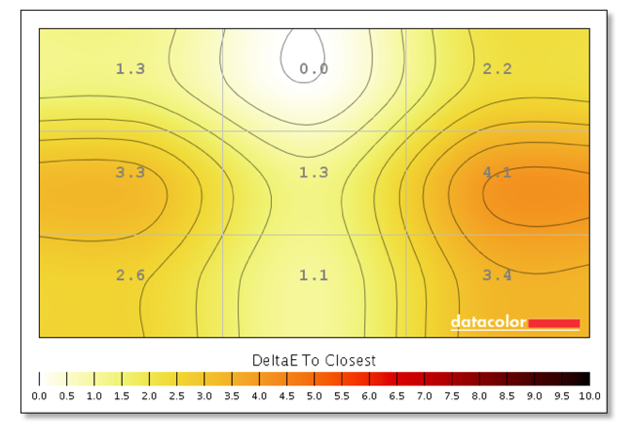

Is there a way to measure color uniformity (not talking about just looking at the display)?
Maybe you can measure colour uniformity by using a tool like the Spyder4Elite. Here's mine below. But it doesn't really mean anything to me because I don't know what values a properly uniform display, like my first one, should have.

If you read the whole thread, I think you'd find the method of comparing two screens better than just taking a single picture and cropping the background out.
That not at all what I said. You entirely missed the point....
Yes you do, because right after this you say:
...which is exactly the point.
TFTCentral has a huge amount of display reviews with measurements included. They also explain the concepts behind their measurements quite well.
Also a very good read is Rob Griffith's book Practical Colour Management, available as a free PDF download.
Some are better. That isn't atypical at all though. There are things they could probably do to improve uniformity, but I would not expect absolute perfection. The closest I've seen to perfection has been in the domain of desktop displays aimed at various media professionals.
