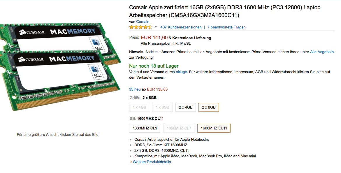

Hi!
I just ordered a 5K iMac with the i7 processor and 8GB of RAM. Can I use the two 16GB modules (see attachment) that I originally bought for my "old" 2012 iMac?
I'm not sure if the timings will be compatible.
Cheers,
Chris
