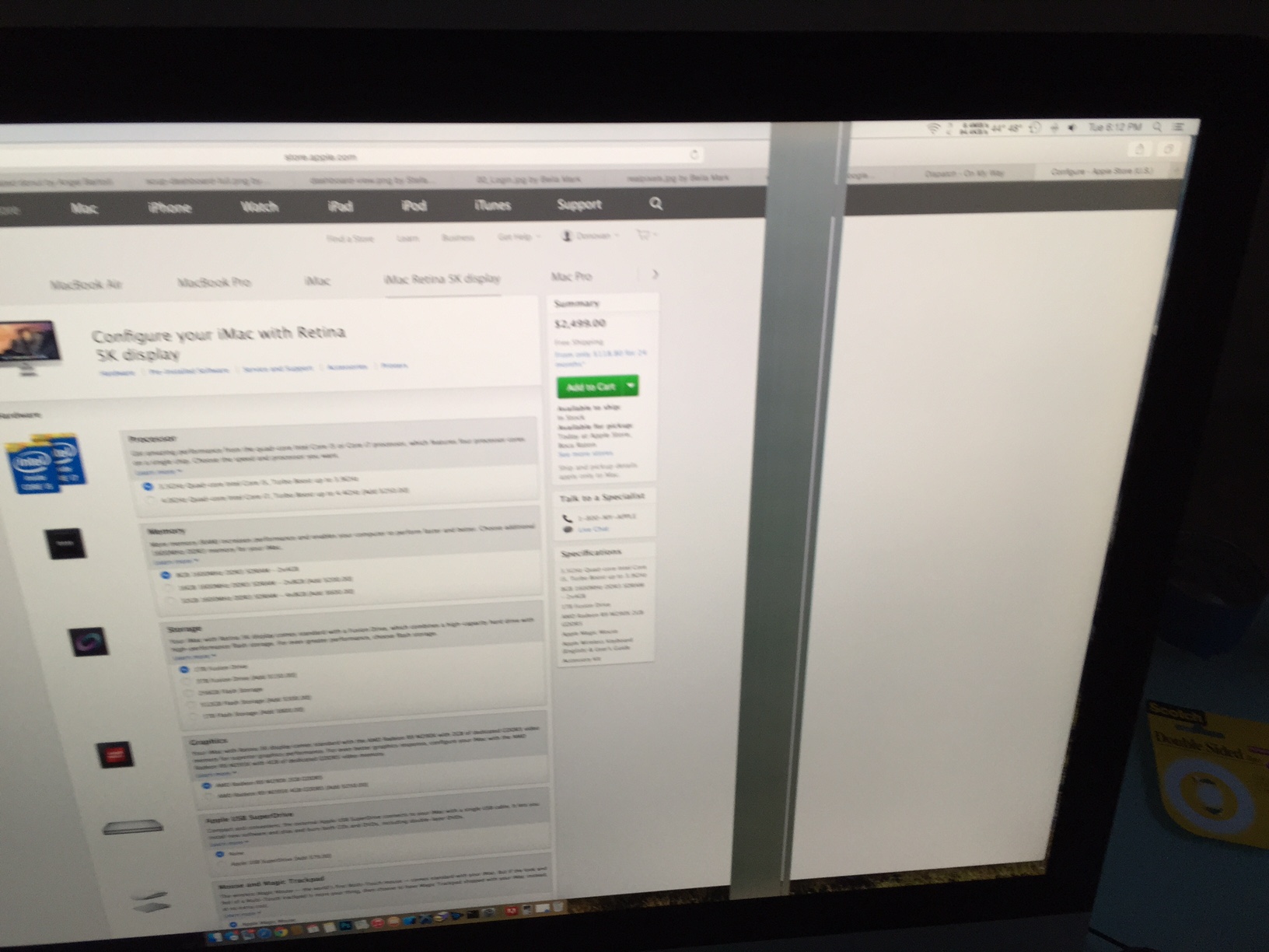

I turned on my Retina iMac a few moments ago and noticed a nice white then gray bar right through the display.
Does anyone know what the issue might be here? Definitely an issue with the display not the OS.

Display or GPU. Might want to reinstall OS X just to exhaust all options prior to return.
Any issues leading up to this? What was the iMac primarily used for? Just out of curiosity.

If it stays in the same place all the time, even at the boot menu, it's definitely an issue with the display or display cable. If this is the case your best bet would be to take it into Apple.
It does it all the time even in boot. The Apple store near me has a display in-stock to swap it out so going to try there.

You might take a screenshot (command + shift + 3) and see if the bar appears in the resulting image. If it does then it's likely the GPU. If it doesn't then, as others have said, it's likely the display and/or the LVDS cable.

Does this happen on the bootscreen if so then this would indicate its the display and not the GPU.
If I'm honest it don't look like a GPU issue.
Question did you or someone else try to open this display? that is what is looks like if you have busted one of the pixels in that display,The reason I know this I did that to my 21.5 iMac the second time I went inside of it.
It is damage and must be REPLACED..
So went to the Apple store near by last night and what a surprise they didn't have the display in stock even those on the phone I was told they did.
Anyway after explaining everything and then having the stores senior tech look at it I came home with a iMac that is now in even worse condition.
The senior tech and one other genius start pressing on the display and messing with the glass running there fingers all over the edges. They ended up pulling part of the glass off and cracking the panel. So my gray line is now a black line.
After there lovely work they decided to order a new screen so in 3 - 5 days they should have a new one to replace the even more broken one.

Replacing the screen may not fix the stripe. If you haven't bought Apple Care already, I would buy it before the 1 year window closes.
