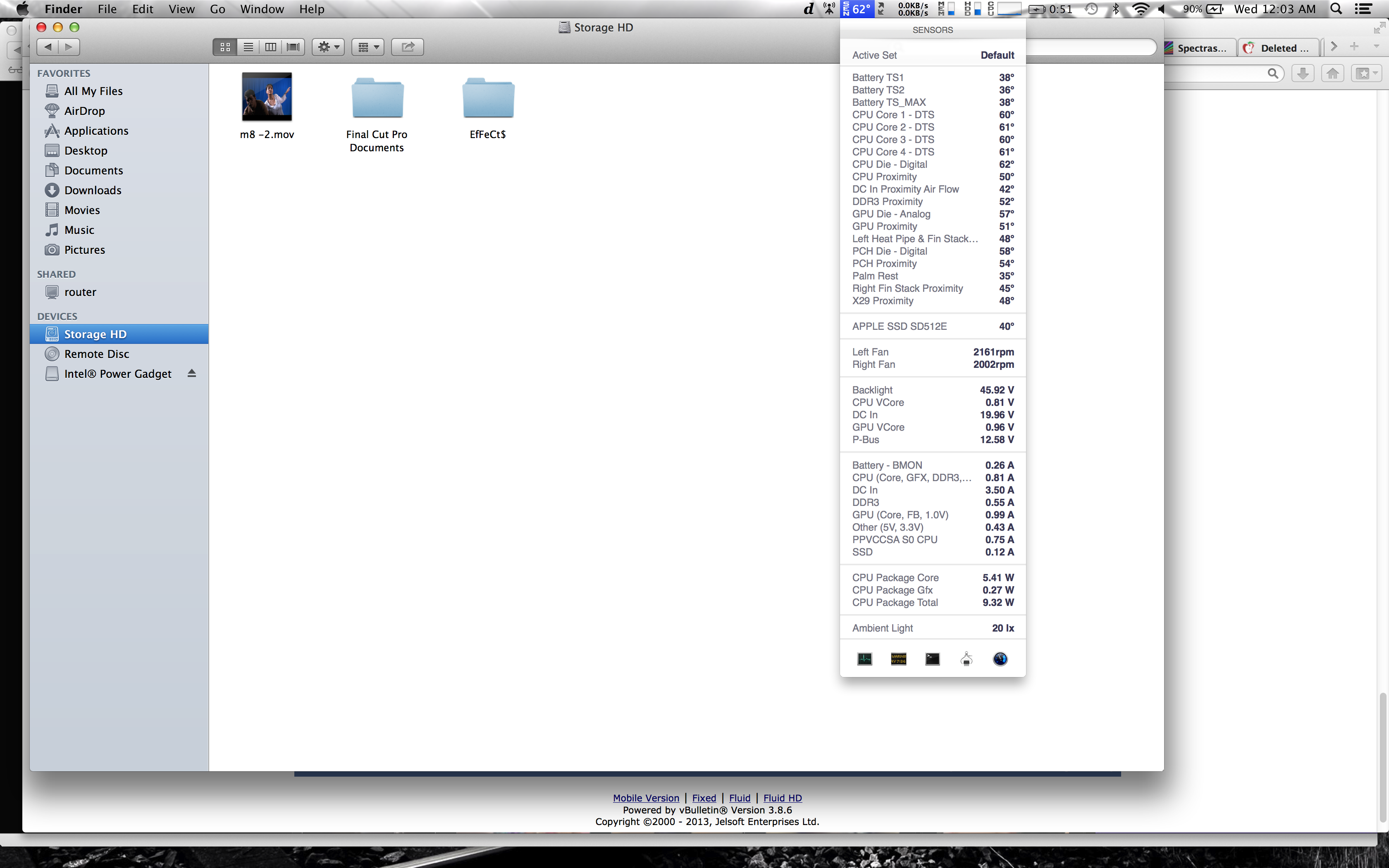

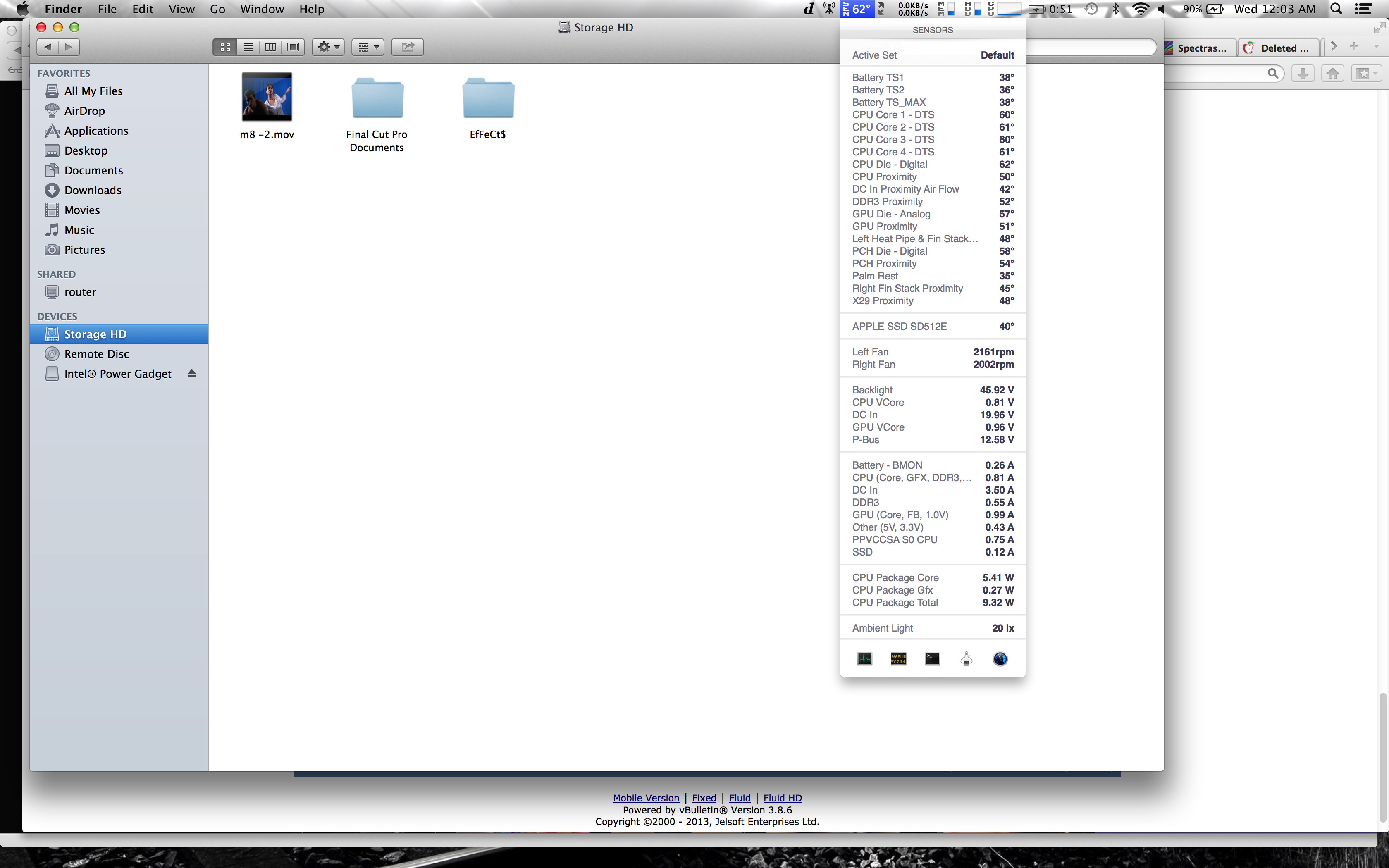

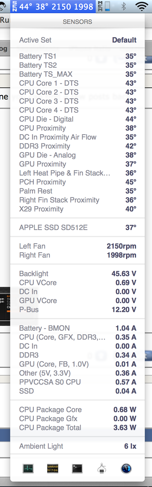

i have the 2.7ghz i7 with 16 gigs ram
i use istat pro
heres my current temps with 22 tabs open on firefox. Itunes playing some podcasts and downloading new ones.
My macs just 6 days old.
il post some pics later on when im working on aperture or logic.
i use istat pro
That CPU temp doesn't count, mine is low too, it's the CPU proximity temp.
The high temps are the CPU Die temp and CPU Core temp.
no option for that in the istat pro, i'll download the istatmenu and post back.
thanks for pointing that out. However i must say with the same usage i had on my 13inch cMbp i feel the retinas fans not shooting up that much and definitely not noisy. While gaming on rage i can hear the fans but it wasnt as noisy as the cMbp.
edit: installed istatmenus
Ok now try to do something intensive, I see that your CPU is idle in the screenshot.

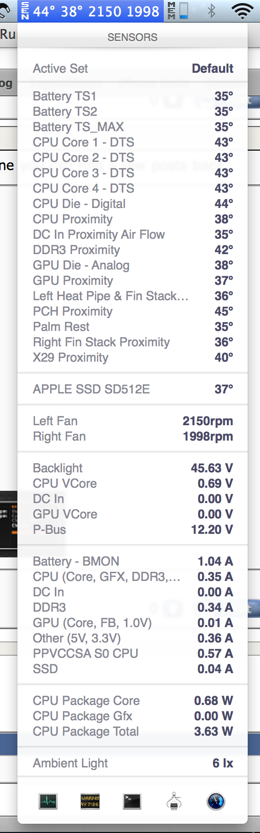

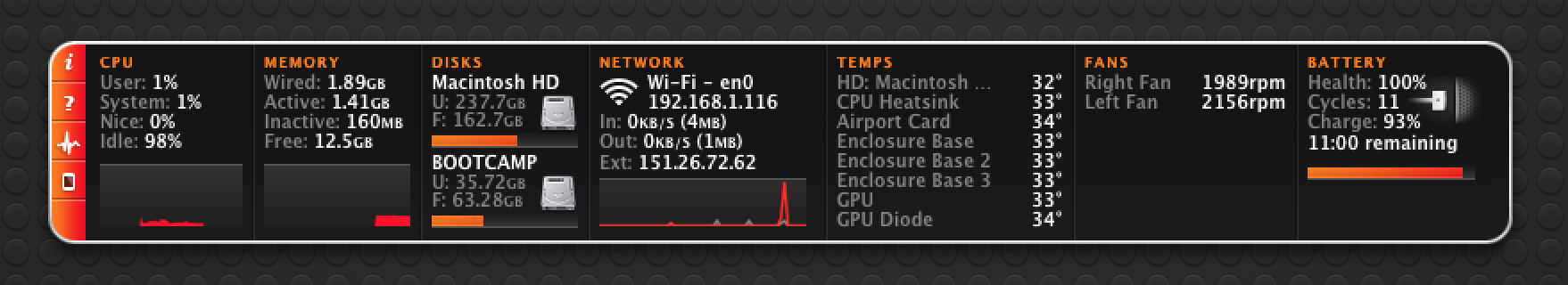

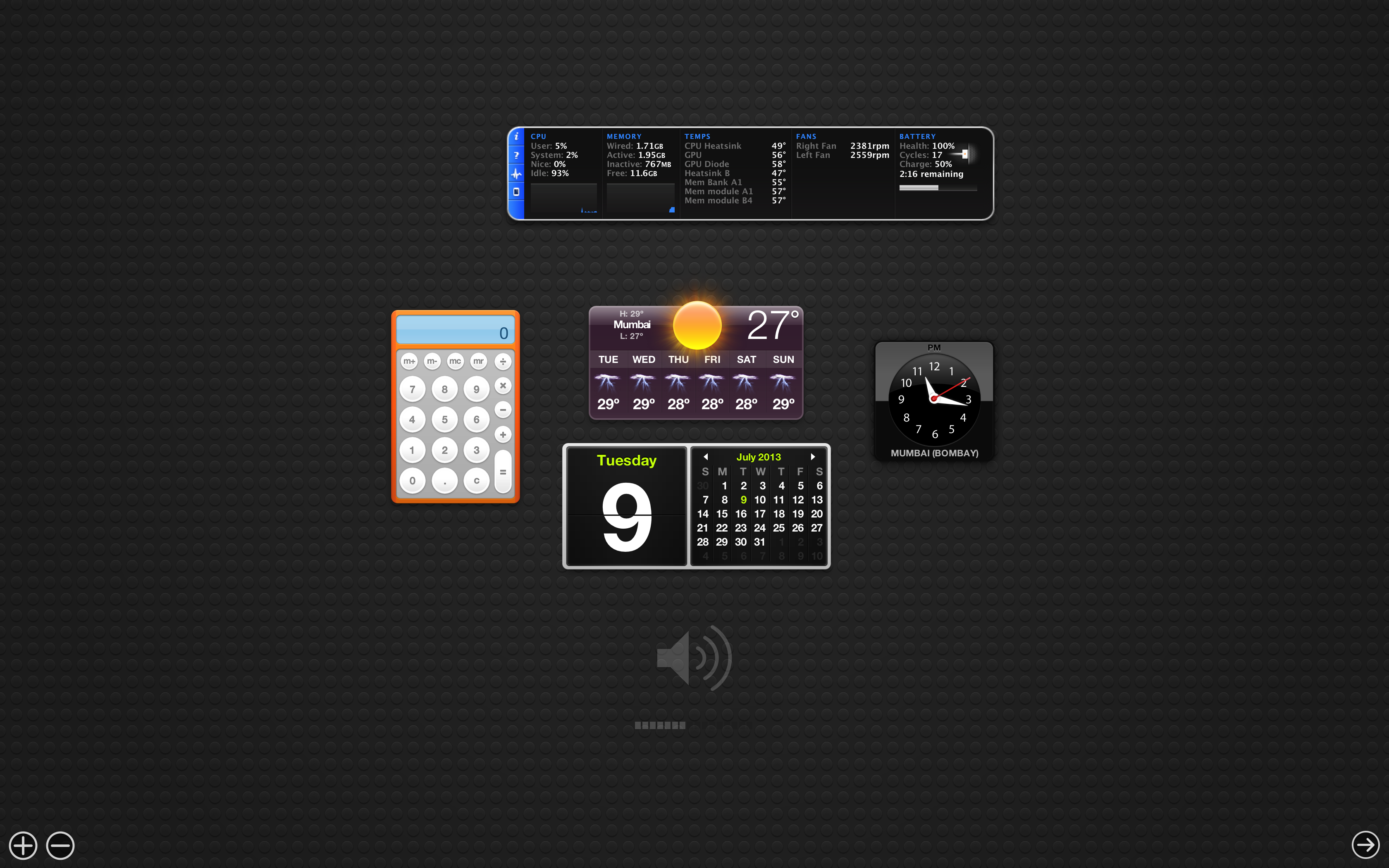

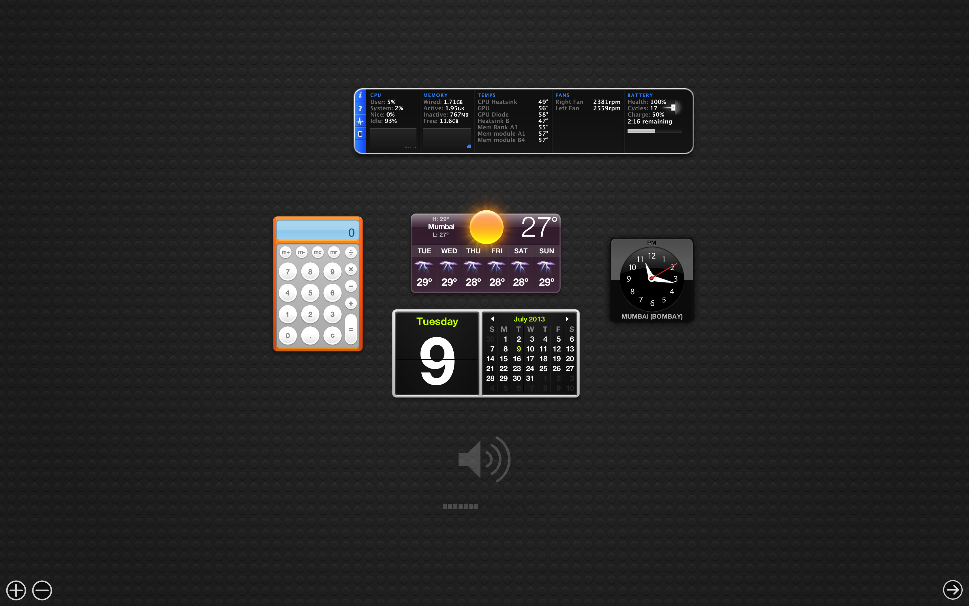

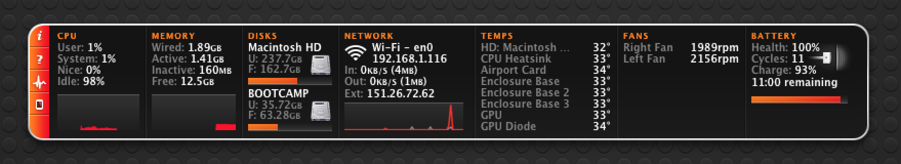

Here's my temps in idle, for the widget I'm using the tweaked one you can find a few posts back.
Computer was unplugged, and using internal monitor/integrated gfx.
