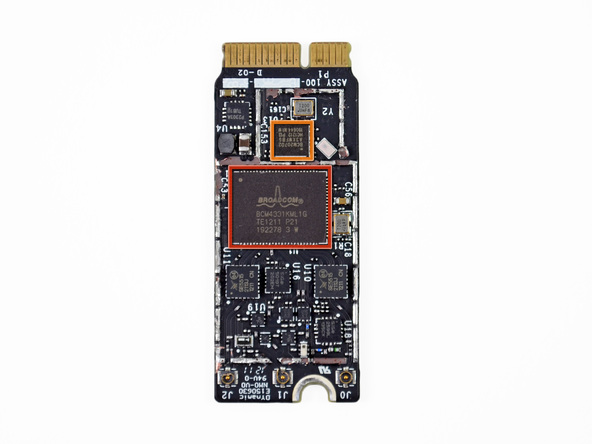

According to iFixit the chip is a 802.11n chip:
nWQtA3qxF3kFkjWD.medium
The BCM4331 IEEE 802.11n solution delivers full 3x3 with three transmitting and three receiving streams of data in both the 2.4Ghz and 5Ghz bands. Increased number of streams and antennas results in faster speeds, longer range, fewer dropped connections, and better overall wireless coverage.
http://www.broadcom.com/products/Wireless-LAN/802.11-Wireless-LAN-Solutions/BCM4331
I don't know enough about the 802.11ac spec to know if this chip is compatible via a firmware update, but I would suspect not.

iPod Touch 2 had Bluetooth on the chip...but didn't have bluetooth when it was released. In the next OS update they patched it and enabled it. It could be possible....doubtful...but not impossible.
See why here:
http://www.anandtech.com/show/6023/the-nextgen-macbook-pro-with-retina-display-review/13
The next-gen MacBook Pro is equipped with a decidedly this-gen wireless stack. In other words it uses the same 3x3:3 WiFi solution that was present in the 2011 MacBook Pro and is present in the non-Retina 2012 MacBook Pro as well: Broadcom’s BCM4331.
Like a good silicon company Apple appears to mitigate risk in design by sticking with known-good components wherever possible. Major changes to the industrial design are typically paired with comparatively minor silicon changes, and other components are kept as static as possible so long as they don’t overly compromise experience. While 802.11ac dongles and routers are just arriving today, Apple likely froze the Retina MBP’s wireless configuration quite a while ago. Rather than be caught shipping potentially unratified hardware, Apple went the safe route and stuck with 802.11n.
Read more at http://www.anandtech.com/show/6023/...-retina-display-review/13#4m3Vw2rkjFsQSyup.99

It would surprise me if Apple could write firmware that enabled hardware that isn't on their computer.
I frankly don't know if the Broadcom WiFi chipset in the MBPr can support 802.11ac. It is possible, and it would not be unprecedented.
Apple has actually done this once before. In January 2007, as Apple prepared to roll out the 802.11n Airport Extreme base station, the company announced that many existing Intel-based Macs sold as supporting 802.11g, could be "unlocked" with a software patch to support the draft 802.11n specification (The n specification wasn't actually ratified by the IEEE until September 2009). This was great news for those of us who had MacBooks that we thought were limited to 802.11g.
There was some controversy about it at the time because Apple was forced to charge $4.99 for the "upgrade" as a consequence of the Sarbanes-Oxley Act. (For some fascinating reading about poorly conceived legislation in the US, do a Google search on "Sarbanes-Oxley and unintended consequences".)
One thing to note about 802.11ac is that it will be limited to 433Mbps with a single antenna. It supports 8 bonded 433Mbps streams, for a total of about 7Gbps, but, at this point anyway, each spatial stream requires a separate antenna. Cramming up to eight antennas inside an ultra-thin laptop will be a challenge. It's unlikely that the WiFi subsystem in the MBPr has multiple antennas, even if the chipset secretly supports 802.11ac. And, since the Broadcom BCM4331 is pretty well understood at this point I think it's unlikely to be able to converted to "ac" with software
According to Anandtech's review 3 spatial streams are used since the 2011 MBP, therefore, in my understanding, there are indeed 3 antennae in the MBP.
