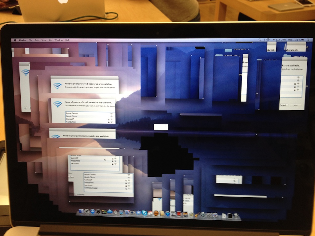

I'm experiences serious screen tearing (if that's the correct term) with the new rMBP. Here is an image of my screen: https://dl.dropbox.com/u/345710/photo.JPG
The tearing starts pretty randomly. Sometimes every 5 minutes, sometimes it may take a couple of hours.
I have previously used Retina Displaymenu V0.2 to enable the unscaled native resolution. I have stopped using the program and reinstalled Lion using the recovery part ion (retains user files and settings). The problem still persists. Any ideas? The screen can be cleared momentarily by using Expose to reveal the desktop; this appears to "wipe" the screen clear for a moment. A more permanent effect (5 minutes to few hours before the problem reappears) can be achieved by changing the resolution or by booting the laptop.
I think that my only option is a complete reinstallation of Lion. It's hard to imagine that this would be hardware-related (?) because the screen can be cleared for a while by changing the resolution.

The computer was in 2880x1800 mode when it woke from sleep and now I can't change the resolution anymore in System preferences -> Display settings! Haven't tried booting the computer yet but this is pretty worrying. Despite the reinstallation of the OSX the Retina Displaymenu V0.2 still appears to have some effect on the computer. Perhaps people should use the program with caution. I have updated the title of the thread accordingly.
UPDATE 2: Problem apparently fixed by disabling automatic graphics switching in system preferences. Retina Displaymenu V0.2 not involved in the tearing problem. Still kind of weird that the computer returned to the 2880x1800 mode even when I had done everything possible (except clean installation of OSX) to remove the effects of the program.
Reinstall Lion, instal as few apps as possible and observe the system. If the tearing persists it`s likely your GPU starting to fail does the machine do this when relatively cool or when it has been on for some time and the system is hot
Unfortunately, you can't rule out hardware. When you change your resolution, it basically re-initializes it, allowing the GPU to recover from whatever failure it had previously. It doesn't mean its hardware, it just means that it could be.
I'd take it back to the apple store as who knows even if the problem goes away upon a reinstall there is no guarantee it won't come back later on and cause even more issues.
Re-install is the quickest way to find out if its software.
If it persists with a fresh install, you have a hardware issue.

download gfxcardstatus and set it to nvidia graphics only and see if problem persists. then check integrated graphics chip.

EXACT same thing has been happening to me. Apple took it back no questions asked. I'd advise you do the same.

Is it possible that the problem is related to SOFTWARE rather than HARDWARE? If I could fix the software problem then I wouldn't have to wait two or three weeks for a replacement. Could it be that I have been finding this out all the time? So you can still **** off.
The problem was fixed by disabling automatic graphics switching. I try turning it on again once ML (or a rMBP software update) is released. If it still doesn't work, I'll take the computer to a repair shop when replacement units are more readily available.
The issue doesn't sound like an overloaded OS, and it's not like Windows where bloated registry might actually mean something. That's one of the things I thought they would address by now, but it may be a complex issue.
Please let me know, Jimmypop, if you take your laptop to an  service provider and hear what's causing the tearing. My repair shop is understaffed due summer holidays and I can't afford to lose the computer now for extended period of time due to occupational reasons.
If it is the HD4000, you may end up with an eventual logic board replacement. They use both new and refurbished parts on warranty repairs. Personally if it's such a thing this early I'd prefer a new computer. Now what I don't understand is that you bought something for occupational reasons without keeping the old one while you test it? I'd always suggest making sure the new one is okay before ditching the old one. This goes double with a first generation product.

May be an incompatibly with an app, or the driver, gfxCardStatus can help to isolate if it`s the integrated or discrete GPU, fewer app`s on the system will make easier work of isolating the issue. I wonder if anyone on ML is seeing this issue.
Either GPU and it will be a new Logic Board minimum.
