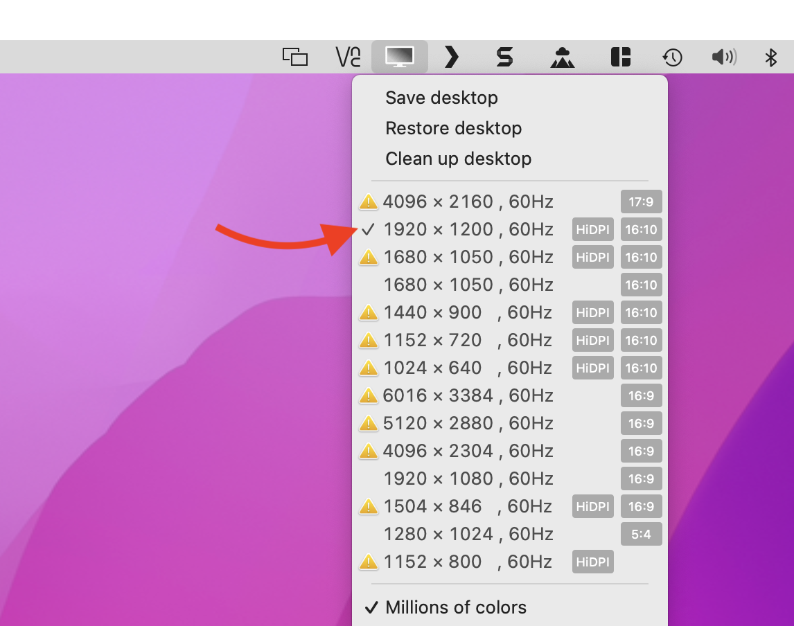

I use SwitchResX and get a beautiful Hi-DPI image while remoting in on my Pro Display XDR.
