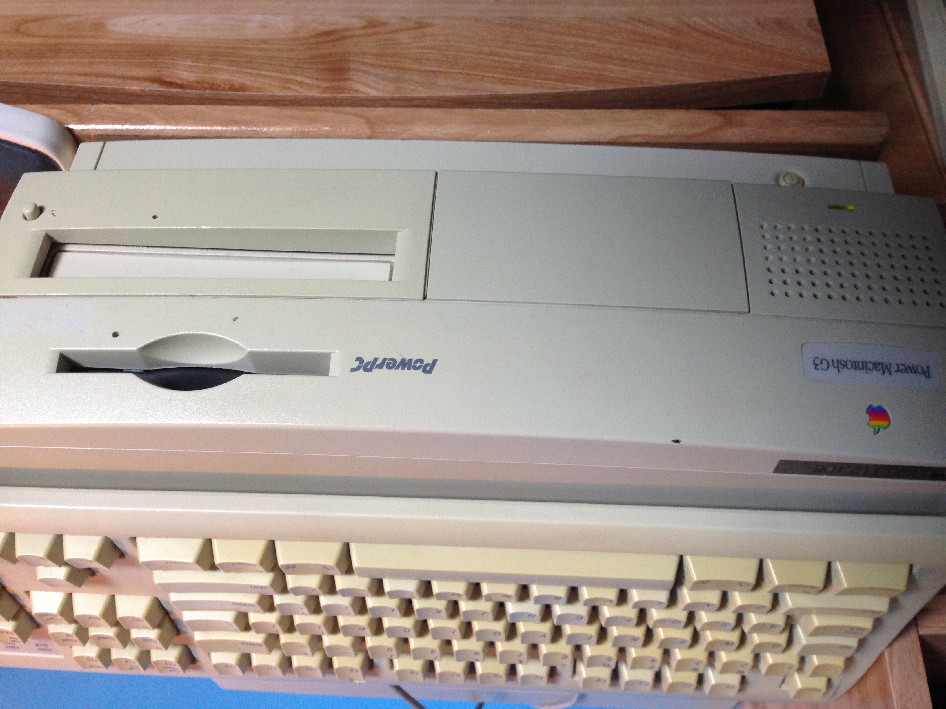

For the longest time i've wanted to revive my Old Desktop Beige Power Macintosh G3. Its been sitting in my closet for about 2 years now and firing it up it quickly came back to life. Seeing another fellow post here about the same system got me thinking what i can do with it. I've seen many guys get leopard to run on these old timers with a G4 CPU in it but i dont really want to spend any cash on it.

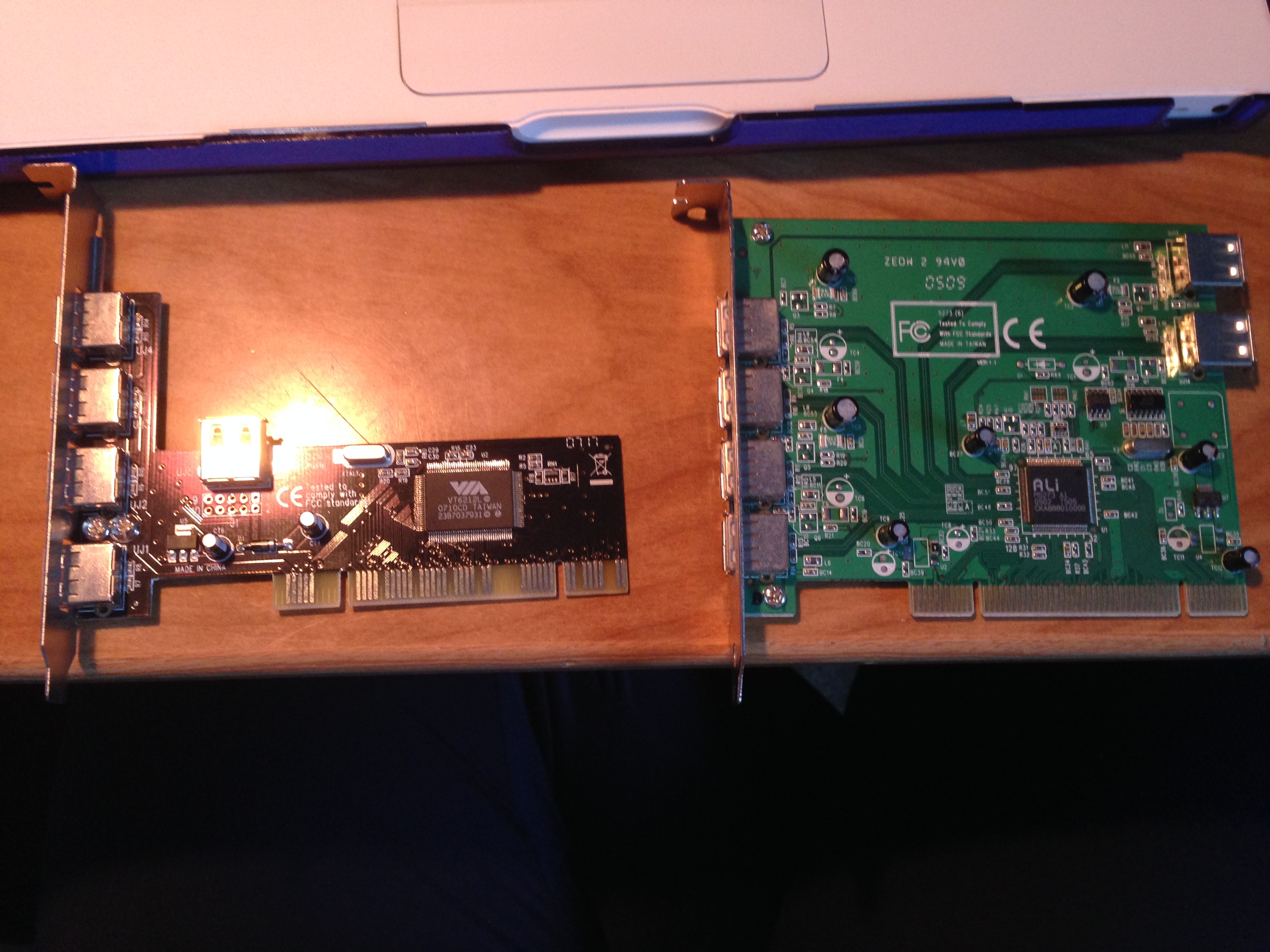

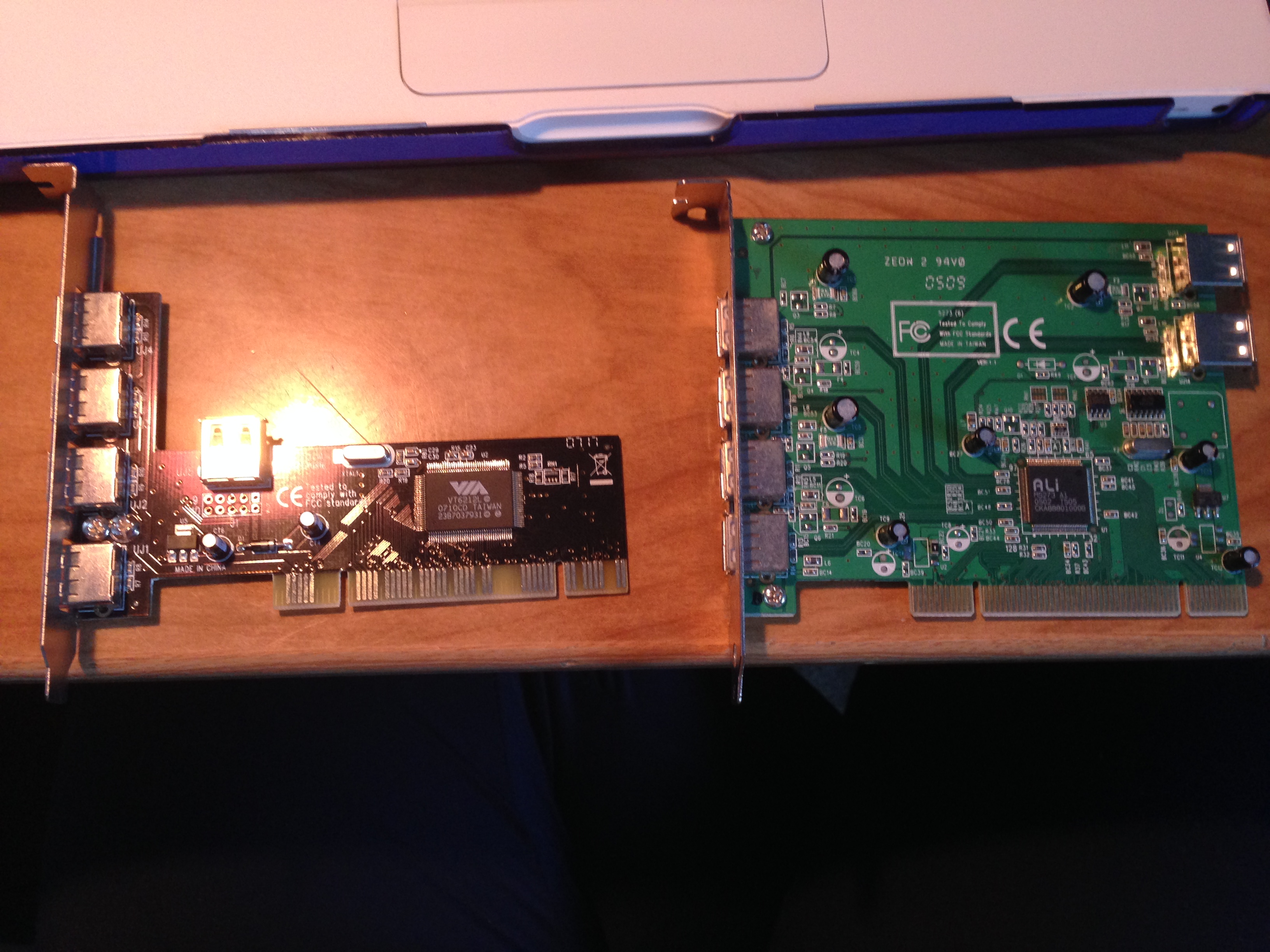

I've dug around in my room to find 2 Startech usb 2.0/1.0 PCI cards as well as (yes) 2 Firewire 400 cards. But not sure if i really need the firewire. I realize firmware doesnt know USB but the software will once its installed. How can i be sure that any of my cards have support by OSX?

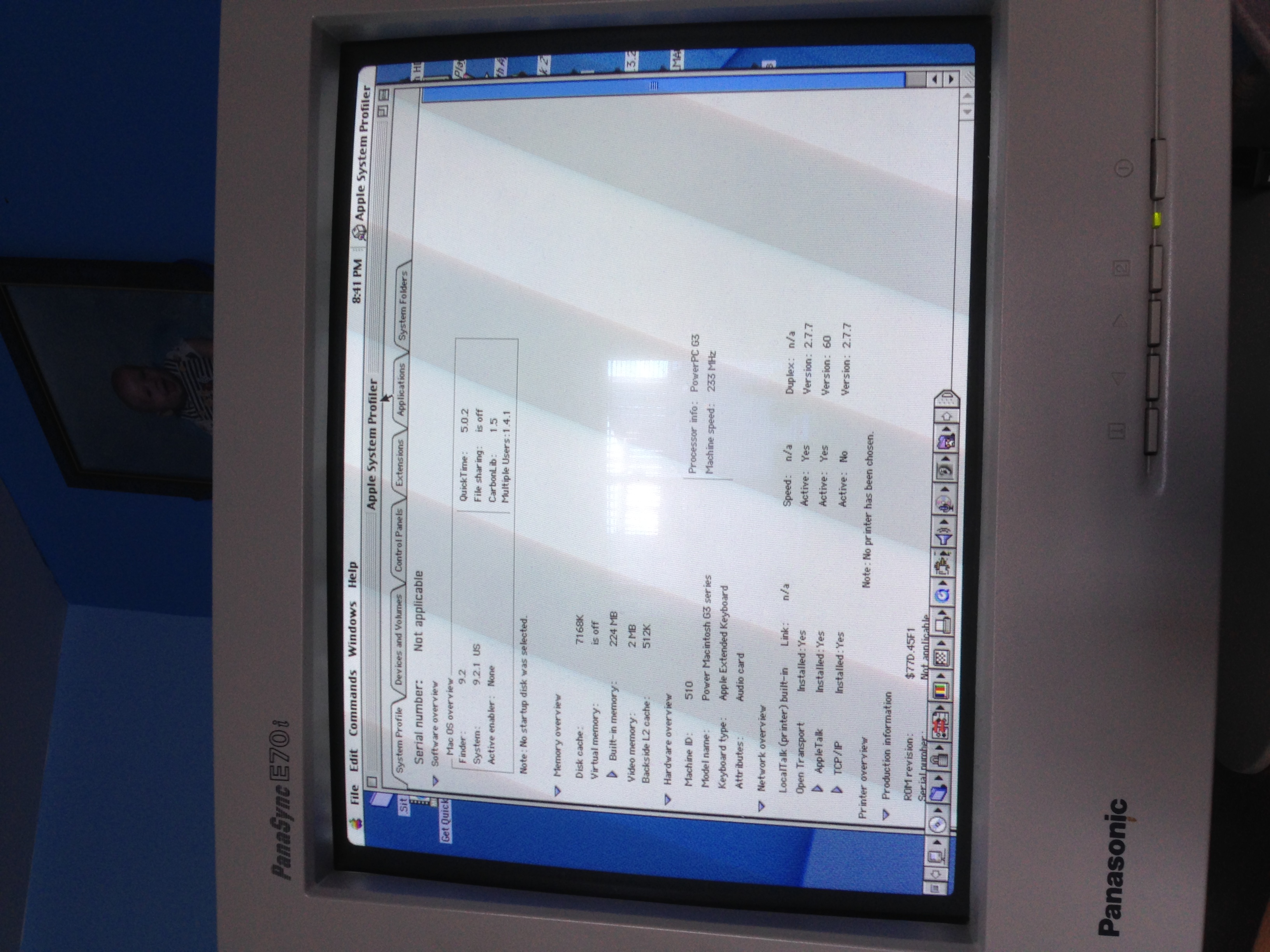

In the terms of OSX i know this machine can run Jaguar 10.2.8 (legally, according to apple) but i know using Xpostfacto i can get up to tiger on this machine. I was thinking maybe getting Panther going on it as the machine has its standard on board graphics. And is currently booting Os 9.
I tried getting the floppy disk drive to work but according to the previous owner that i bought it from years ago it was shot. So a few months ago while at work someone brought in a dead Power Macintosh 7500 that was dead. And even if not by the time i found it at the back it was mainly stripped of its Ram, CPu and other cards. So i snagged the Floppy disk drive haha.

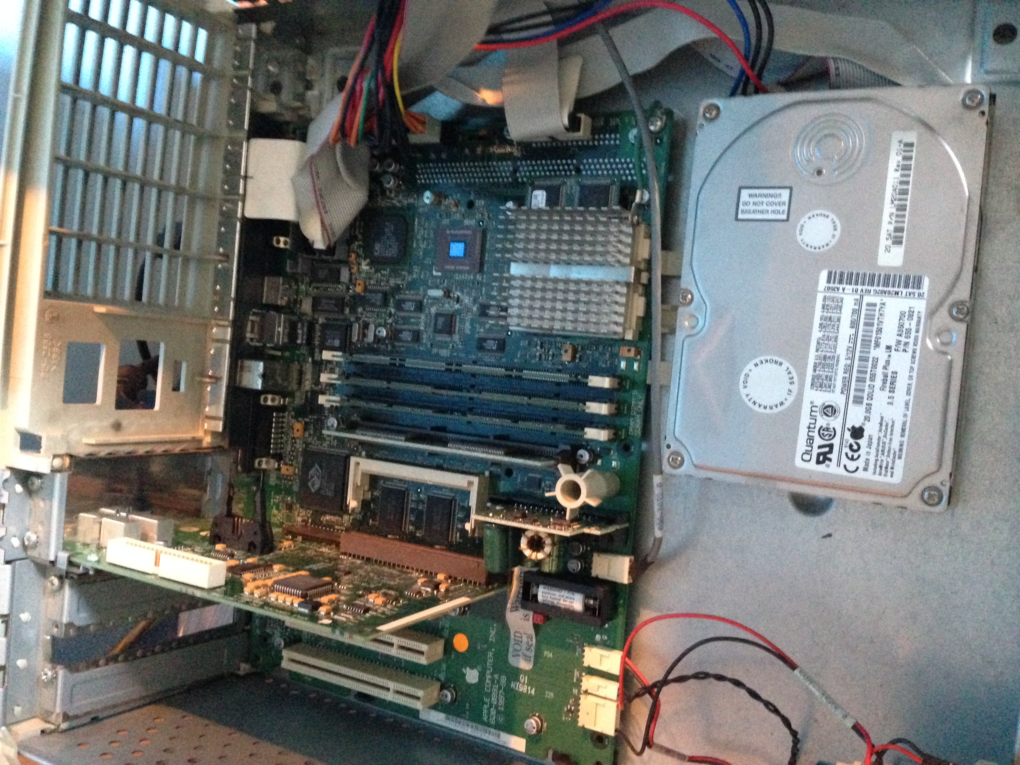

Its a jumper guide for the jumper settings beside the clock battery and covered by the "warranty void if removed" sticker. But i dont want to void my warranty! 😉 But anyways was wondering if anyone has overclocked this Macintosh and how high is a safe bet? i dont want to kill it.. Its currently clocked at the stock 233Mhz. But like maybe to 350-400 would be nice. This thing flies in os 9 it would be nice to give it a kick if i can right?

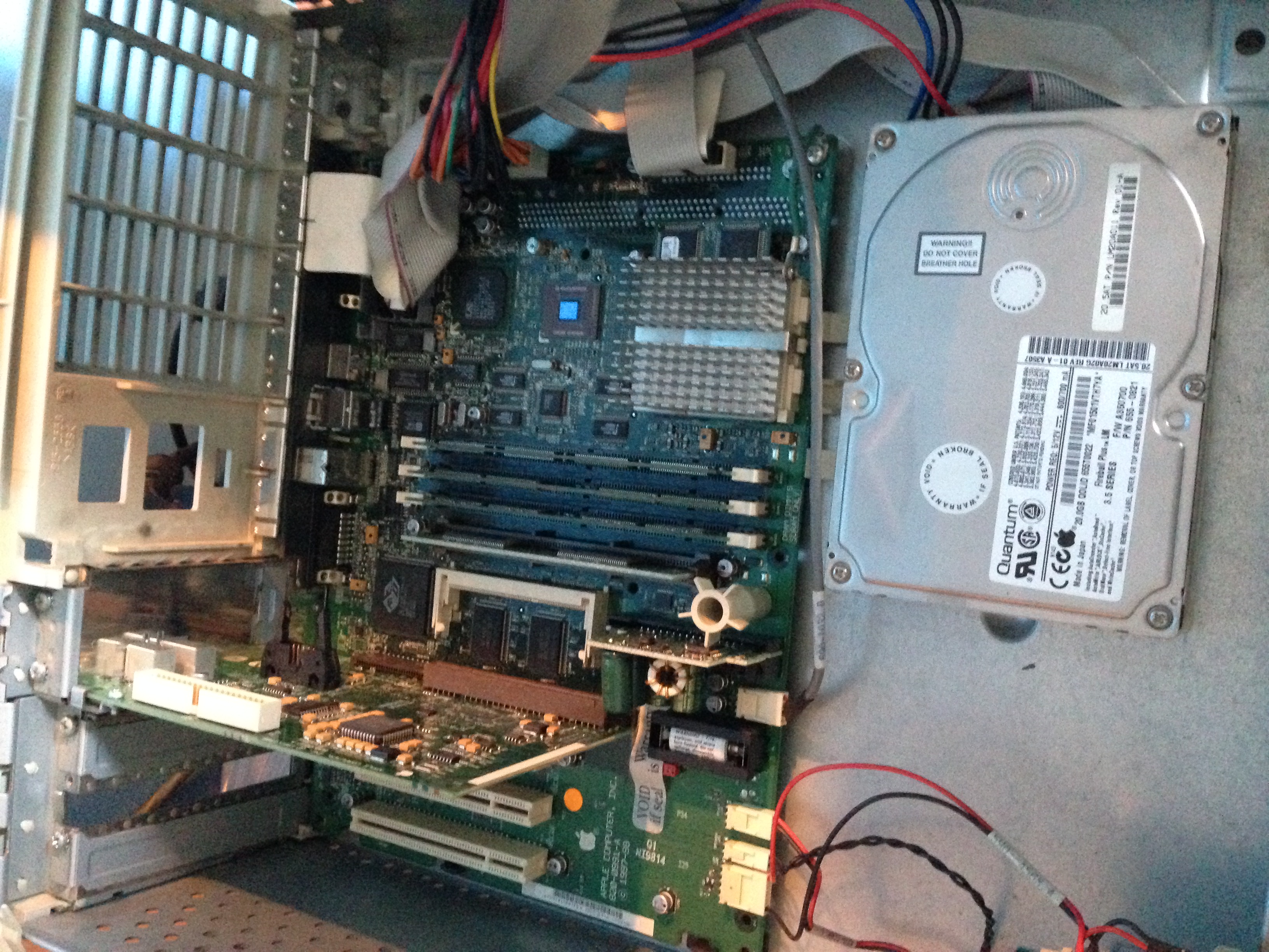

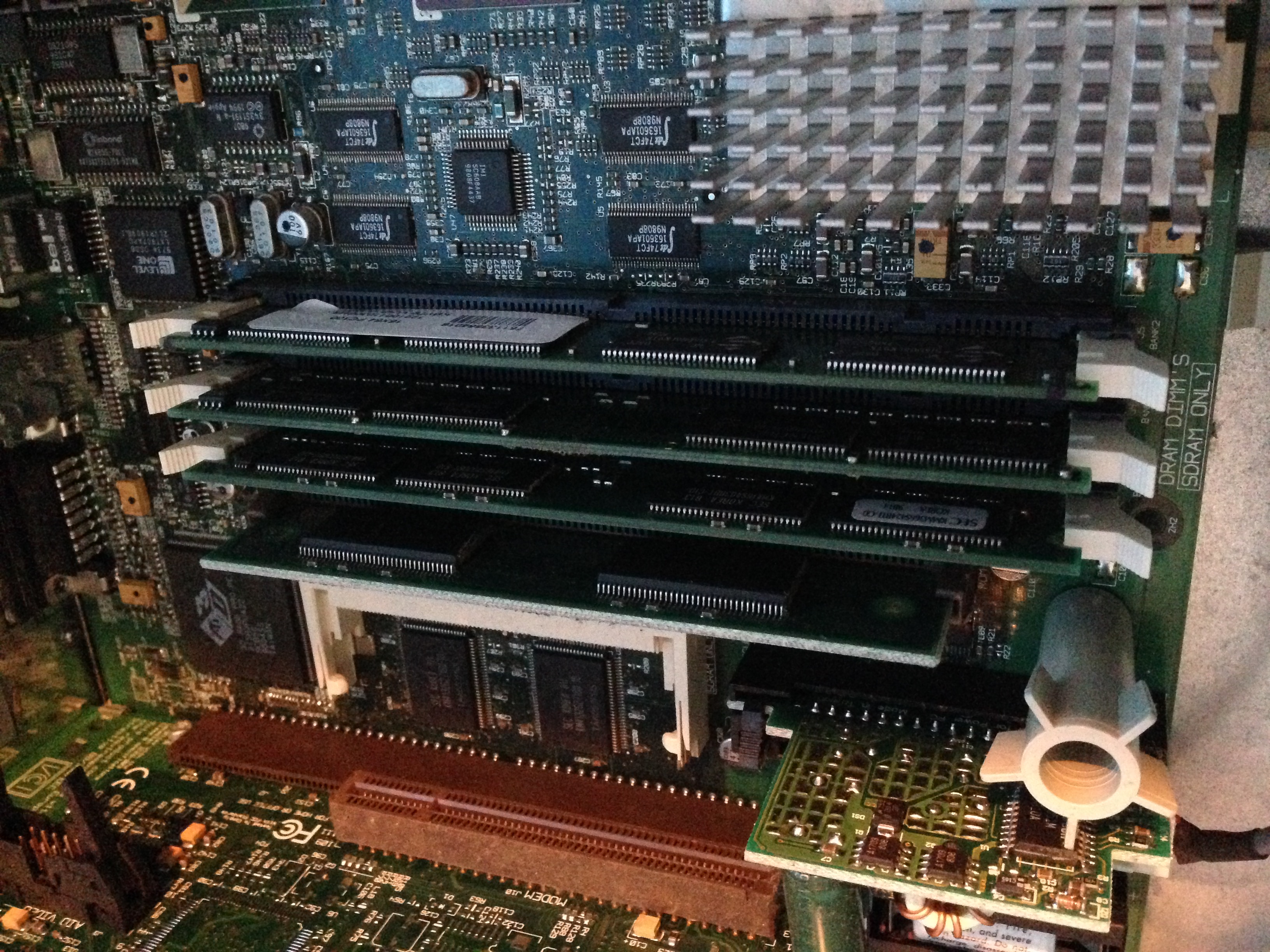

This is just a question i have from looking at the motherboard. Beside the RAM slots there is a expansion card of some sort. What is that? i know its not VRAM because thats the laptop RAM looking slot which is empty. So what is it?

The extra expansion slot is for the "personality" card, which provides the audio and-depending on the card installed-some additional A/V functions(most of which you lose in OS X).
BTW, if you're referring to the brown slot on the personality card, I think this accepts an internal modem.

I was also wondering about that personality card.

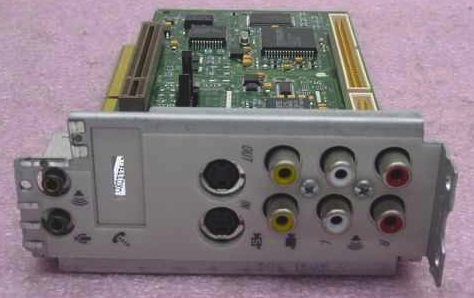

From Wikipedia:
Personality Cards
Personality cards are a type of specialized PCI interface card that only the Power Macintosh G3 models can accept.
Modem Card
56k Modem card with Stereo Mini-Jack Audio In and Out jacks
Audio I/O or AV I/O Card
Composite Video In and Out, Stereo RCA Audio In and Out, S-Video In and Out, Stereo Mini-Jack Audio In and Out
Theres also a card with AV ports; called a `Wings` card.
http://www.welovemacs.com/8200971a.html
More than likely you'll be able to hit 266 or 280MHz but I don't see getting any more than that without some kind of extra cooling. I was able to hit 350MHz on my 333, but it wouldn't do anymore than that. That also upped the BUS to 70MHz. The best source for G3 overclocking I've ever found was http://www.drivejumper.com/ClockupG3/homepage.html

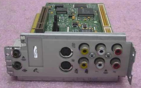

From Wikipedia:
I have a Molar with the wings card, back when I had it setup in my office I used the composite input to watch DVDs.

Alright. all great tips. Any ideas if any of those USB cards will function? i tried one of them with the Os 9 install it has. Not sure if i need to download drivers or do they come with OS 9 but where not installed because it had no usb then?
I have a USB card Identical to the one with the green PCB and ALI chip set in my G4 sawtooth and it works in OS X and OS-9.2.2 with out any drivers 🙂
