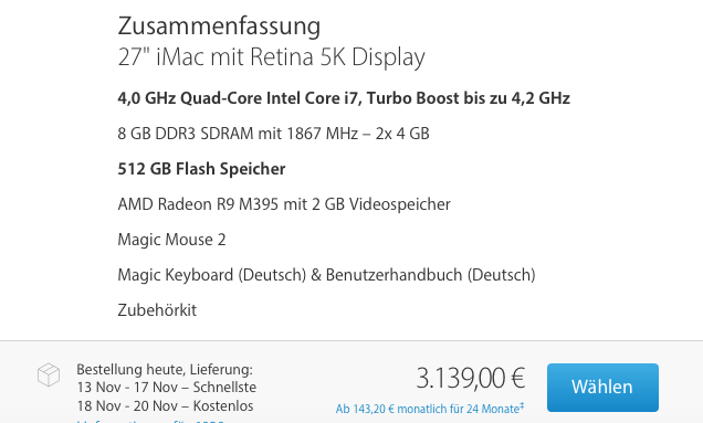

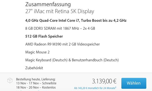

Did anyone notice that the price is the same for i7 - M390 - 512 SSD and i7 - M395 - 512 SSD:

Not in my store - the M395 variant is approx. 50 € more expensive…
Just checked some online stores. Seems to be in some stores with € only. I noticed that the iMac in both posted configuration is 30 € more in the Netherlands. Maybe because they have 21% VAT. But the price in Germany and Austria is the same, although in Austria the VAT is 20% and in Germany only 19%.
