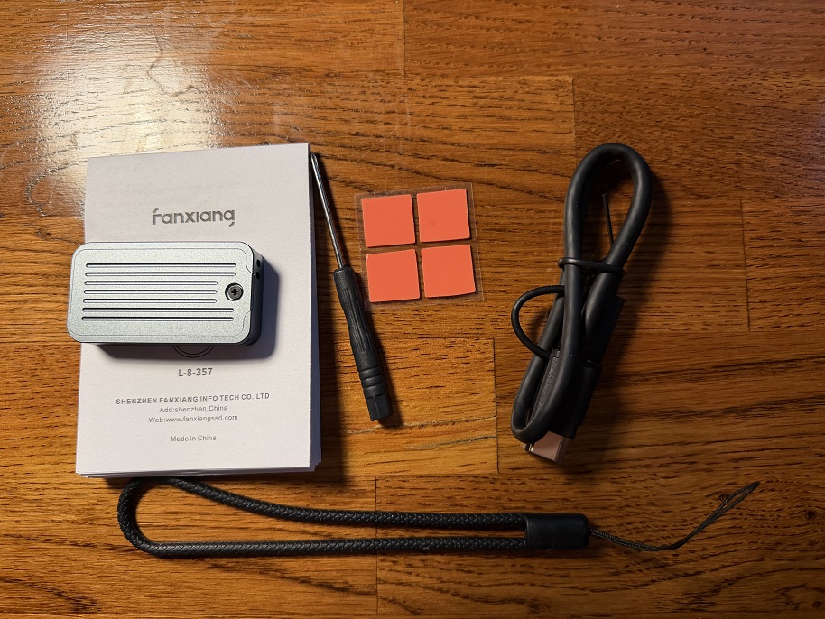

I soon discovered its too small for the MTS400, which is a bit longer than the 2230.
Here is what you get, minus the screw closing the lid, and the spindle it runs through that supports the end of the SSD. I had some 1mm Gelid pad around so I used that. Maybe I need to go back and remove the info sticker that was on top of the SSD. I lazily just applied the pad to it.
Installation was a breeze. It does get toasty though.

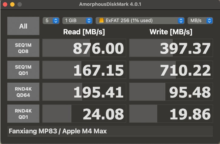

A test provided these numbers, which I think is way too slow for gen3. This was over a TBolt4 cable to my TS5 Docking station (not the included cable visible above). I went with ExFAT for compatibility.

https://www.amazon.com/dp/B0DL5CR5ZMI soon discovered its too small for the MTS400, which is a bit longer than the 2230.
