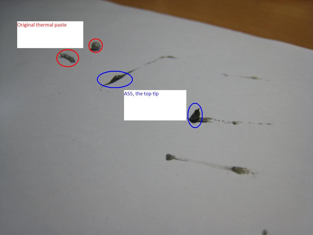

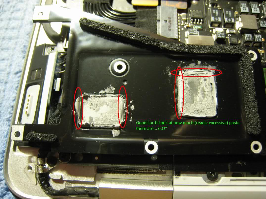

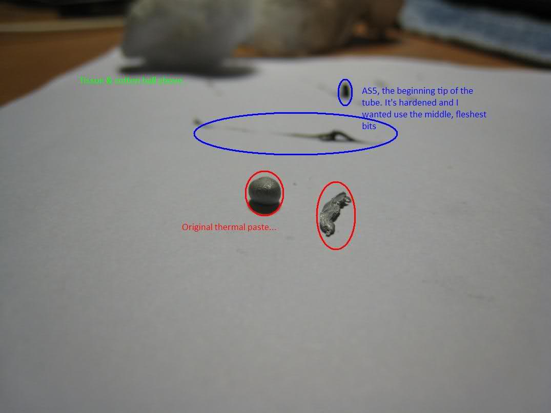

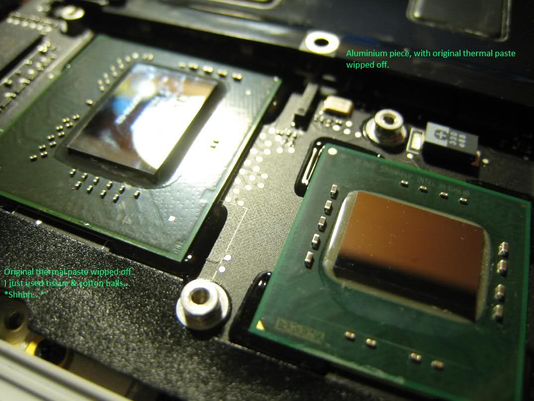

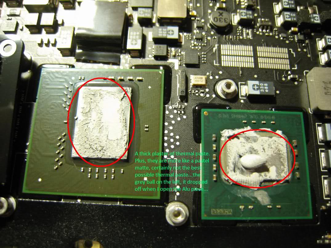

Having heard the general comments of AAPL's thermal paste,
I bought a tube of AS5 and did this quite a few months ago.

oh, and I used the blob method when I applied the AS5
for this reason:
I am sort of expecting the thermal paste will kind of 'melt' by the CPU/GPU heat and gradually spread across the die surface
(and in fact, it did! The photos in #1 only show my 1st attempt at re-applying AS5. I did re-reapply the AS5 a couple of times later on that week to get the thermal paste quantity right)
whereas in contrast, if the thermal paste is all spread out,
I kind of have a worry that there is always a chance of trapping a blanket of air in the middle when the heatsink is reinstalled onto the CPU/GPU
The reason that I think the blob method is better is, the paste spread itself across the die surface and so it should be pushing the air away while it spreads.
