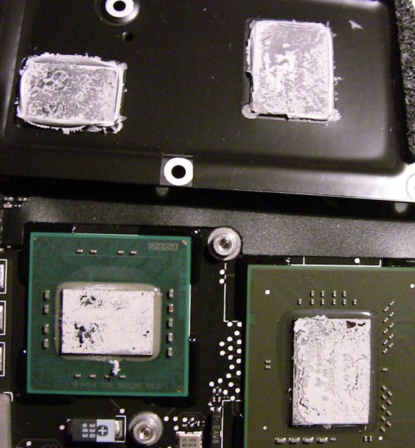

Anyone know if this is considered a neat and clean application from the factory or should I clean up and re-apply?

Now, the thermal paste application in the photo you attached compared to the photo I attached looks a bit sloppy. I would contact the OP of the sticky I posted and ask him about how he reapplied the thermal paste on his Rev A (he discussed this before) and get advice.

I hope this was directed toward ppl that own an MBA Rev B and have seen/applied the paste. I tried my best to answer your earlier question on why I'm posting this thread in the first place. Hope that clarifies what I'm looking for here.
Well, once you've cracked it open, I think you have to go ahead and replace it. You've broken the thermal bond between the heat sink -black metal piece- and the processors. The compound hardens between the two and once pulled apart, you almost have to replace it. First, do you have any Arctic Silver 5 or other quality heat sink compound? Other supplies: 91% isopropyl, wood handled cotton qtips, kimwipes or other lint free cleaning towels.

a little!? Man that's a real reply, thank you will try it out.
