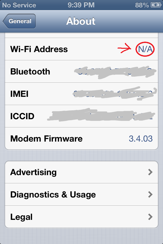

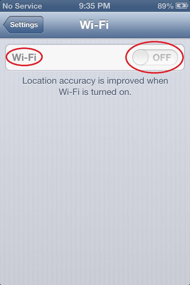

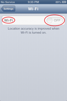

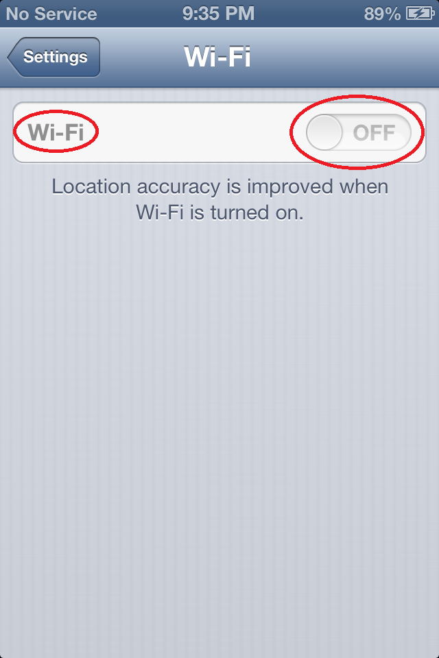

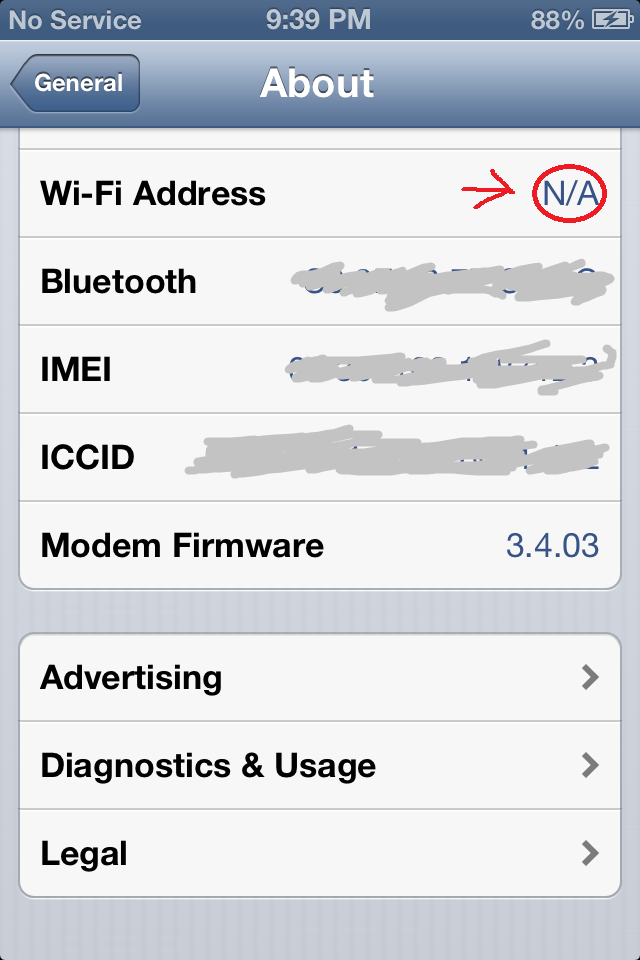

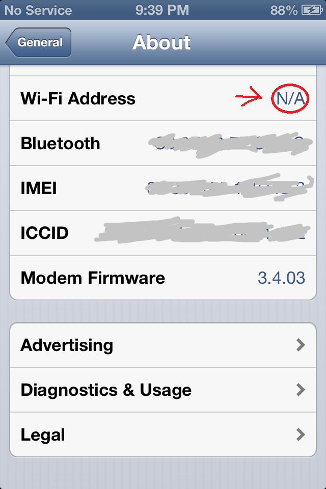

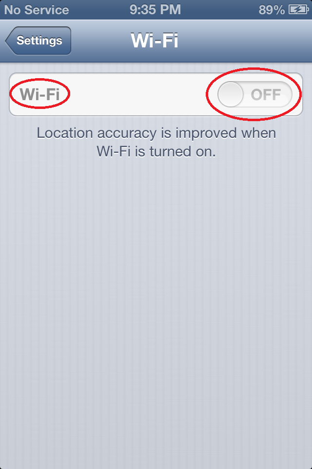

I found a way to reverse tether an i-Device to a Windows PC with ssh, without needing the second network interface provided by a cell network (so it could also work on an iPod Touch or iPad) I used an iPhone 4s with fried Wi-Fi and bluetooth.

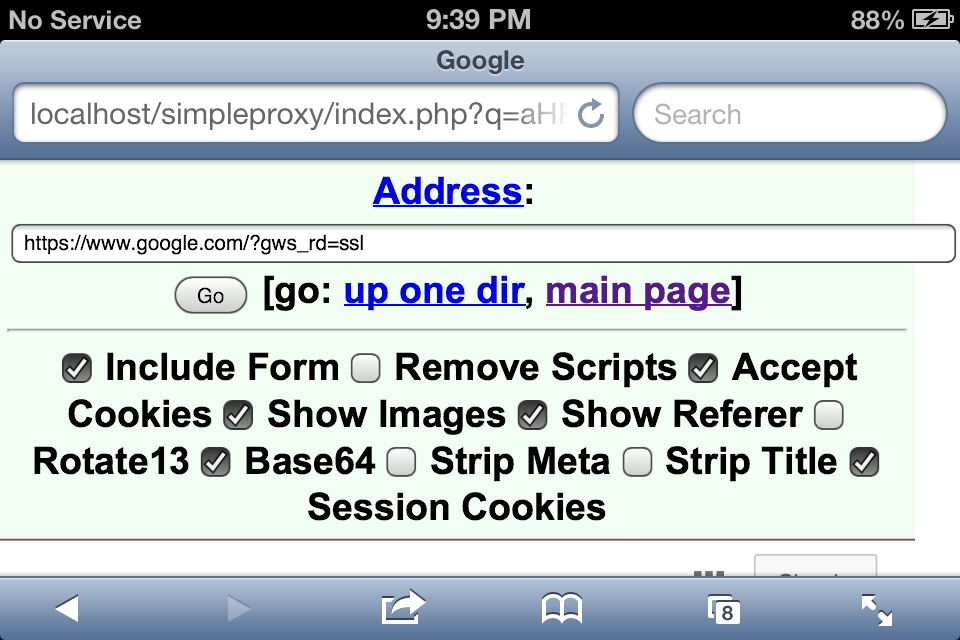

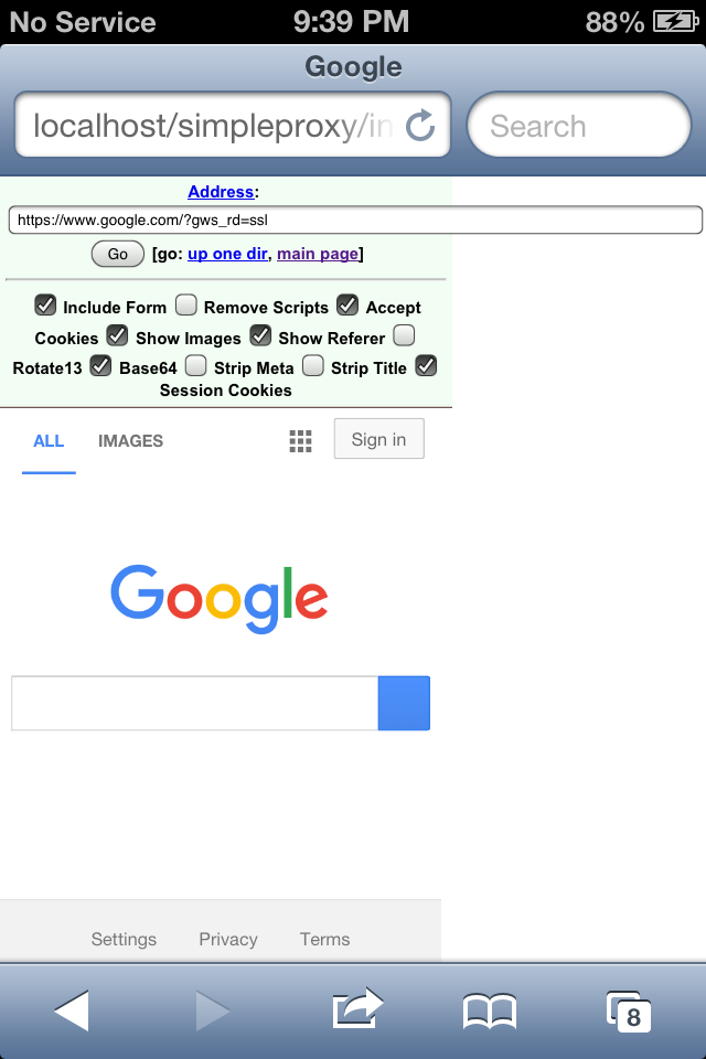

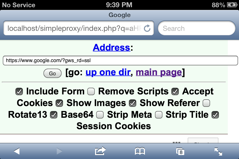

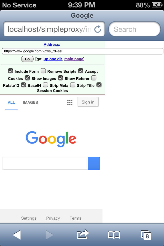

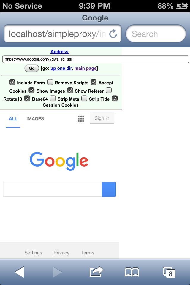

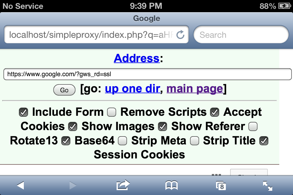

Step 4: Safari
in Safari, type localhost/the cgi or php file. (localhost:listen_port/the cgi or php file if changed)
It should load youf proxy! type and let it connect to the magical internet.
