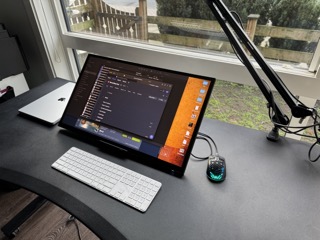

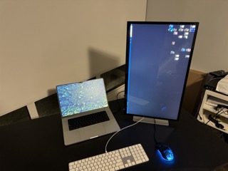

I had the 27" touch but ended up returning it. FYI the pictures show both the touch stand (extra charge) and the regular stand.
Pros
  • the regular (non-touch) stand is fantastic
  • the pencil will magnetically stick to the bottom of the screen
  • looks pretty stylish from the front
  • the pencil latency was much higher than the apple pencil, but quite usable
  • the on screen display/ controls were touch
  • picture in picture was a nice feature
  • bright display 350-400 nits (i work in front of a window)
  • touch stand brought monitor nice and low to the desk, but you have to be careful with the ports in the back getting bent
  • They often go on sale
  • free returns
  • chat support was good, but was inconsistently available
Cons
  • monitor wont charge your laptop when the monitor is off
  • the color was decent albeit a little "grey", but not nearly the same as my M1 Macbook Pro. I didn't try to calibrate
  • pencil was just a surface pro pen and wasn't nearly as good as the apple pencil
  • the pencil constantly had to be charged via USB
  • the painted plastic (to make it look like it's aluminum) on the rear of the monitor seemed cheap
  • more screen glare than apple products
  • the touch stand angled the monitor about 10 degrees clockwise, I think it was defective
  • I had weird USB disconnect issues which is the main reason why I returned it (didn't want to take the chance). This could have been a defective unit I'm not sure.
Hopefully this might help someone who is thinking of buying one. I feel Alogic is a good company and the monitors are an alternative to an Apple display and decent value but the Apple monitors are definitely better quality. These compromises might be ok with you when you consider the price difference.
