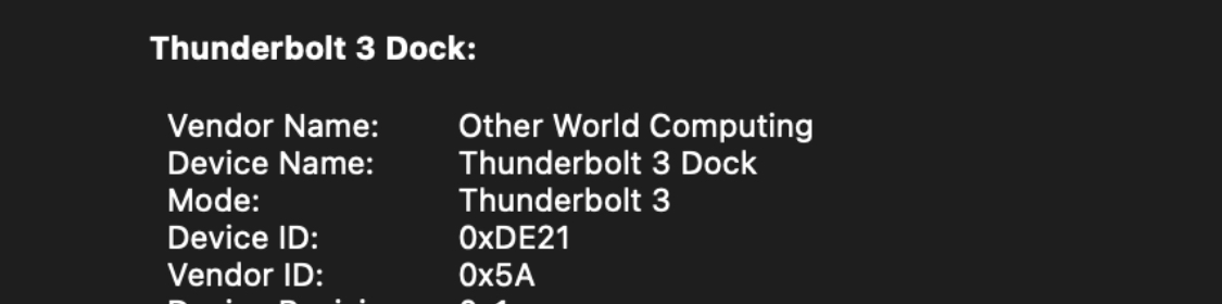

Shows well in thunderbolt 3 mode:

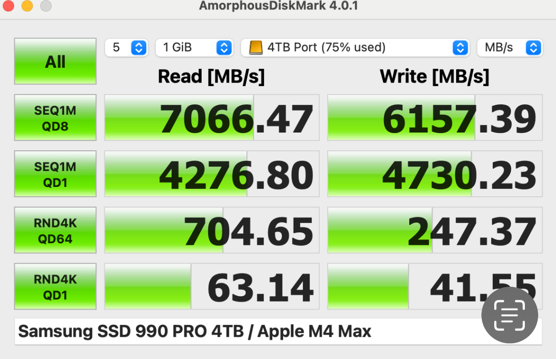

It’s noticeably faster than the dock’s built-in SSD slot, which shares bandwidth with other peripherals.
What do you do that makes it noticeable? I have an M4Pro Mac Mini with TB5 ports, but no TB5 peripherals and my 2 external SSDs are 10 Gbps USB-C.
Irrelevant: Thunderbolt 3 pre-dates the licensing of TB technology to the USB-IF, and used a proprietary Intel protocol for high-speed data with DP and PCIe tunnelling. Thunderbolt 3 devices run in "Thunderbolt 3" mode.

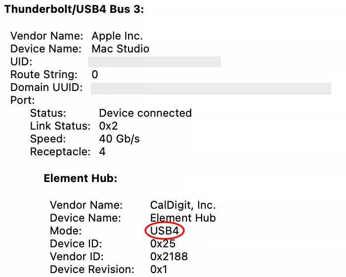

Mac Studio connected to Caldigit Elements TB4 hub:

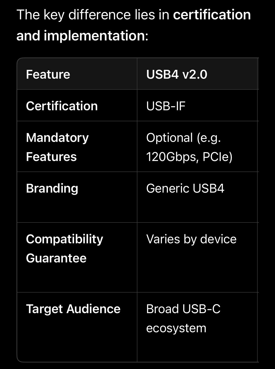

The key difference lies in certification and implementation:
Which is what I've been saying all along. I think you're cherry-picking my initial "USB4 v2 mode” is Thunderbolt 5" comment which could have been better expressed as "USB4 v2 modeis Thunderbolt 5 mode" but that was all in response to your post about what connection mode System Report shows, which will be USB4v2 for a TB5 connection because the proocols used by TB5 are all part of USB4. My original post did go on to elaborate on TB4/5 being about certification and minimum specs.
