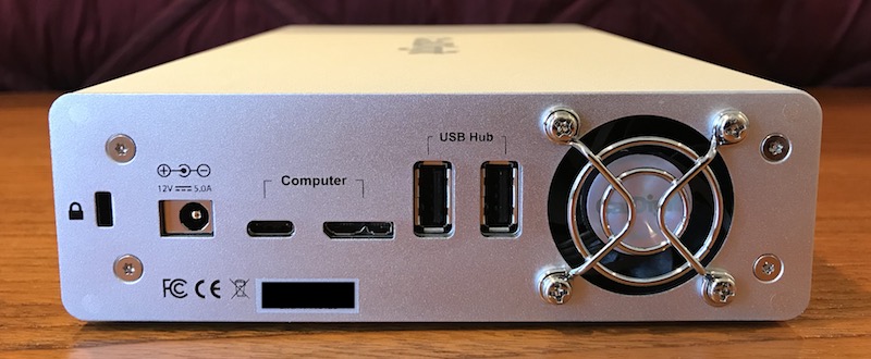

I was expecting it to cost more, considering what the other TB hubs cost. But then I noticed there are no ethernet or display ports, which suggests maybe it's not a Thunderbolt device, just a USB 3 hub?
Yep, from the article: "includes a USB-C port and a USB Micro B port, both on the 5 Gbps USB 3.1 Gen 1 standard". So no TB3. Thunderbolt would really be overkill for what they're trying to do here: data transfer from/to a single harddrive, not a RAID array or an SSD or anything. I have the feeling it would be best positioned as a TimeMachine drive.
But you could put an SSD in or have daisy-chained TB devices. If you use this, it uses up one of your ports. But yeah, it's great if your use case doesn't require more TB ports or high speeds.
Correct, it appears that single USB-C port is not ThunderBolt enabled, and sadly not even USB 3.1 Gen 2.

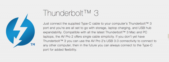

Check their comparison chart right above the specs. TB3 USB-C is labeled Yes
http://www.caldigit.com/USB-C-External-Hard-Drive-AVPro-2/#TechSpec
We'll need confirmation 😕
It is not Thunderbolt 3. It is compatible with Thunderbolt 3 connections because Thunderbolt 3 supports the USB-C standard. In the comparison chart, that's contrasting with some of the Thunderbolt 2 models from competitors.
With HDD models in particular, the 5 Gbps USB 3.1 Gen 1 connection isn't the limiting factor anyway.
They're very misleading with this section of the page...
Technically doesn't say that it _uses_ Thunderbolt, but I'll bet 99% of people won't realize that. It's an issue with other products too. Apple or Intel needs to release some official icon that indicates actual TB3 support since it's confusing with multiple protocols over one connector.
