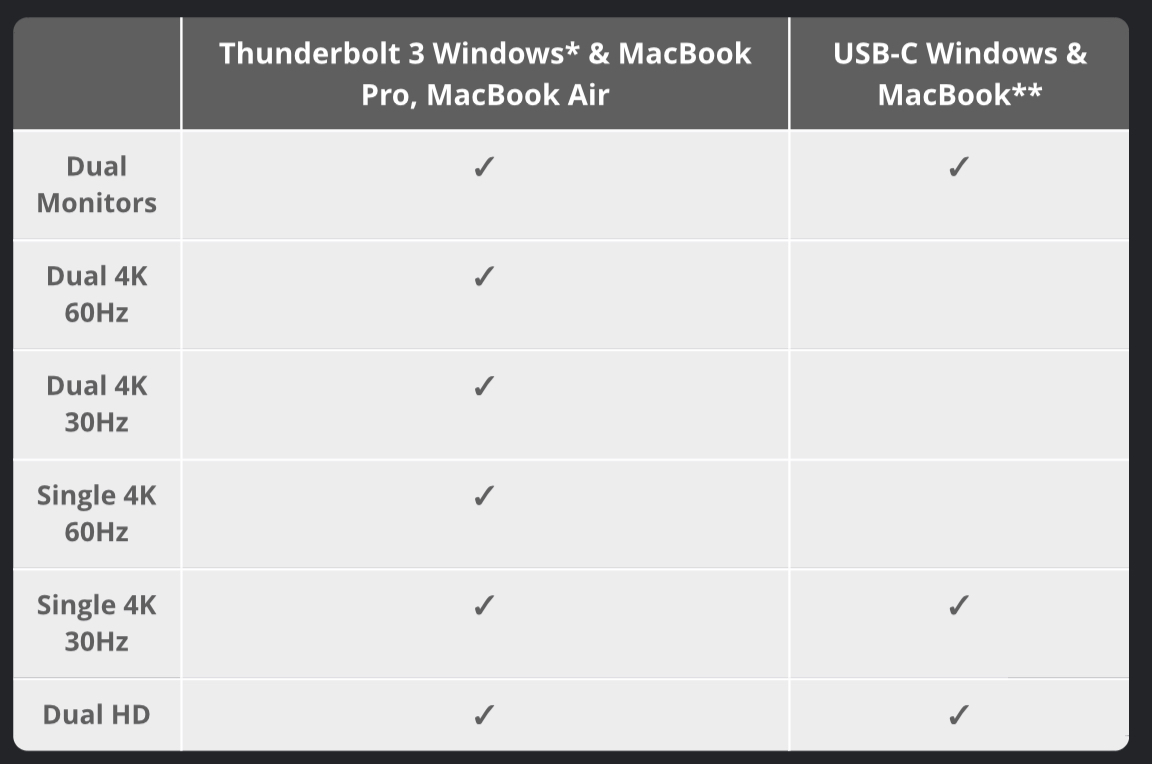

When it comes to display compatibility, the USB-C Pro Dock includes a pair of DisplayPort 1.2 connectors, and active adapters can be used to convert to other standards like HDMI. When connected to a Thunderbolt 3-equipped Mac like a MacBook Pro or recent MacBook Air, the USB-C Pro Dock is able to drive dual 4K monitors at up to 60Hz, offering great expansion capabilities for turning your notebook into a workhorse desktop machine.
Things are little more limited when you're connecting the dock to a MacBook over USB-C, as the slower connection maxes out at supporting a single 4K display at 30Hz or dual HD displays, although those dual displays are unfortunately limited to mirrored mode rather than allowing for a full extended desktop.
The lack of a downstream Thunderbolt 3 port means I likely won't be using this as my everyday dock, as I currently use a pair of LG UltraFine 5K displays, one connected through my TS3 Plus dock and one directly to my computer. I certainly could route both 5K displays directly to the MacBook Pro and use the dock separately for its other functions, but that increases the number of cables connected to my computer from two to three and so it's overall less convenient, particularly when I've already got a TS3 Plus serving my needs.
But for someone maxing out with one or two 4K displays, particularly DisplayPort ones where you won't need any adapters, the USB-C Pro Dock should work out just fine. In fact, CalDigit intentionally opted to sacrifice the downstream Thunderbolt 3 port in order to include two DisplayPort 1.2 ports, since most people end up using the Thunderbolt port to add another display anyway.

Can I have 2 displays via USB-C ? I mean NOT mirrored, rather 2 independent screen content?
(a) Not sure the iPad Pro supports 2 external displays at all
(b) @Krevnik left an important footnote off the chart - Macs don't support 2 independent displays over one DisplayPort connection - you just get mirroring - so really unlikely that the iPad supports it (Thunderbolt 3 provides 2 "virtual" DisplayPort connections)
Fair that I left off the footnote that Apple’s MST support doesn’t really exist (beyond driving a 5K/6K display).
That said, with this dock, it’s not going to work at all over USB-C, no matter how the port is wired up on the iPad.
Technically, USB-C/DisplayPort 1.2 alt mode can do dual standard res displays (bear in mind that's 1/4 the bandwidth of 4k) - but only on computers with full MST support. The chart you posted confirms that for PCs.
Yes, I was already aware of this. But my point is that Apple only supports MST in the sense of what’s required to funnel both 1.2/1.4 connections in a TB3 bus to a single port for the 5K/6K displays.
