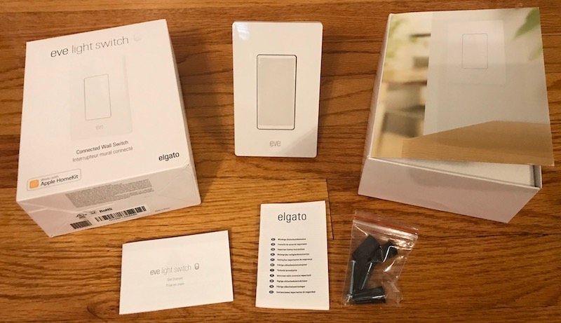

There are a number of HomeKit-compatible smart switches on the market, including one from iDevices that I looked at earlier this year. The Eve Light Switch was, however, the first entrant into this category late last year, and it remains a worthy competitor.
Installation and Setup
If you've ever swapped out a light switch, it's a pretty straightforward process, and installing the Eve Light Switch isn't much different. As always, make sure you turn off power at the circuit breaker for safety before getting inside the junction box.
The Eve Light Switch is a lot bulkier than a traditional switch in order to accommodate all of the electronics, so you'll need to make sure you have enough room in your junction box, and you'll also need to have a neutral wire present at the switch location in order to provide continuous power to the switch. If you don't have one, you'll have to run some new wiring to the switch (which may not be a do-it-yourself job) or else select another location.
Unlike the iDevices Wall Switch, the Eve Light Switch can only be used in single-pole configurations. So if you've got a three-way circuit where a single light is controlled from two different switches, for example, you won't be able to use the Eve Light Switch.
Once you've determined the switch you want to replace is an appropriate location for the Eve Light Switch, it's just a matter or removing the old switch, transferring the wires over to the Eve Light Switch using the included wire nuts, shoving everything back into the wall, and screwing it all together.

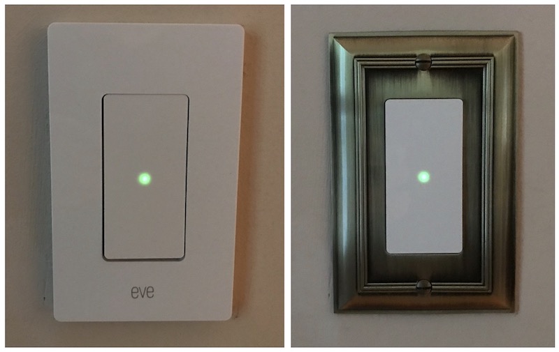

Included snap-on plate (left) vs. standard wall plate purchased separately (right)
From there, you have a decision to make. Elgato includes a two-piece face plate for a clean look, which requires that you screw on a snap plate over the switch and then snap on the face plate. Alternatively, you can skip those two pieces and put your own face plate on. Metal face plates may decrease the Bluetooth range of the switch, but I haven't experienced any issues with mine.

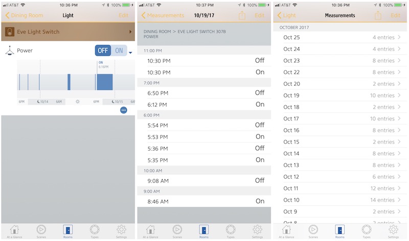

The Eve app keeps a log of events such as when the light switch is turned on and off, which you can view in graph or table form. The various rules and scenes also make it easy to set up products to work together in scenarios such as activating multiple products at once or using an event on one accessory to automatically trigger a change in the state of another one.

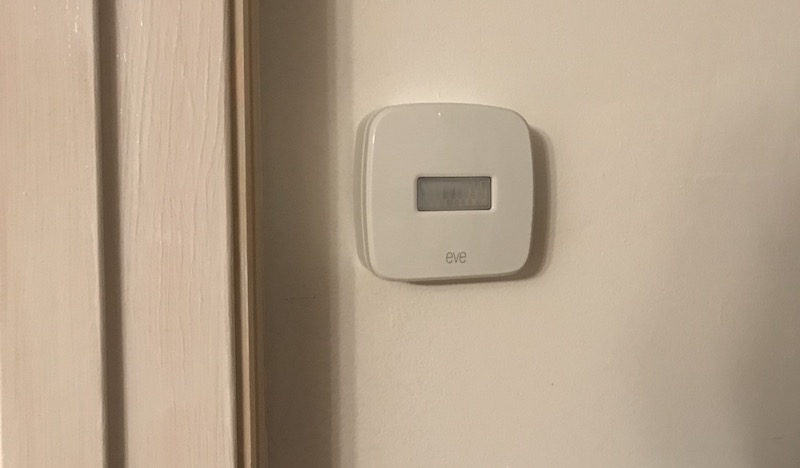

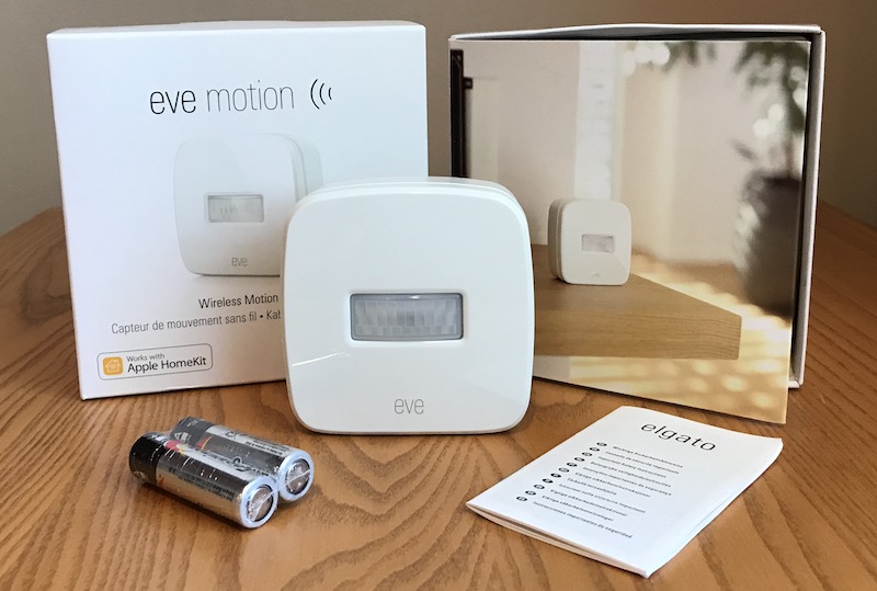

The Eve Motion is a simple product designed to do only one thing: sense motion in a room. Its 120º field of view and 30-foot detection range help it recognize whenever someone enters a room, and the fact that it's powered by a pair of AA batteries means you can put it almost anywhere. The Eve Motion is also IPX3 water resistant, meaning it can withstand splashes and sprays, and with an operating temperature range of 0º to 130º F, it can be used outdoors as well as inside.

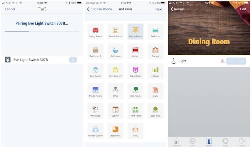

Setup is straightforward, and once you insert the batteries and set the Eve Motion in an appropriate location, the Eve app walks you through step-by-step to allow you to pair with the Eve Motion, set sensitivity for the motion sensing, and set a Siri name for the sensor. If you'd like to integrate with other Eve or HomeKit products, you can set up scenes by specifying triggers and conditions.
As with the Eve Light Switch, the Eve Motion connects to your iOS device over Bluetooth, and if you have an Apple TV or iPad set up as a HomeKit hub, it'll be able to integrate with all of your other smart home devices at all times.

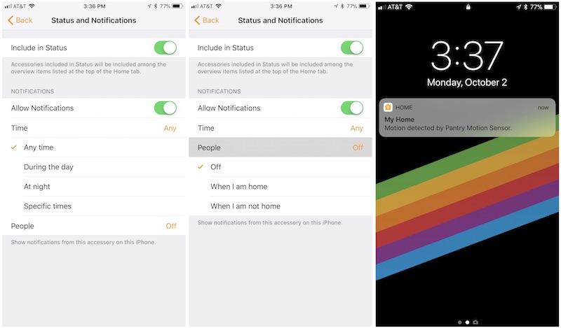

On its own, the Eve Motion is rather limited, basically restricted to pushing notifications whenever motion is sensed. This can come in handy if you want to mount it on your front porch, inside your front door, or in a seldom-used room if you want to be alerted whenever anyone's presence is detected. Within the HomeKit ecosystem, you can restrict notifications to only certain times of the day or, using geofencing, to only times when you either are or are not home.
Notification preferences in Home app for Eve Motion

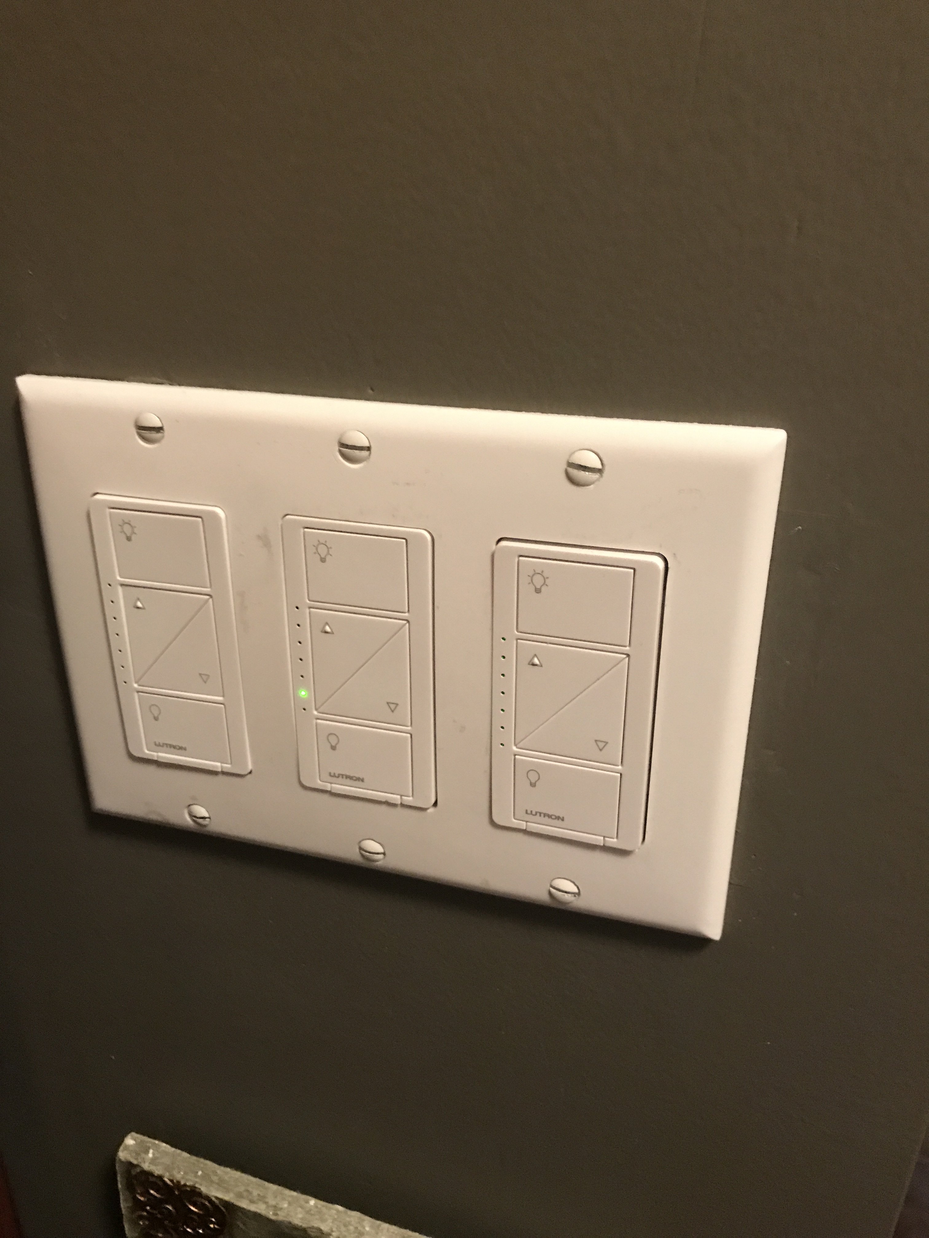

I am not an electrician, but yes those wires bundled in the back where neutral. I have no idea why it didn’t work for you.

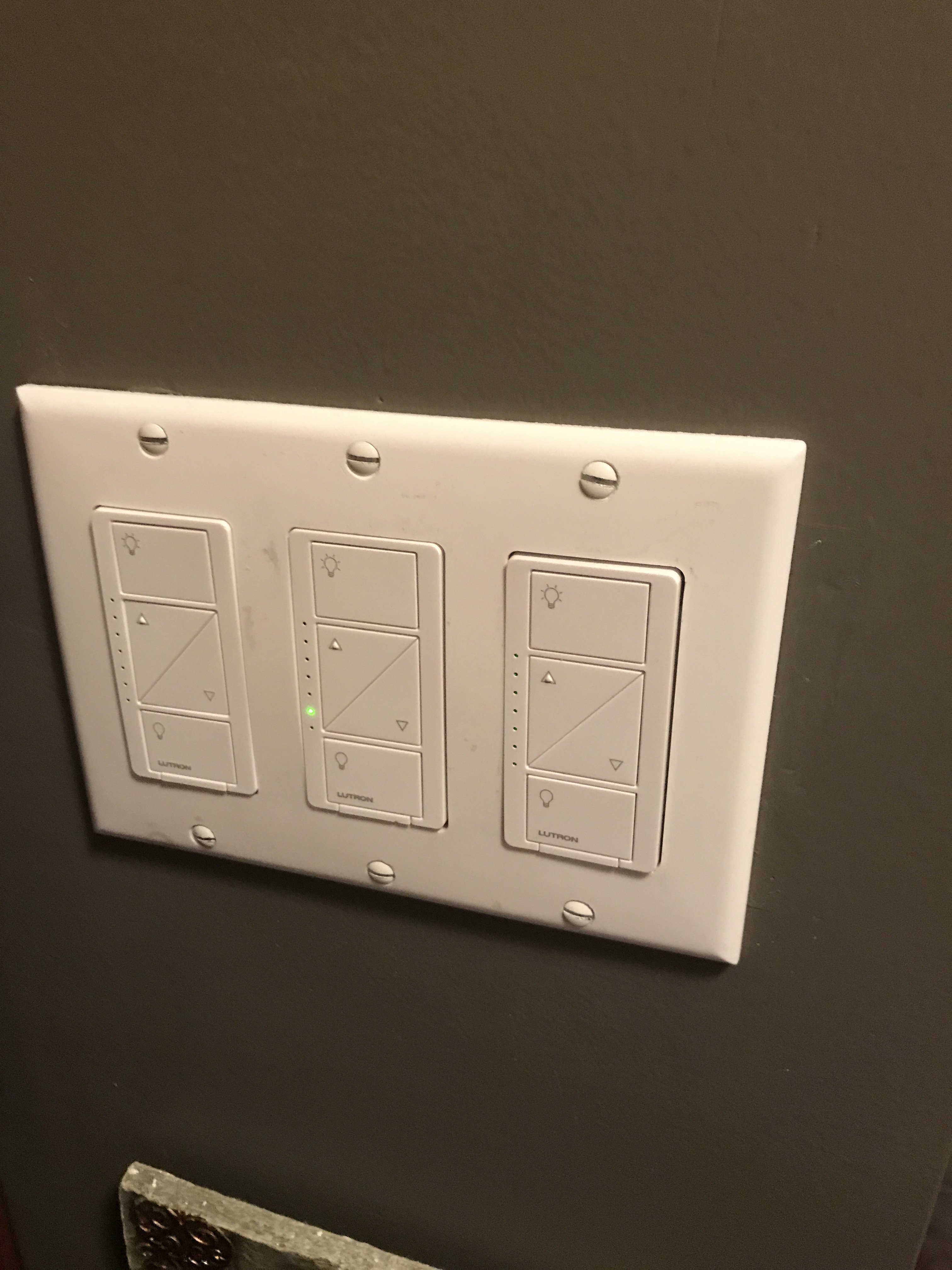

I had a similar level of frustration with the wemo dimmer I tried to install at my house. This is why I gave up and switched to lutron. No hassles. 3 wire install like a normal switch.
Here are 3 lutron switches I installed side by side in my kitchen:
