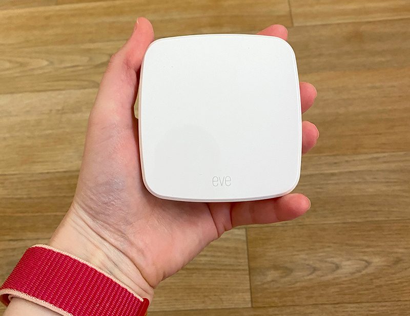

Eve Extend is a small square-shaped white plastic box that can be placed in a central location in the home to add WiFi connectivity to Bluetooth-enabled Eve accessories, allowing them to be controlled from anywhere. You can also use multiple Eve Extend boxes if a home is particularly large.

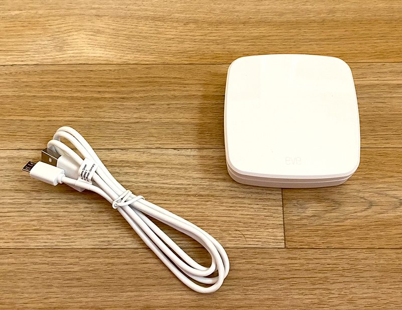

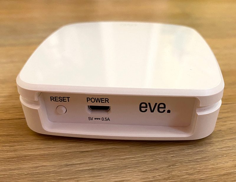

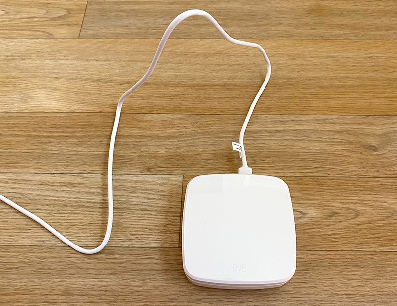

The Eve Extend needs constant power to work, and it comes with a micro-USB cable and a power adapter. I wasn't much of a fan of the Eve Extend's cord and I would have preferred a built-in plug for the device.
Since Eve Extend uses a cord and power adapter (I just plugged it into an iPad adapter), it can go anywhere in the house that it needs to go. If, for example, you have an outdoor Eve product that's often out of range such as the Eve Aqua, you can put the Eve Extend close to the outdoors, improving connectivity.

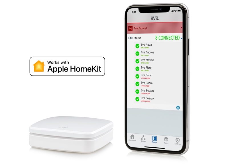

The Eve Extend is simple to set up, connecting to either a 2.4 or 5GHz WiFi network. Like other HomeKit products, it can be added to your setup by scanning the HomeKit QR code with your iPhone.
I didn't have issues setting up the Eve Extend, but I did come across some reviews from people who haven't been able to use it with Google WiFi systems, so there may be some setup problems that should be investigated prior to purchase.

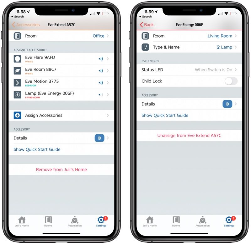

The Eve Extend runs in the background so there's no need to control it, and it's not available in the Home app. You can access it in the Eve app, which also needs to be downloaded to set it up.
In the Eve app, you can see the accessories that are connected to the device and also add additional Eve accessories that you purchase after setting up the Eve Extend. Other than setting it up and assigning accessories, once something is connected to the Eve Extend, nothing else needs to be done.

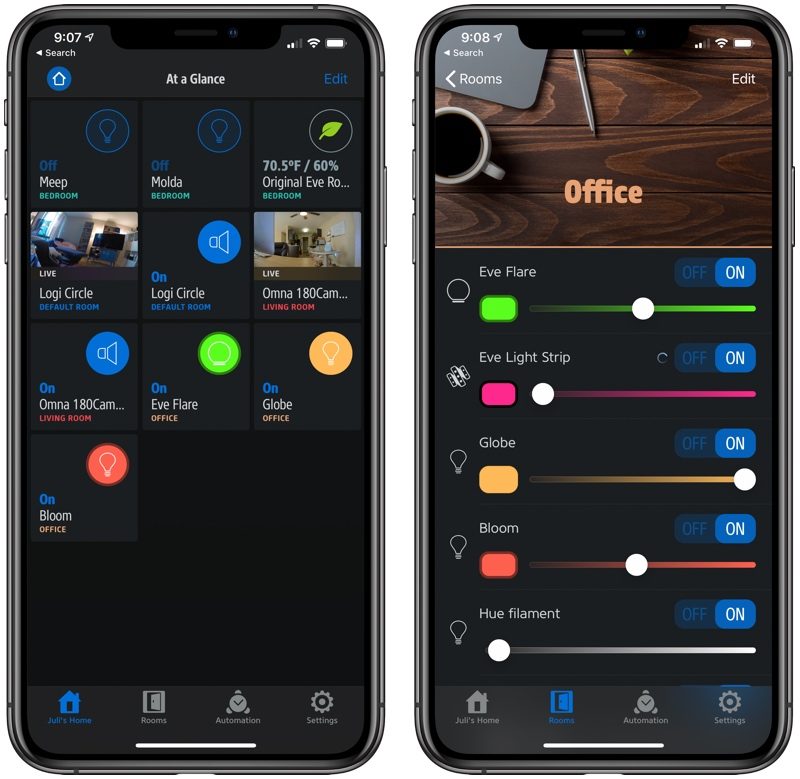

Eve has always had one of the more comprehensive HomeKit apps on the market, and the app was recently improved following the launch of iOS 13. There's Dark Mode support and a redesigned navigation bar that makes it easier to get to all of your favorite devices. Eve's app is my go to for seeing all of my HomeKit products at a glance, even those that aren't Eve devices.
Eve Extend can connect to up to eight devices, and in my testing, it successfully extended the available Bluetooth range of each Bluetooth Eve accessory. I don't have a super large home and the Eve products I have are concentrated in my office, but to test it out I moved them to other areas of the house that are further away.
