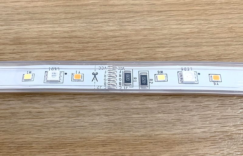

What is the connection between the control module and the lightstrip? Philips Hue lights used to support a ribbon style cable. The current variant removed the ribbon cable for a hard wired connection.
If the reviewed light has a ribbon style connector, that is great because you can then purchase extension ribbon cable to keep the control module remote, accessible and out of the way.
On my Hue lightstrips I use ribbon extensions to install the light strips in aluminum rails under upper kitchen cabinets and in floor toe kick areas.
This could be a great replacement for the Hue lightstrip since Philips changed the connector.
There's a ribbon connection between the end of the Light Strip and the little white power module. The white end of the Light Strip plugs into it. My Hue Lightstrip Plus uses the same kind of connection between light strip and power brick, though, so I wonder when that change was made. Here's a pic of the connection between light strip and box:
