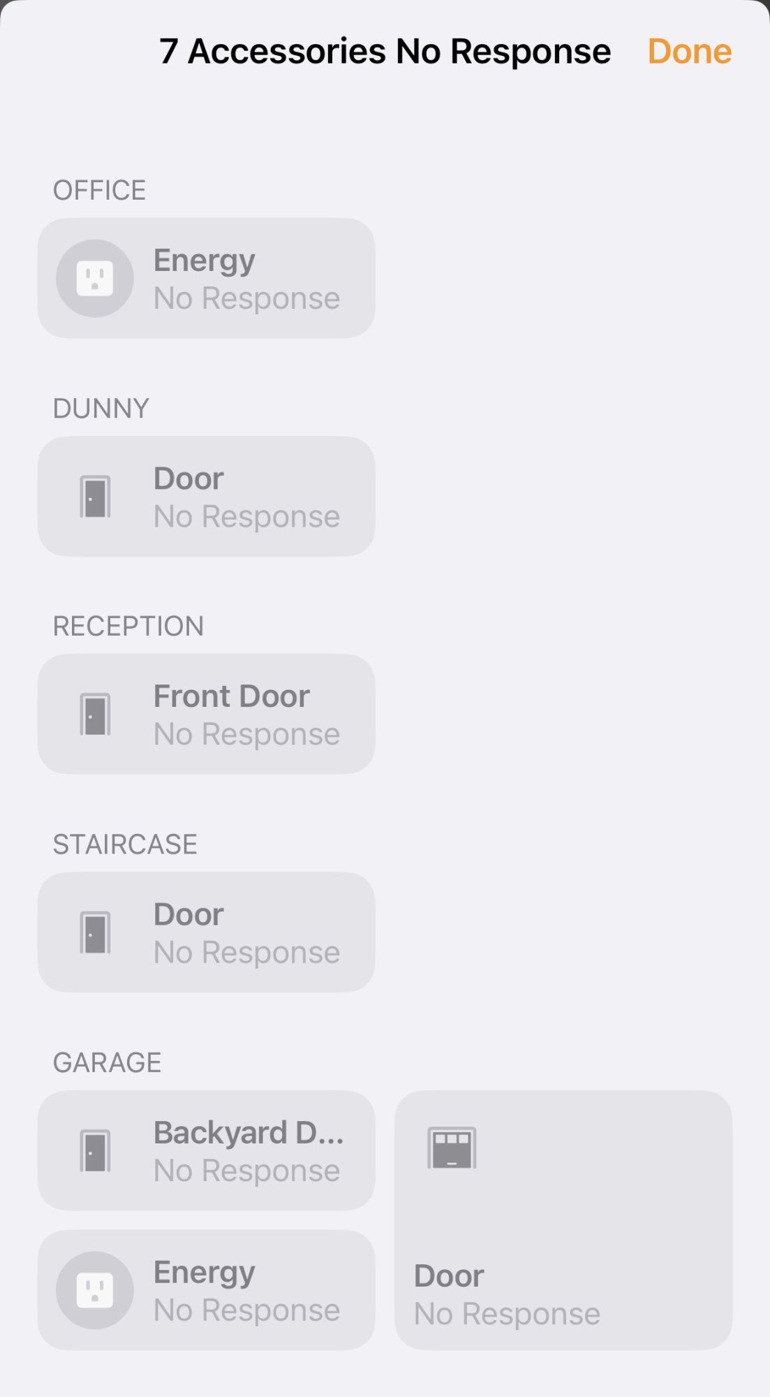

Advice regarding upgraded firmware to incorporate Matter is DON’T!
Had nothing but connectivity issues and “No Response” from all Eve devices since the upgrade and doesn’t appear that 16.3 has fixed the issue either

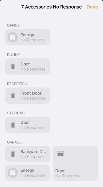

Totally concur with this 👆to anyone reading this article contemplating “upgrading” their eve to Matter for use on HomeKit, DONT DO IT.
i upgraded 6 eve energys, they randomly drop from HomeKit entirely after a day or so and only full factory reset fixes it. In fact one of them wont even work with a factory reset so currently it’s just a dumb switch. 😤
