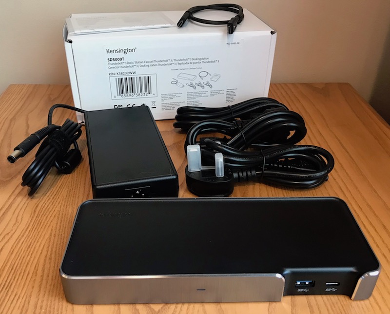

The dock arrived in a plain white box with a product label on it, which Kensington tells me is the B2B packaging. Retail units will obviously have fancier packaging.
Inside the box was the dock itself, a large power brick identical to ones used by many of the other Thunderbolt 3 docks, and a 0.5-meter Thunderbolt 3 cable. Kensington also includes three separate power cables with compatibility for the major US, UK, and mainland European standards.

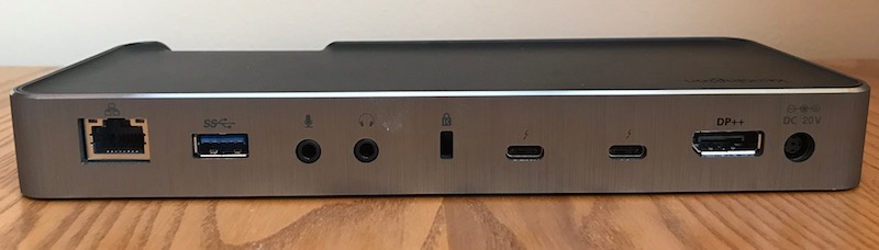

The SD5000T is fairly attractive, constructed primarily of matte black plastic with a band of brushed aluminum with chamfered top edges around all four sides of the dock except for the two front USB ports. The gap in the aluminum band around the USB ports provides a bit of visual interest without being overly distracting.
Kensington's dock has a horizontal design very similar to most other Thunderbolt 3 docks on the market, measuring about 8.5 inches wide by about 3.35 inches deep by just about an inch high and weighing just over three quarters of a pound. A small Kensington word mark is molded into the plastic on the top left rear corner of the dock, but it's a subtle inclusion that doesn't distractingly stand out like the branding on some other docks.

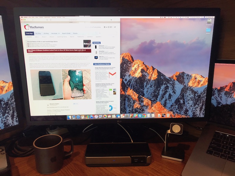

Setup is a breeze, requiring the power brick be plugged in and connected to the dock and the Thunderbolt cable connected from one of the ports on the back of the dock to the computer. Any other cables for peripherals and displays are easily connected to the dock. When the dock is powered on, a subtle blue light shines on the front to indicate its status. The SD5000T supports a full 85 watts of charging over Thunderbolt 3, so it can power even a 15-inch MacBook Pro over the same cable used to pass data and video.
I own a number of displays, most of which are VESA-compatible, but none of them will work with Kensington's Zero Footprint Mounting solution, and that's the problem with this feature. All of my VESA displays require that you remove the foot from the display and attach a separate backplate that includes the VESA mounting holes.
If you use these displays sitting on a desk as I and many other people do, you can't also mount Kensington's dock on the back of the display. There are, however, some displays on the market that do include accessible VESA mounting holes even with the display's foot attached, so if you have one of those monitors this would be a great way to get the dock off of your desk.
As with the other Thunderbolt 3 docks I've looked at, I tested Kensington's dock with a 2016 MacBook Pro and a pair of LG UltraFine 5K displays over Thunderbolt 3, one connected via the dock and the other hooked up directly to the MacBook Pro. The display connected via the SD5000T worked just fine, utilizing its full 5K Retina resolution at 60 Hz. Alternatively, you can connect a pair of 4K displays to the dock, one over Thunderbolt 3/USB-C and one over DisplayPort. Other standards like HDMI and VGA can also be used with appropriate DisplayPort adapters.

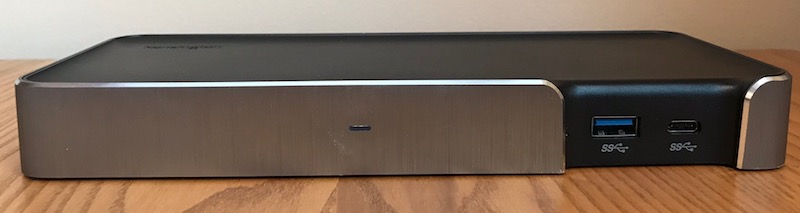

The SD5000T includes a trio of USB ports running at 5 Gbps, one Type-A and one Type-C on the front and one Type-A on the rear. It's a pretty typical number of USB ports for docks like this and a Type-C option is a nice inclusion, but I still wish Kensington and other manufacturers would match OWC's five USB ports for maximum flexibility.

Other ports on the rear of the dock include Gigabit Ethernet and separate 3.5 mm audio in and out ports. Kensington's famous lock slot is also included, and while it's not really necessary in my home office, institutional customers will no doubt appreciate the added security.
