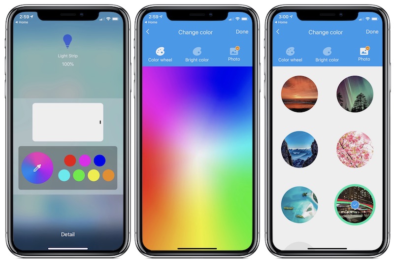

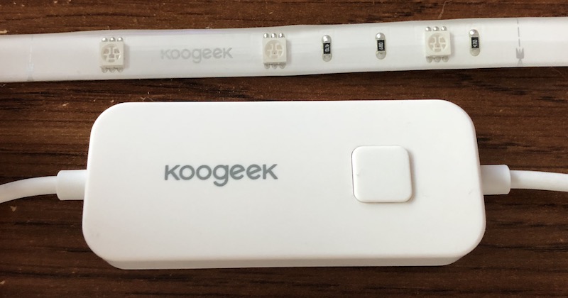

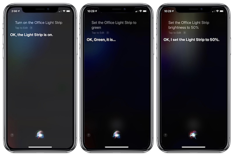

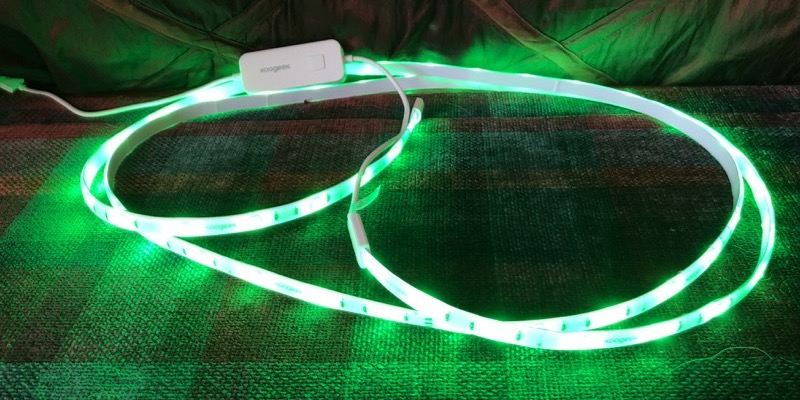

I got the light strip a month or so ago and have noticed several issues. Although it is quite cheap, it works great in homekit (0 issues communication and setup) and is colorful, but with several downsides. For me the adhesive was not strong enough to adhere to the back of my tv stand with the weight of the controller pulling down to be plugged in. As mentioned above, this does not include a 10W power supply. A 5W (iphone) will turn it on, but will result in flickering, unfortunately. Another downside is the length from end of lights to plugin is really short. need to have a USB extension in many cases or extension for power supply. Another issue was the color accuracy when using homekit. I would pick red, for instance, using the color wheel, but it would show up pink. Only when I asked Siri to do "red" would it be a true red. Any slight deviation would turn pink (compared to philips hue bulbs which maintain deep red colors). I also noticed a slight deviation in color between the individual LEDs. Not being extendable is not an issue for me, but would like one that could bend corners. I have it set up and working great with homekit, but make sure to use Siri or predefined "good" colors. I will keep it, but won't get another one until it's a little better.

Koogeek makes some solid products for the money but their lighting sucks. I had the first homekit bulb they made and the colors were so blah. You could never get a truly orange or pinkish orange hue out of it. It always looked washed out and green. Sadly this light strip is the same. I got it for over my desk so I don't really care and im plugging it right into my iMac so it lights up the shelves behind it. works for that situation. for my other rooms thought I stuck to Life or even Sylvania. MUCH better colors!

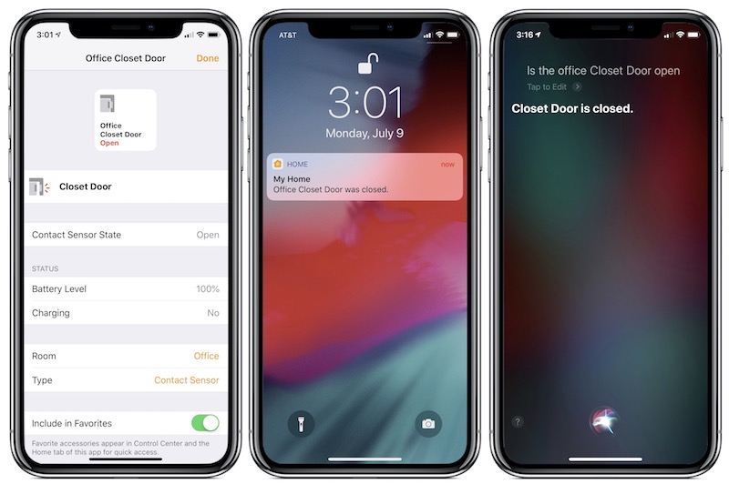

I like the idea of an automation to turn a light on when a door is opened, but can you be more granular with the settings and only have a light come on after a certain time (ie, 15 mins before sunset) when the door is opened?

Roughly one-third the price of the Hue LightStrip+ for roughly one-third the output isn't much of a bargain, especially given that they don't supply proper power. USB-powered is a cute idea, but 5W is the spec for power from USB, if I recall correctly, and selling a lighting system with the proviso of, "well, just don't tell it to go full brightness", seems absurd.

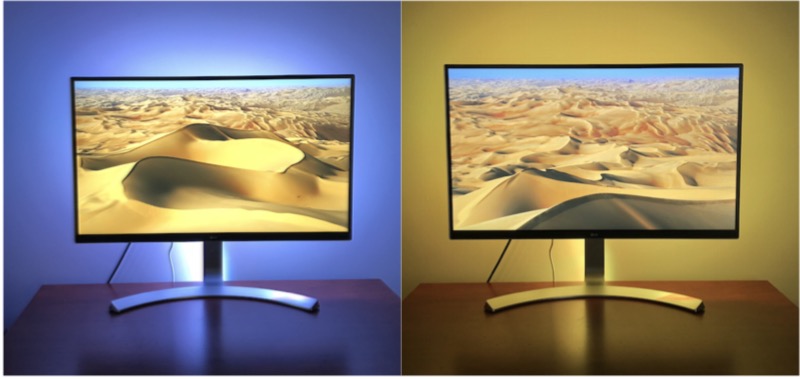

BTW, when putting a light strip on the back of a TV, you can avoid all those pesky problems of limitations in bending angles, by simply putting the strip on its side - the strips already ship coiled up, just uncoil it somewhat, carefully zip-tie the resulting spiral to a sheet of cardboard, with all the LEDs facing out from the center, and attach the assembly to the back of the TV (making sure to cut holes in the cardboard matching the vents on the back of the TV to allow proper airflow). You'll get more even lighting, too, without that funny strip following the back of the stand.

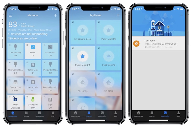

As a Chinese company, Koogeek suffers from the somewhat common problem of awfully translated software. The UI in their app is very poorly translated with some bizarre UI design choices with their dialogs. Honestly that made me very skeptical about installing their remote-controllable hardware in my home, in fear of the same standard of quality in their “security” model.

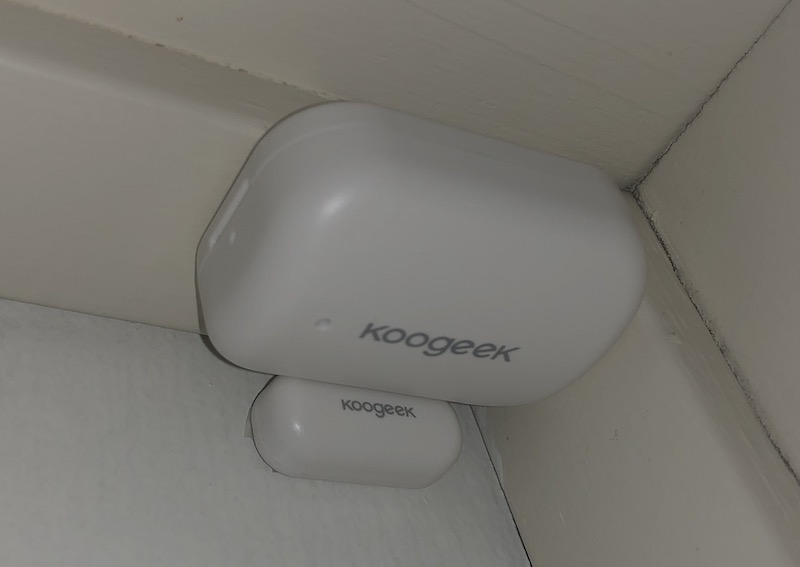

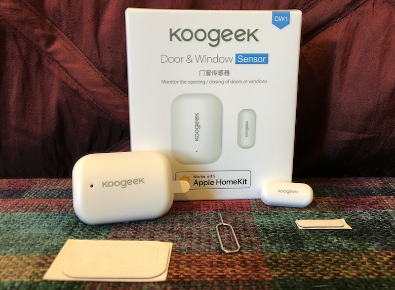

old thread - i bought a koogeek window/door sensor so i could check if the garage door is closed from inside the house. turns out the bluetooth connection is so weak that despite being just about 5 feet above the sensor, my phone can not see the sensor from my bedroom. in fact, the only place the phone can see the D/W sensor is from inside the garage, which makes having one of these pretty pointless for me.
following up - i set up an ipad as a homekit hub. i unpaired the koogeek from my phone and paired it to the ipad and left it in the garage. i also turned on notifications for that door on my phone.
whenever the door was opened or closed, i'd sometimes get a notification, but if i tried to check the status of the door, most of the time i'd get "not responding" from the sensor. at first i thought maybe the sensor itself was going to sleep when the door was in the same state for a long time, however, i think what was happening was since the ipad was not plugged in, it's own wifi would go to sleep periodically. i plugged the ipad in and since then i'm consistently getting notifications and the sensor seems to be available anytime i check the status.
i'm thinking of replacing the ipad with an old appletv though, we'll see how that goes.
