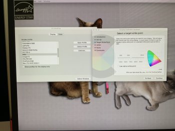

Answers to the reviewers - using a MBP closed so not having to see the difference in screens is not an option for artists or photographers. What you want is accurate color no matter what you are looking at. If you are keeping the monitor, try using a different color profile and changing the white point to reduce the yellow.
