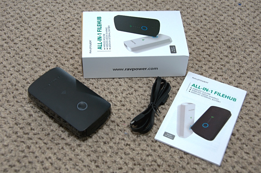

So what exactly is a FileHub? In short, this is a device that serves up the content from a USB drive or SD card via a personal Wifi hotspot. I have the first version of the Filehub from RAVPower but this new model differs in functionality in that it also includes an Ethernet port that can turn a wired connection into a Wi-Fi access point. It also has twice the battery capacity and twice the amount of anything is usually a good thing!
Included in the box is the unit itself, a micro usb charging cable and user guide. There is no charger included but since any USB charger or port can be used as a power source to charge the internal battery, this is no great hardship.
This unit is a different design and layout from the first generation however the build quality and portability remain as I would expect. It is well finished and feels very sturdy indeed, no doubt enhanced by the fact the majority of internal space is filled by the lithium polymer battery. While no case is included in the package, I can see this device standing up to regular but careful use.
This measures in at 98 x 53 x 28 mm and weighs 155g. On the top you have four LEDs indicating battery charge and a further LED for WiFi status. The illuminated power button is also located on the top with a reset button and micro USB port for charging on one side. One end hosts Ethernet and USB ports under a protective rubber cover while the opposite features a full sized SD slot which supports SD, SDHC & SDXC cards.
Yes, it is roughly twice as thick but the other dimensions are smaller. It also have twice the battery capacity.
