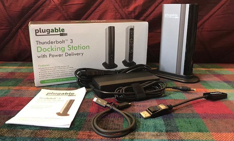

In the box, you'll find the typical components including the dock itself, an external power brick, and a 0.5-meter Thunderbolt 3 cable. One nice touch I haven't seen with other docks is an included DisplayPort to HDMI 2.0 active adapter, normally sold separately for $19, which makes it easier to hook up a broader array of displays, televisions, and projectors to the dock.

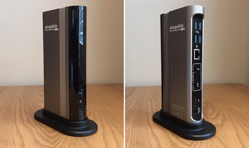

Notably, the TBT3-UDV can be oriented either horizontally like most other Thunderbolt 3 docks or vertically using an included stand. It's a nice feature that the dock has in common with CalDigit's TS3, but differences in their designs mean the Plugable dock is taller and more slender in its vertical orientation compared to the TS3's block-like design.
Design
While it might have an awful name, the design of the TBT3-UDV stands out on a desk, particularly in its vertical orientation. The enclosure is constructed of a matte aluminum that's fairly close to Apple's Space Gray color and which has a few deep grooves on each side to add some style. The curved front edge of the dock is made of a glossy black plastic, as is the rear port panel.
There are somewhat prominent white Plugable logos on each side, as well as some model and regulatory information near the bottom of one of the sides. A bit cleaner look would have been nicer, especially considering the eye-catching hardware design, but it's not terrible. A pair of status lights, green for power and blue for data connection to a computer, are hidden beneath the black plastic on the front edge of the dock.

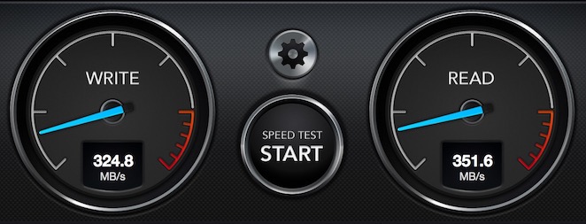

SSD speeds connected to USB-A port
All five ports are 5 Gbps USB 3.0/3.1 Gen 1, so you'll get solid transfer speeds like the 325 MB/s write and 350 MB/s read I saw with a fast external SSD, typical for these types of docks. If you want even more speed, you'll have to use the available Thunderbolt 3/USB-C port on the rear for 10 Gbps USB 3.1 Gen 2 support, which clocked in at 470 MB/s write and 495 MB/s read with the external SSD.

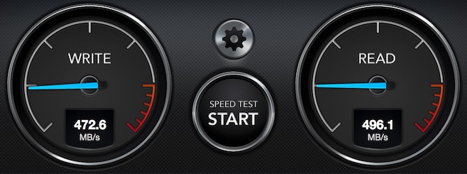

SSD speeds connected to Thunderbolt 3/USB-C port

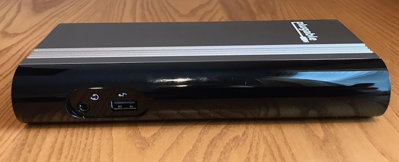

Unfortunately, the four USB ports on the rear of the dock are clustered very closely together. It helps keep the overall dock footprint compact, but it means if you have oversized USB peripherals like card readers or certain flash drives plugged into the back, they will likely block access to some of the other USB ports.

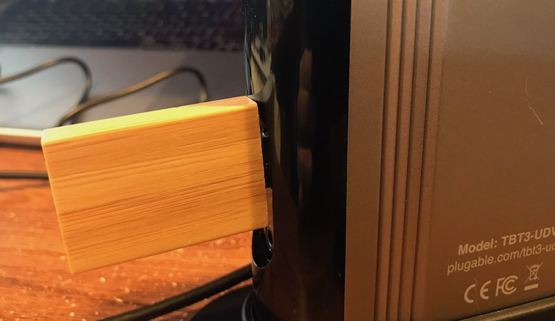

Ill-fitting oversized flash drive in front USB port
I also have one fairly wide flash drive that won't even plug into the front USB port because of the recessed design. It doesn't really even fit in the two rear USB ports closest to the edge of the dock, although I can insert it just far enough to make a connection. This might not be a deal breaker if you're mostly connecting USB cables and skinny sticks, but it's something to be aware of.

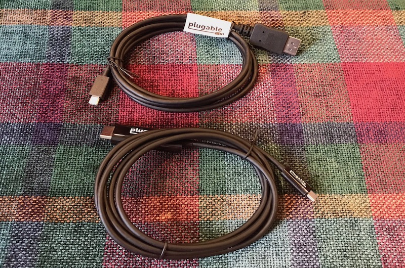

In addition to the DisplayPort to HDMI 2.0 cable included in the box with the dock, Plugable also sent me two of the company's USB-C cables: the USB-C to DisplayPort and USB-C to HDMI 2.0 cables that have proven popular with customers on Amazon for their quality and pricing (currently $21.95 each).
Plugable's USB-C to DisplayPort (top) and USB-C to HDMI 2.0 (bottom) cables
The cables, which it's important to emphasize are sold separately and not included with the TBT3-UDV dock, expand the number of display options for use with the dock, and can also be used on a standalone basis with USB-C Macs to connect to external displays that don't directly support USB-C.
OK, so unless that particular flash drive has some insane capacity I'd be inclined to go mediaeval on it with a hammer - but that recessed socket looks like it would be a problem even with less ridiculous devices. What on earth are designer thinking when they do this sort of thing? I can see that the arrangement of ports on the back is a cost-cutting thing to save circuit board space by using double-decker sockets (the sort you typically get on the back of PC motherboards) but all the more reason not to put a stupid moulding around the one isolated port...
