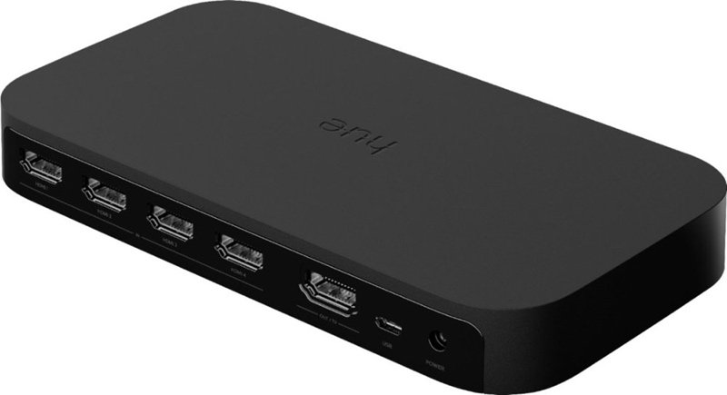

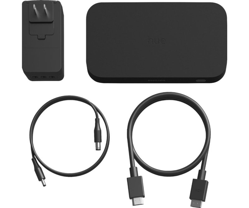

The Hue Play Sync Box is a simple black box that plugs into a TV with an HDMI cable. It has a power port (and an included power supply) along with four HDMI ports that are designed to accommodate HDMI devices like Apple TV, Nintendo Switch, PS4, and more. It's just a black box, and nothing special to look at, because it's meant to be tucked away on an entertainment unit.
Any console or set-top box can be plugged into the Hue Play Sync Box, allowing it to analyze the colors and tune them to a Hue light setup, shifting colors and brightness to match the content on the TV screen. The box is basically passing video signal to the TV while also detecting the colors.

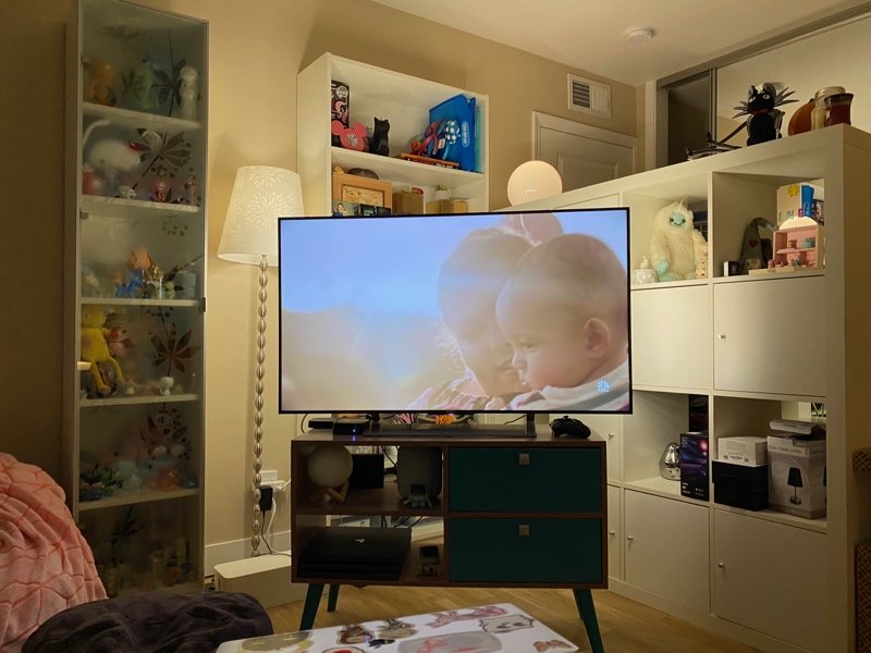

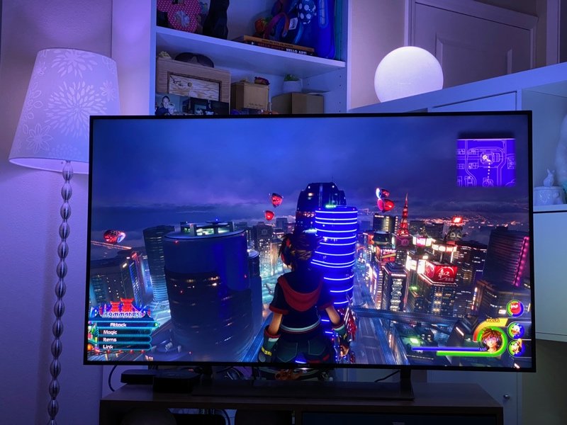

There are three different sync modes for video, music, and games, along with three intensity levels: Subtle, Moderate, High, and Extreme. Subtle and moderate are the smoothest with fewer transitions that are ultimately less distracting. In High and Extreme modes, the colors change rapidly and it can be a bit distracting depending on what you're watching.
In general, I preferred to watch with the settings on Subtle for regular usage because the other settings were just too much shifting between colors. For a few colorful films I did experiment with the High and Extreme modes and it can make a movie more fun, but these aren't settings I'd want to use all the time.

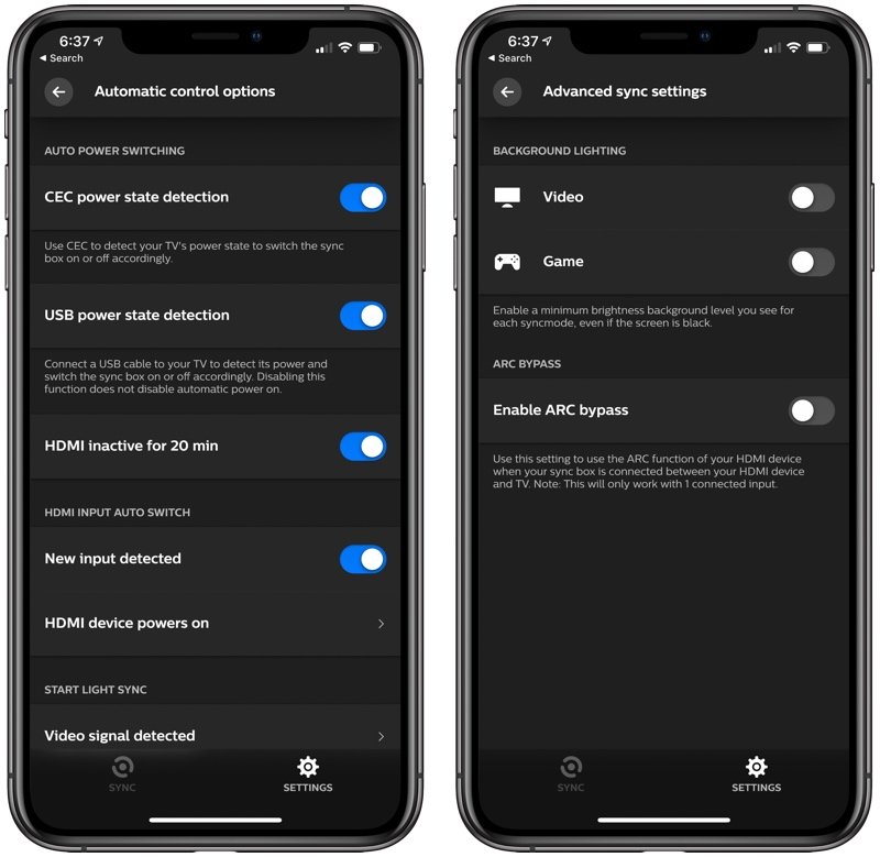

There's an option to set a minimum preferred brightness level and there's an important setting in the "Advanced" section for minimum brightness. To prevent the lights from going off entirely when the screen shows scenes that are black, the minimum brightness setting should be activated to keep a minimum light level. During my testing, I found that there are a surprising number of completely black scenes that cause the lights to go off, which is distracting.

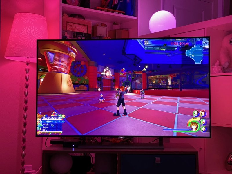

I've been testing the Hue Sync for a couple of weeks now, and I haven't noticed much latency if any. My Hue lights change pretty much in the instant that the colors change on the TV screen.
I primarily used it with my Apple TV 4K on a 4K Sony TV, and it worked great. Everything was smooth and seamless, and the colors were detected and shifted regardless of the content that I was watching.

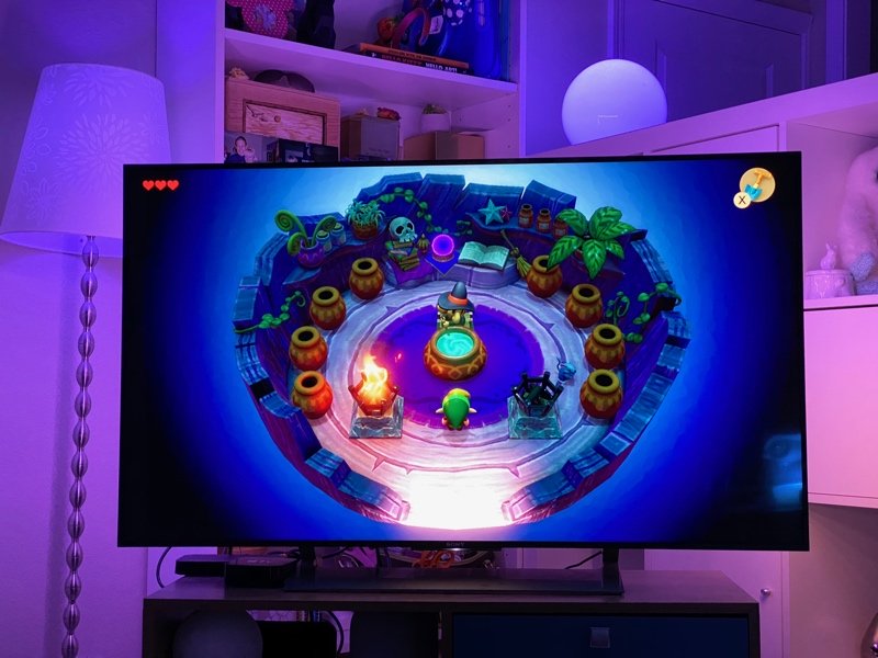

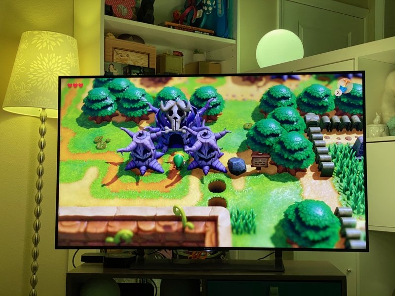

On my Nintendo Switch, the Hue Sync worked well. I tested it with Link's Awakening, and there were some neat video game features like a flash of light whenever I attacked an enemy, along with colors that matched the game environment.
I also tested with my PS4 Pro and had no problems getting the syncing features to work properly. With both my Nintendo Switch and my PS4 Pro, I saw no lag issues with the color changes. As mentioned above, that's with six active lights and a 4K TV (without Dolby Vision).
There's an automatic switching feature (activated in settings) that swaps between different HDMI inputs when a console or Apple TV is activated, which worked well for me, but switching via my remote did not work (since everything is technically routed through one of my TV's HDMI ports) so any manual switching between inputs needed to be done through the app.
Unfortunately there were a few occasions where the automatic switching feature did not work as expected (mostly with my PlayStation 4) and I had to use the app

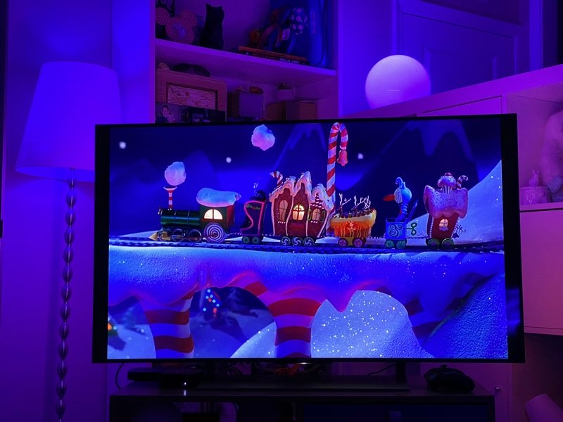

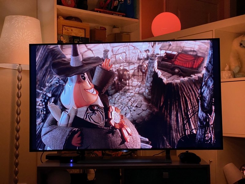

I thought the still images looked interesting but realized how insanely distracting this is by watching the video.
It would be interesting to see the "subtle & moderate" options the writer mentioned. This particular video & the movie (...Before Christmas) seemed to be on a higher setting. Any animated film or video game that has particular bold colors may lend itself to higher settings, but I could see that becoming distracting. Cool for a few minutes, then too much.
But something like Star Wars on the lowest subtle setting.....might just add a nice bit of ambiance. But with that price point, I'm not sure an occasional bit of ambiance is worth it.
