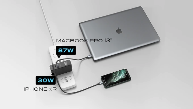

There are already 100 Watt and even 120 Watt chargers.
Just an example of multiple high Amp charging....
That 120W charger PLUS an adapter would take up as much room in my luggage as the Passport II and is a much more versatile pairing. I'll buy one for sure once it's a real product.
60W is enough to trickle charge overnight, but it's not enough to charge an MBP that is in actual use, meaning GPU active and one or more cores pegged. I can say this with certainty because we have 60W chargers randomly throughout our office and when I'm plugged in to one it's common I will lose power within 2 hours.
(IMHO) The above charger does not solve anything, when in a different (Plug) region you probably use other devices so a separate adapter is still needed.
This one is an all in one, like the iMac, many people don't want a screen and a computer in one, same goes for this charger.
