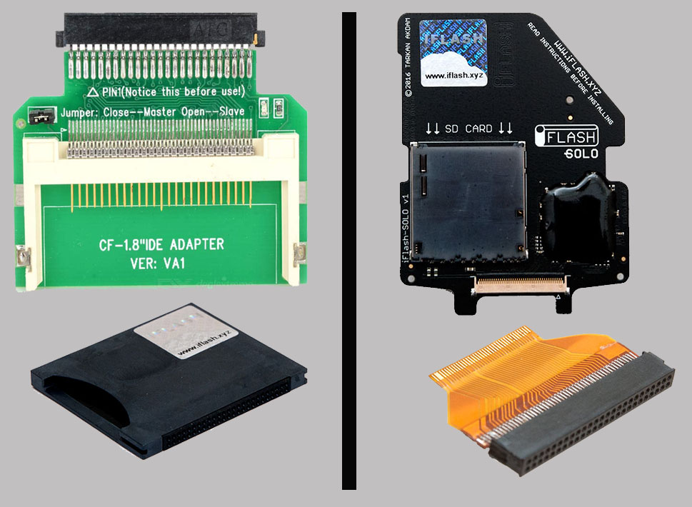

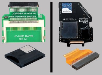

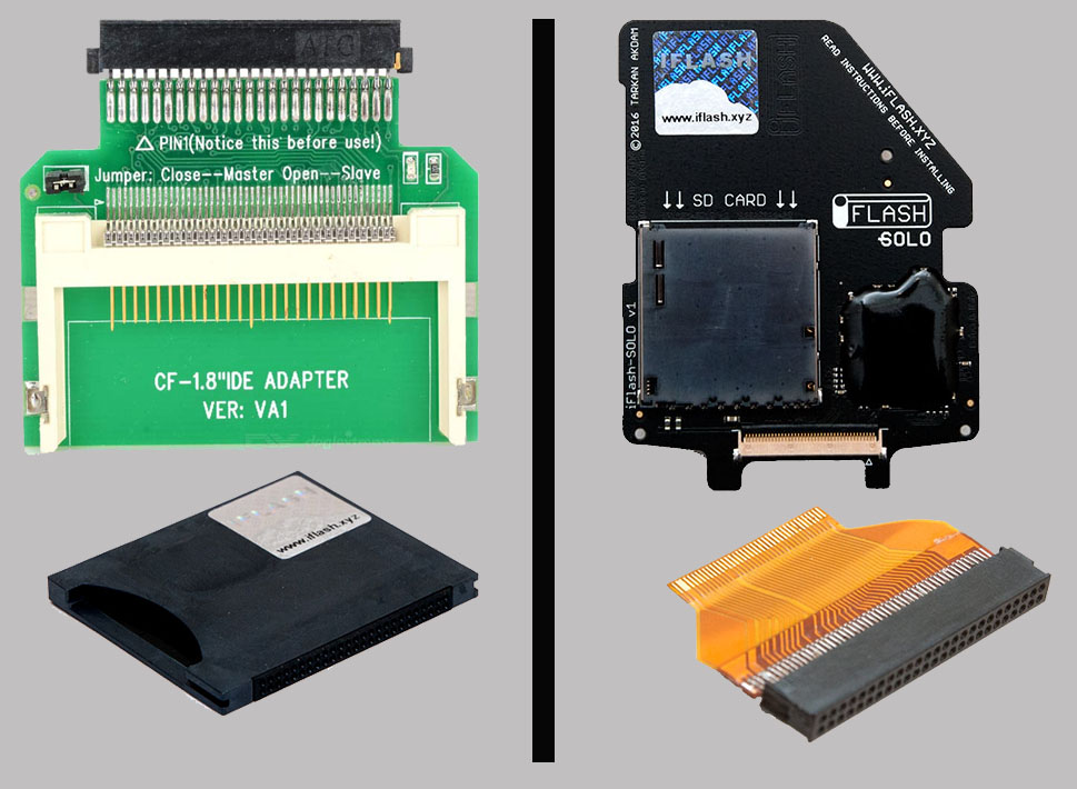

There are 2 options that will work with the 3rd gen.
Compact Flash to 50-pin IDE adapter and Compact Flash to SD adapter
or
iFlash-Solo and 50-pin to ZIF ribbon cable
