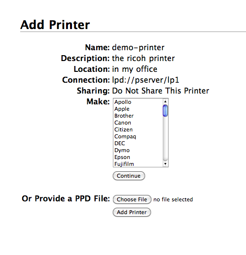

Looking at it right now. The old config is gone. What I can remember is that I either downloaded the ppd files from ricoh or used the gutenprint ppd's.
Then I http://localhost:631 in the browser to access the cups interface. There you can specify the name of the printserver, printername and ppd file.
(Can't remember why I didn't use the System Preferences->Printer dialogue)
Hope this helps.
