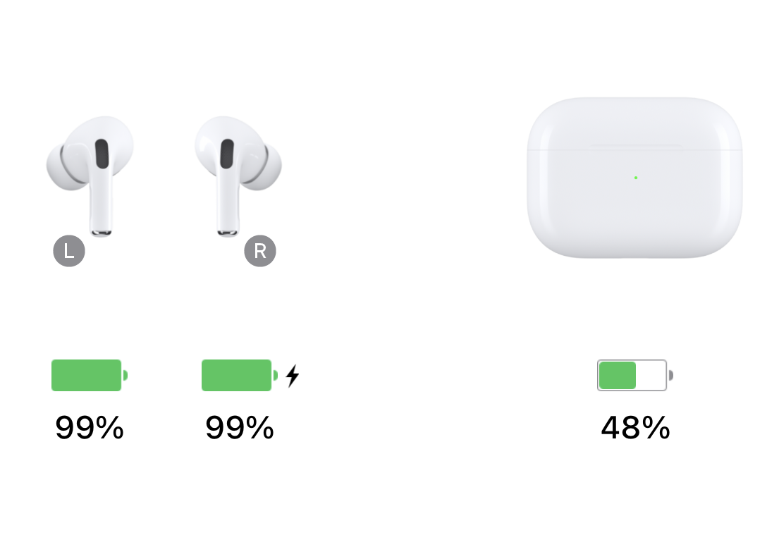

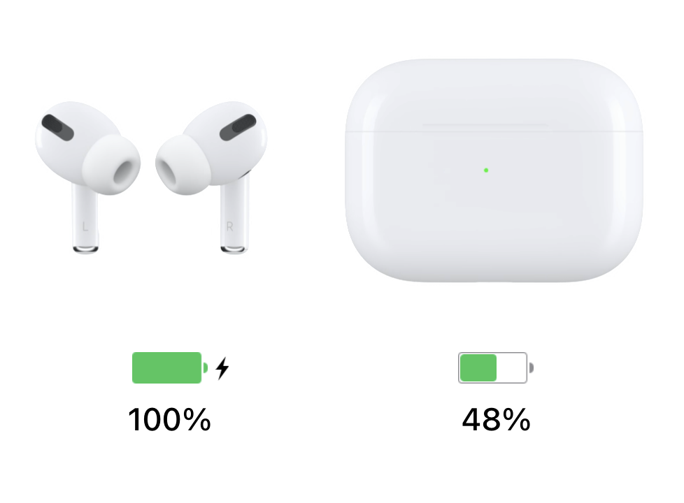

Does your iPhone register a battery level for the right AirPod? Here are two ways to check:

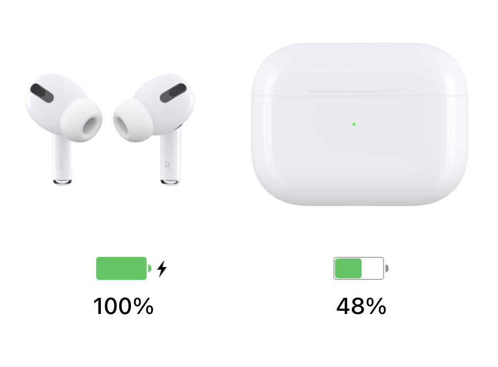

1. Put both AirPods in the case and close it. Unlock your iPhone and leave it on the home screen. Bring your AirPods case near to the iPhone and open it. It should display the battery percentage for both the AirPods and the case:
Now remove one of the AirPods from the case and leave the other one in the case. It should then show the individual battery levels*:
*If one is lower than the other, I think it will show both percentages even if they're both in the case still.

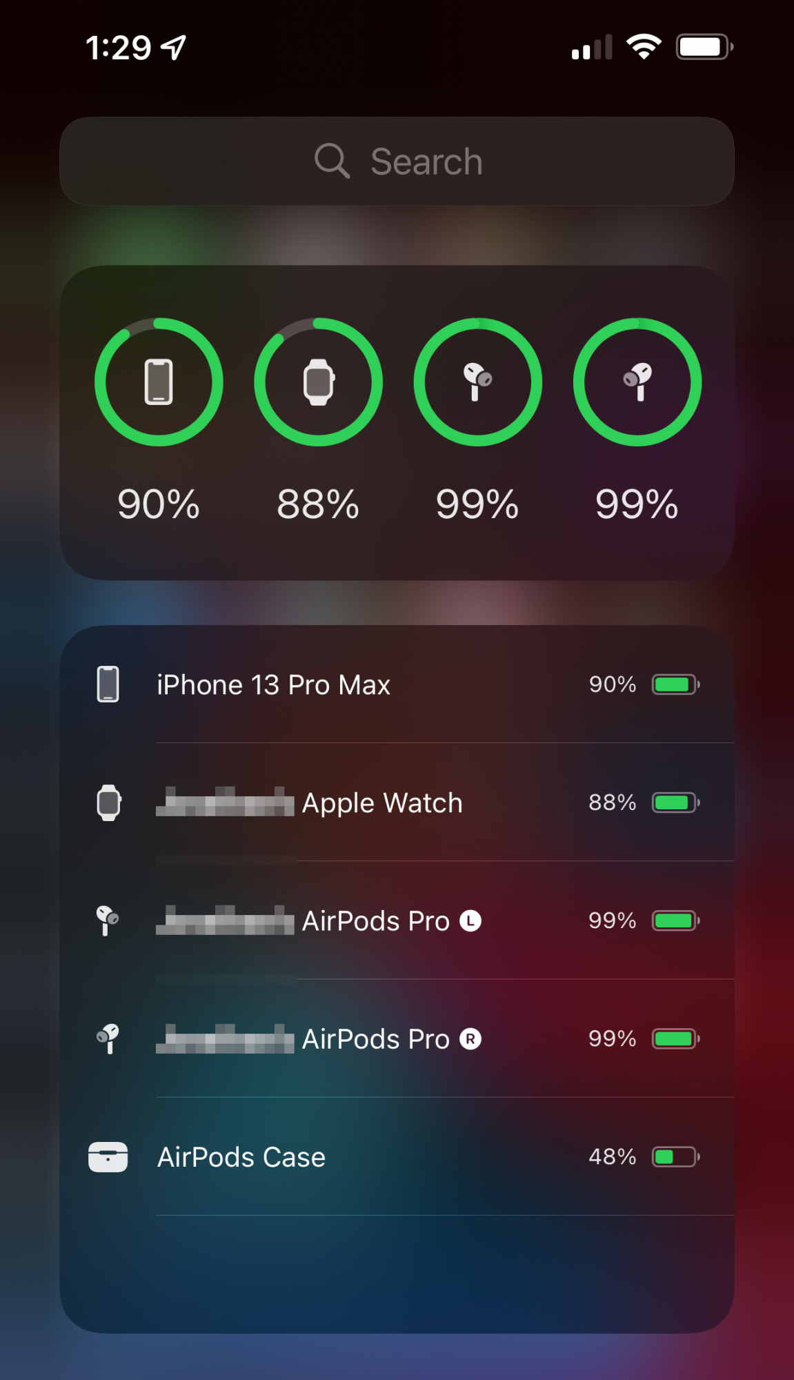

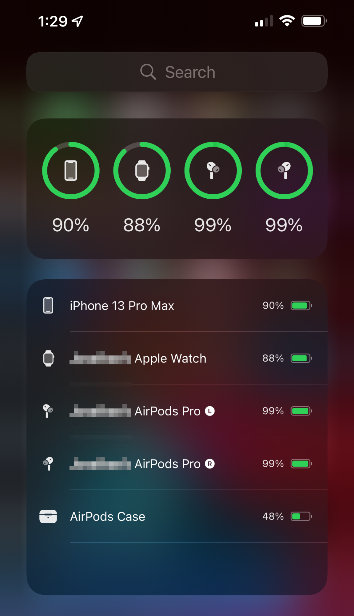

2. Add either one of the battery widgets that show the percentages and leave one AirPod in the case:

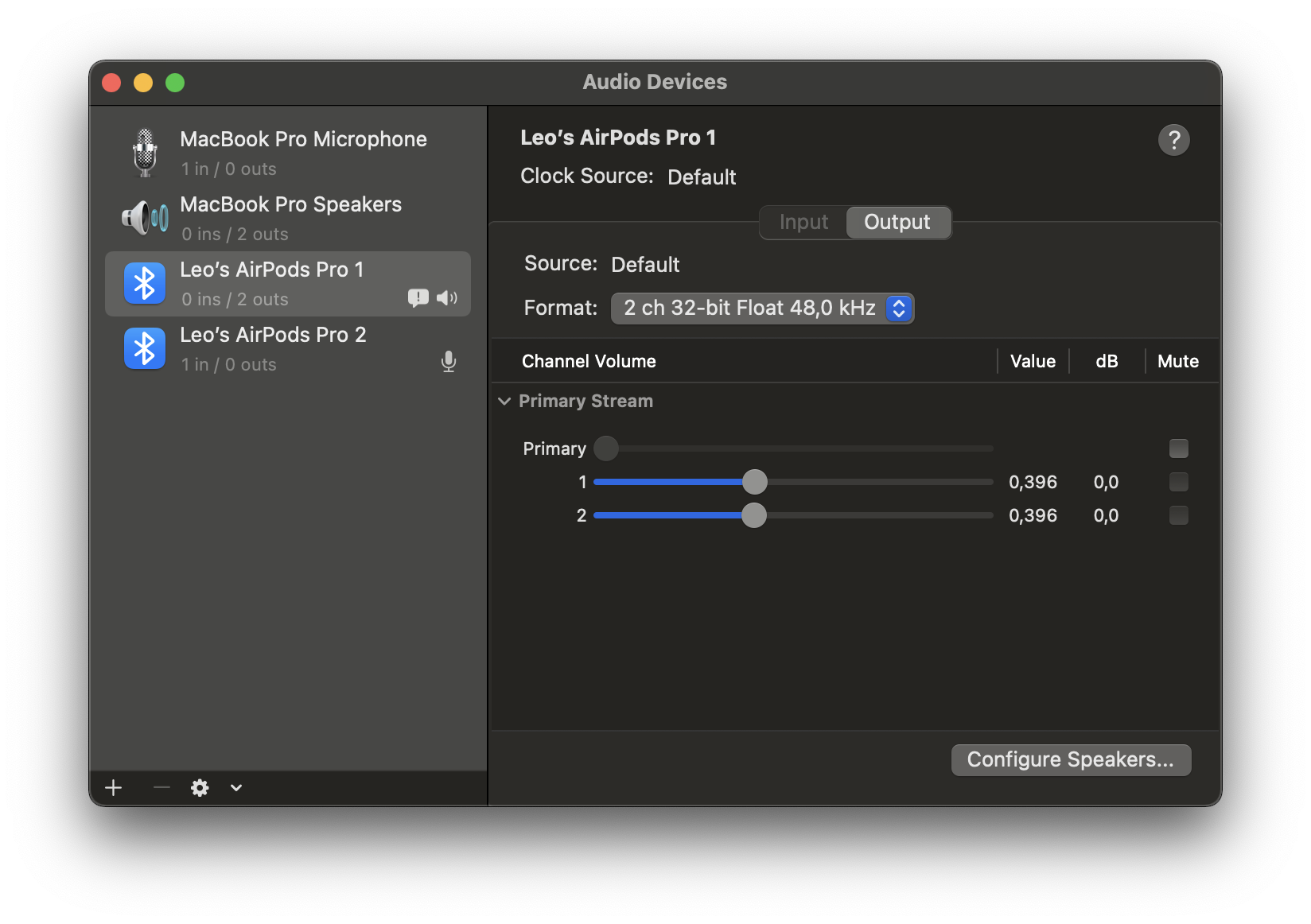

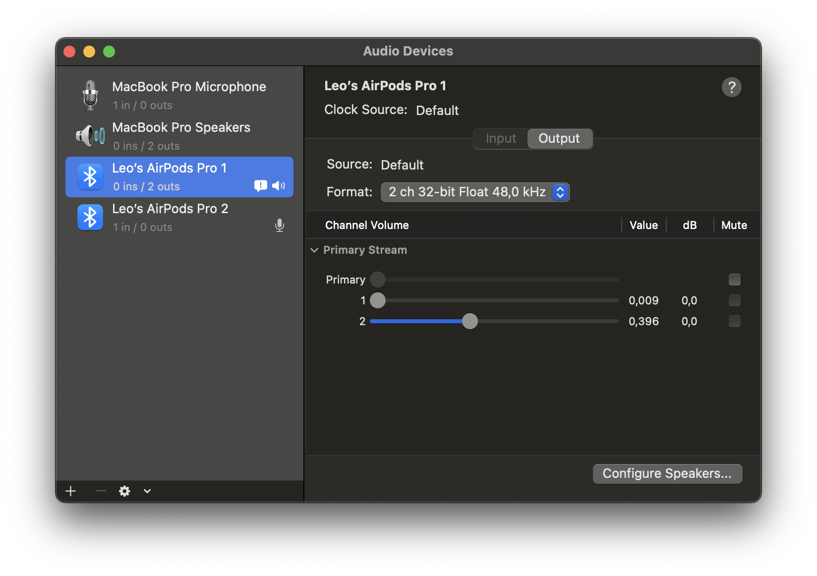

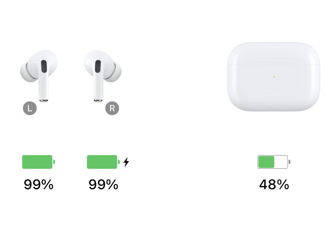

Something similar happened to me. In my case, the single airpod IS connected, but just no sound come out of it, except for when I switch between transparency, noise cancellation and off.
After a little troubleshooting, I noticed that in the MIDI app, on my Mac, one of the two airpods' volume was set to zero. To fix it, I just raised the volume bar to the same level as the other airpod.
