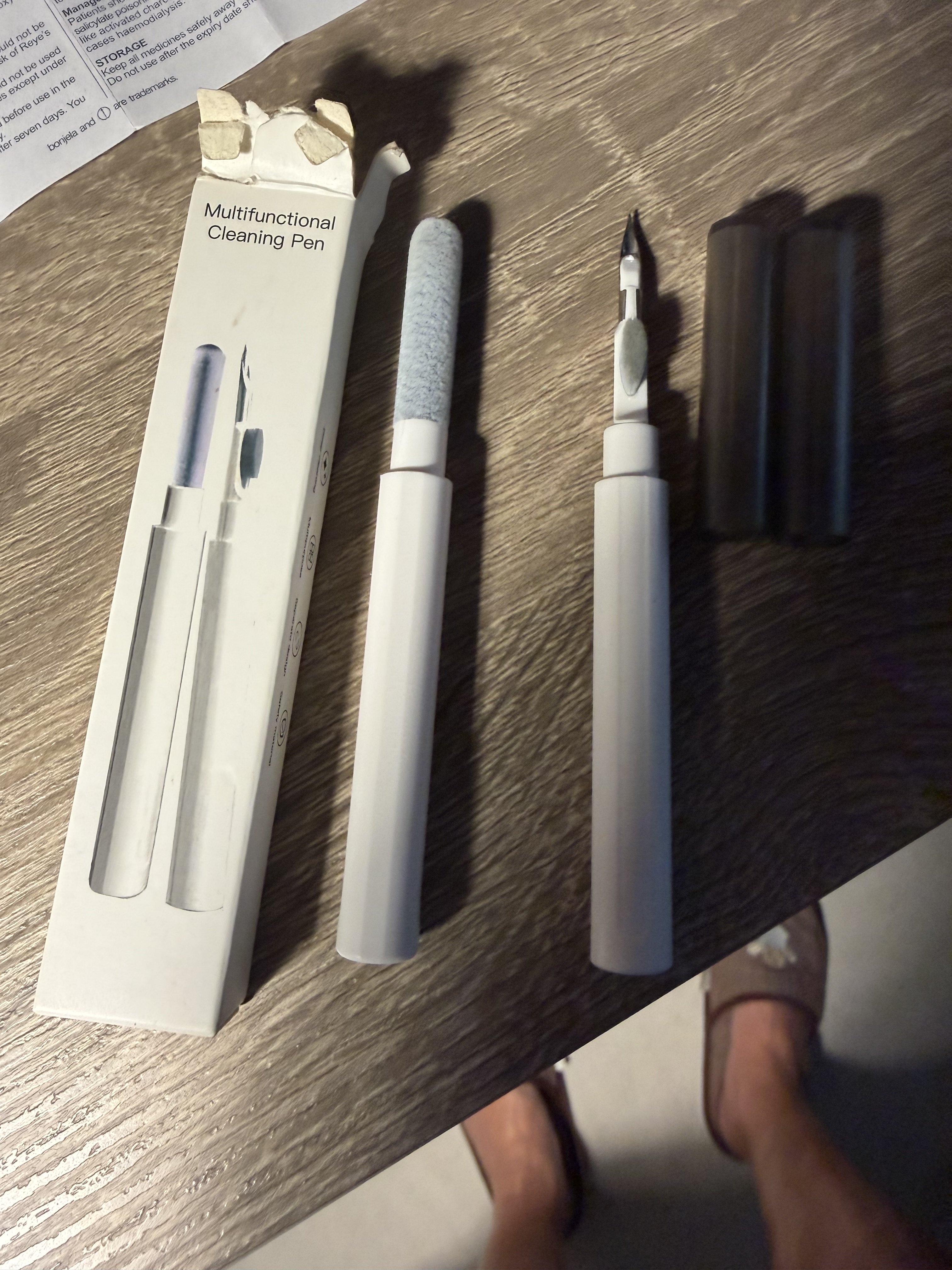

Clean the contact in the case for the right side. I have had this same issue with both my AP2 and AP4's
These cheap AirPods cleaning kits are a good investment. The long foam tip is for reaching down in the case to clean the contact in the case. IMG_4611.jpeg
I cleaned the base of right side of the case with cotton buds and also had some isopropyl alcohol sprinkled on a microfibre cloth and then tried to clean the base of the right side in the case, it has not helped. The Result is the same.
The tool on the right is good for scrapping the contact in the case, maybe the contact is depressed so it doesn't make sufficient contact. Try putting pressure on the right AirPods with the case open and see it shows charging on your iPhone battery display, I have read that some people have needed to put a piece of pressure tape in the top of the case so as to push the AirPods down on the contact.

I believe he is referring to using a tool like in my earlier post and try prying the right case contact slightly up. However that said, if you push down on the right AirPod and it still isn't charging past 1% then it appears that the battery in the AirPods is shot.
