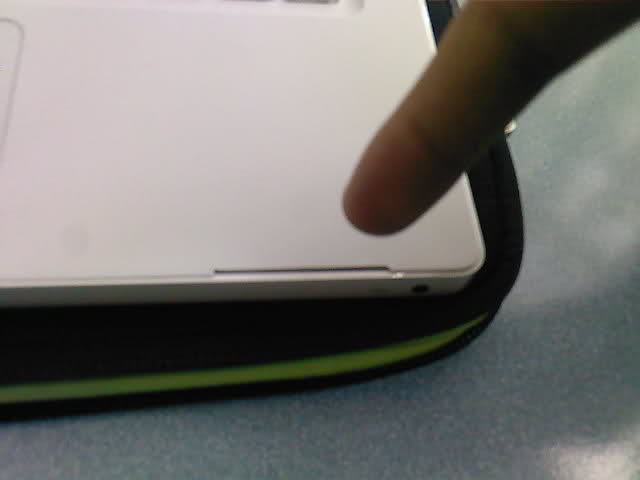

was just wondering if anyone's chipped their macbook on top right bottom corner accidentally because it seems as tho my frds has too on the same spot.
its weird coz all 3 of us have ripped the top bit on the bottom right hand corner without knowing it would come off. anyone know if i can get a replacement top for this through applecare? has anyone done this to their macbook?
here's pictures of what area i'm talking about.
white macbook
black macbook
This happened to my friends Macbook.
He called into applecare and got it sent off and back within a week.
Definitely call, mention that your case is cracked. Why in the world is it that one spot on the macbooks?

It is where the lid closes. The little standoff on the lid hits that area, and unless you are painfully careful in closing your machine, it will hit there with too much force. It also doesn't help that most of the plastic that makes up the topcase is around 1mm thick except right along the edge where it forms a lip that is paper thin.

Just for other people's reference - my wife got a new MacBook about three months ago, and it developed the exact same chip as in the picture above. Clearly, it had the same cause - the plastic nub on the upper lid hitting the bottom palmrest and chipping off that single piece.
I'm happy to say that we took it in to the local Apple Store, and they fixed it within an hour with no fuss. No need to ship your MacBook and wait a week if you've got an Apple Store nearby!
