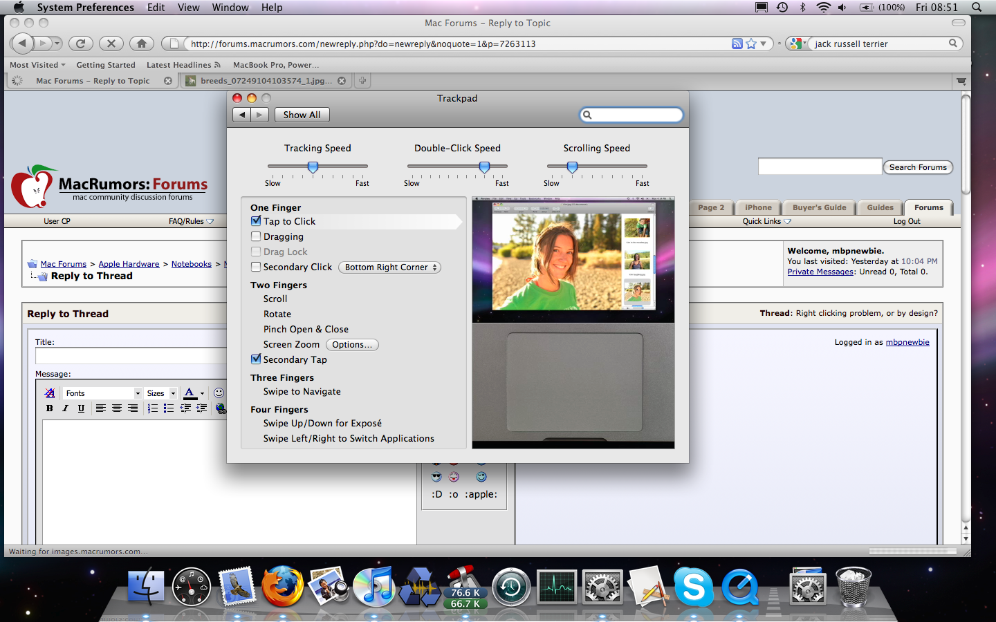

Tap to click allows me to right click in the bottom 1/6 of the trackpad, plus it makes double click easier and quieter.
