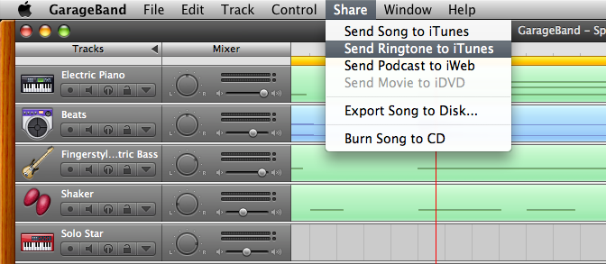

    Do You Have This?!?
    Do you have this option? This is what you need to find in garageband. or use another method.... ok?

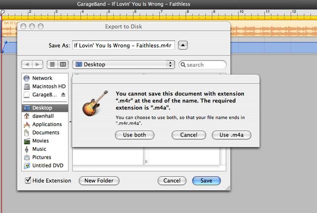

    Poop! It didn't work for me.
    I got this message and I did the "share" to my desktop and tried to rename the file. Now what? :)
    [​IMG]
