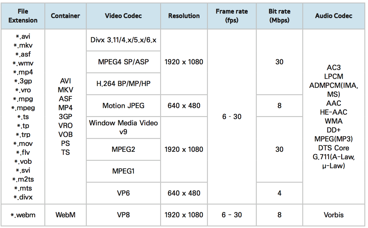

anyone know how to do this? its driving me nuts. Have been through every possible profile , adjusted settings, but cannot get it to play on my samsung smart tv.
There has GOT to be a way!
HELP......
below are the settings my Samsung smart TV can see.
UPDATE - change to above, it would seem a simple NORMAL profile on handbrake will work, however these file splay off a usb stick plugged into my samsung. They will NOT work when trying to play from my WD y book live NAS. guess the problem is with the NAS not the TV.
