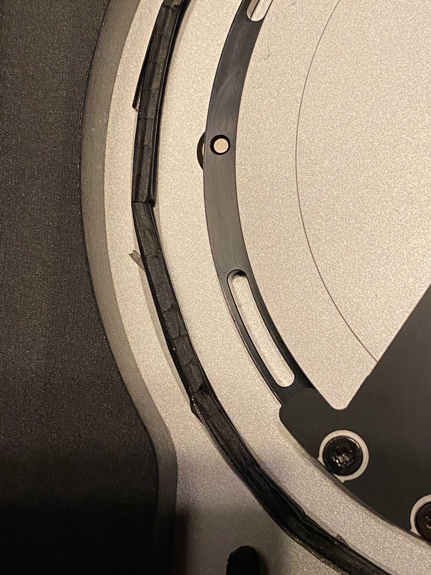

Has anyone else noticed a ripping or tearing sound when turning the case handle or pulling the case off the 7,1 Mac Pro?
I noticed it the first time I opened it, and then again recently. I inspected the inside of the removable enclosure and it looks like the material on the inside of the case where the handle that spins might be damaged? Not sure if it’s normal or not.
I took another closer up shot. It looks like if I push gently on that circle of foam it makes the sound I’m hearing. Almost like tape. I’m guessing that material is some sort of foam covered with a tape like material. I wonder if anyone else’s looks like this or if it’s a perfect circle?
That is NOT normal and yours is damaged. You need to get that replaced.
I figured! That makes me sad! I wonder what the odds are of me convincing Apple over chat/phone to send a replacement enclosure. Bringing this thing into an apple store or packing it up to be returned sounds like a PITA!
Yeah, you definitely found the source of the noise. Certainly they'll offer to send you a new cover.
I just tried online chat with support, and they of course just want me to bring it to a store. Frustrating.
Unfortunately predictable, but perhaps this will get back to the production line and potentially save someone from this annoyance later.

Perusing through old watched threads, and I realized I never followed up on this post. I did end up taking it to the Apple store (using a mini dolly cart ? ), and they replaced the removable part of the enclosure. Sure enough, that circle of foam on the inside was in much better shape than my original one was.
Glad it got fixed.
