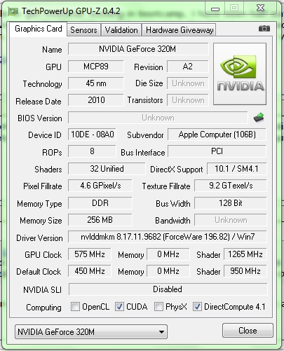

Do me a favor and get gpuz, then run that program and tell me what the chip is (EG GT216) and the full device ID.
Does this help?

Ok, this is just a guess, but rivatuner will tell me if I'm wrong or not. Edit "rivatuner.cfg" and go down to the [GPU_10DE] Block. Add a line at the end, G105 = 8A0h-8AFh
Use tab between G105 and =
Next, you'll see a much of "Alias = ..."
Add two new lines,
[GPU_G105]
Alias = GT300
Again, use the tab
Finally, find "[VEN_10DE]" and add a new line:
DEV_08A0 = "NVIDIA GeForce 320"
again...the tab.
Save the file and run Rivatuner and let us know what happens. Do a quick underclock and check using GPUz if it actually works. You can also check out the hardware monitor. Both cases it still fails for me, but it's the first step to getting this working.

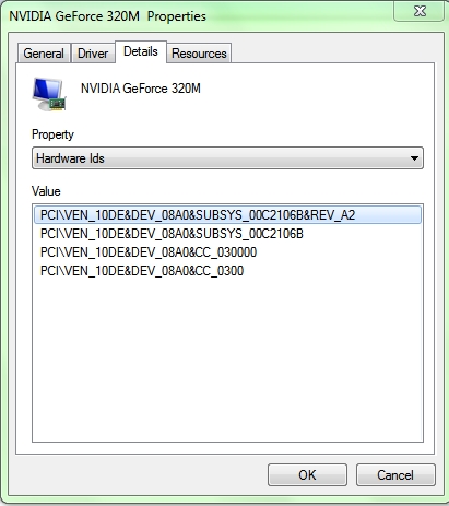

Should that be VEN_10DE_DEV_08A0 = "NVIDIA GeForce 320" ?

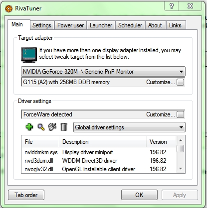

That's how I added it...fit better with the others. The GeForce 320M is recognized, but when I entered the Settings field from the ForceWare detected entry the program didn't distinguish between 3D Low and 3D Power frequencies: both were 450 / 810, although the 3D power frequencies should be 450 /950 as far as I know. Changing either the clock or shader frequency also had no effect as verified by GPU-Z.

Well, yours is actually a G115 card as displayed, thanks, and adding the Ven line never made a difference on mine. Now that we have the correct chip names for rivatuner, we have to wait for the next release 🙁
