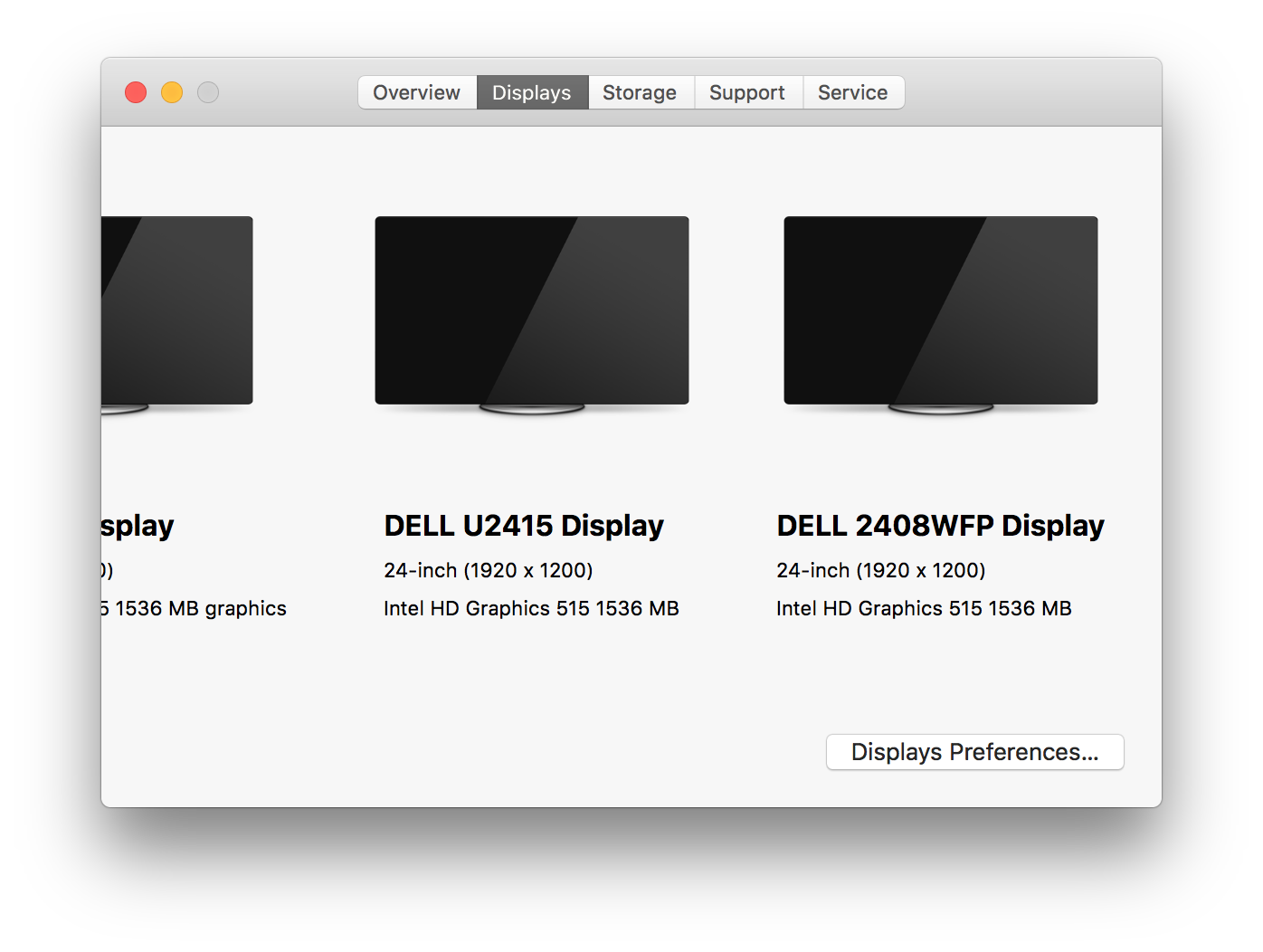

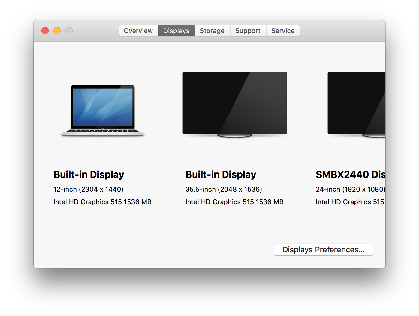

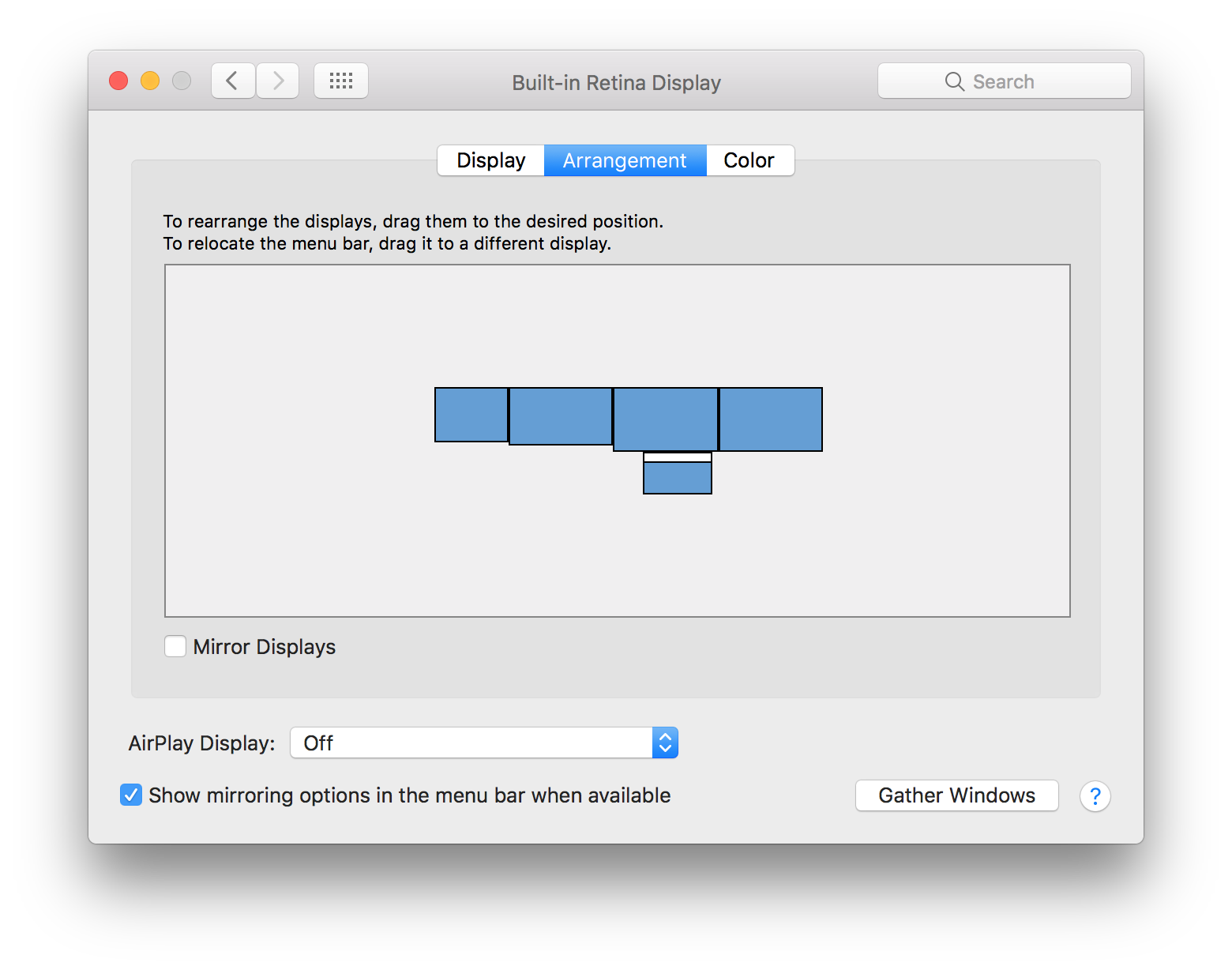

I haven't used a USB-C hub, but that's because I've been using a Plugable 5900 USB-A 3.0 dock I had from a previous set up with an Apple USB-C/VGA/USB-A adapter. I've been able to run 3 external displays off of it. One off of the Apple adapter and 2 off of the Plugable. I used this setup with a 2015 rMB (m5) and a 2016 rMB (m7). The only drawback is that Apple tends to break things with Mac OS updates that directly affect the DisplayLink drivers (USB display drivers) that most USB based docks use. However, DL usually finds workarounds and/or Apple sometimes fixes bugs.
This wasn't for video work but other professional work like software development. It's perfectly usable. But the DisplayLink displays have occasional visual artifacts since it's completely software driven, but it's fine for dealing with source code.
I just hooked up my iPad Pro 13" via a USB 3.0 port on the Plugable and used Duet Display to add a 4th External monitor. So 5 displays total. Nice. It shows up as a 35.5 inch display. Screen Shot 2017-02-20 at 2.55.15 PM.pngScreen Shot 2017-02-20 at 2.55.33 PM.pngScreen Shot 2017-02-20 at 2.54.25 PM.png
