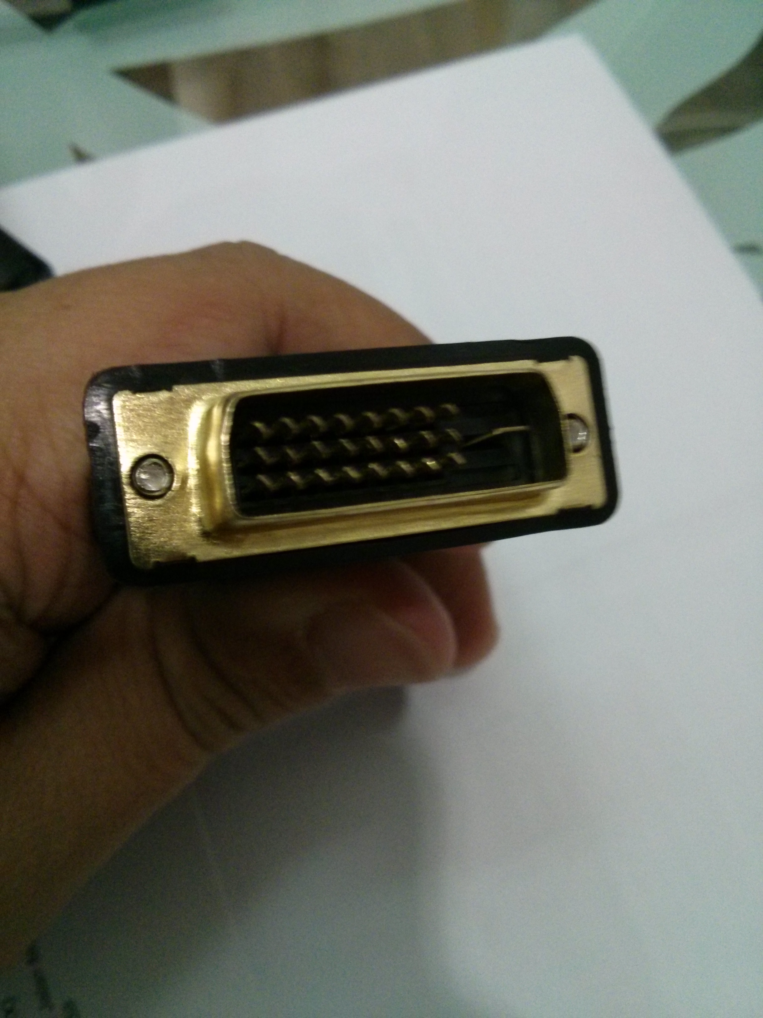

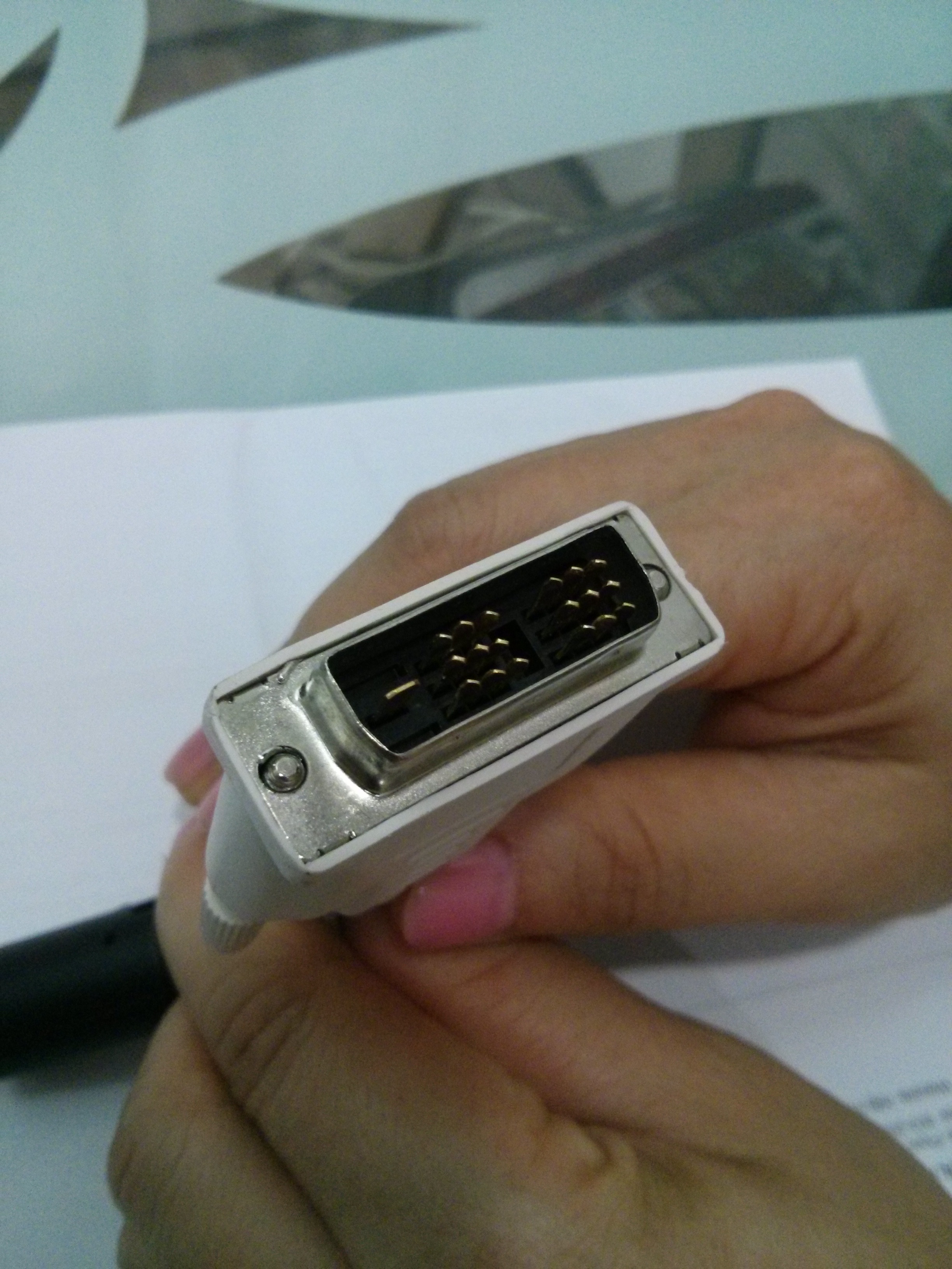

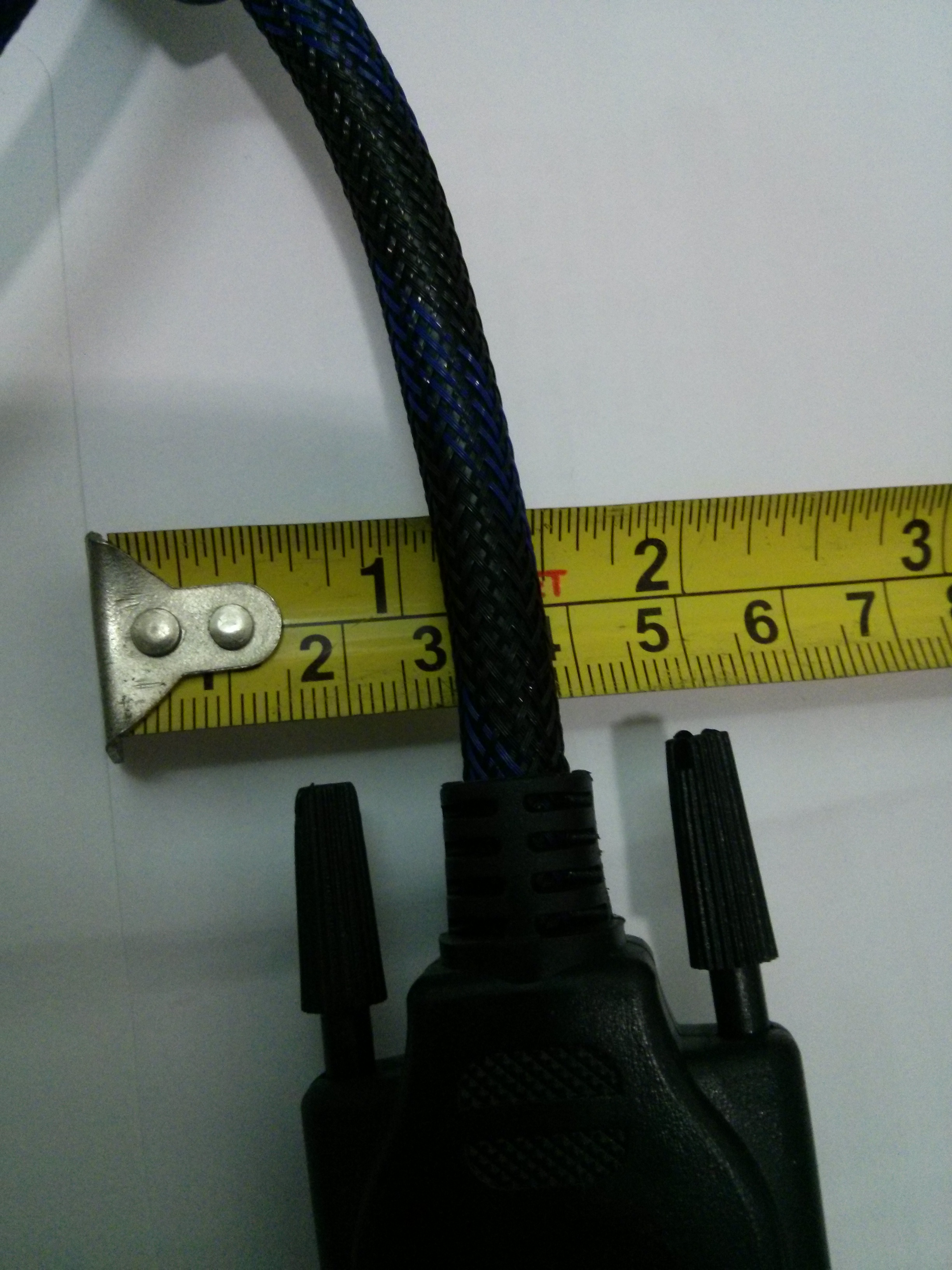

Which cable did you get? The Dual Link ones are really thick. Got a picture of the ends?
Sorry I have been out of town. Just back recently. Here are some pictures of my cables:
This is the one comes with the monitor. I'm quite sure that it is single link...
This one I bought, should be dual link...
And for anyone interested, it is around 1cm in diameter...

Yeah you're completely correct, the first cable is Single Link, the one you've purchased is Dual-Link.
I'd probably put the fault down to the Mini-DP to Dual-Link DVI connector. I've used two myself and found the Apple one to be quite finnicky. It's funny really as the cheap ones that are like 1/4th the price of Apples seem more reliable.
