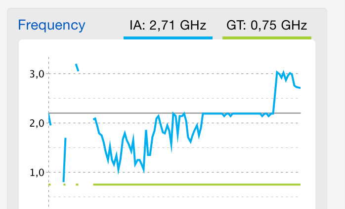

Here are the test results, using Intel's own app, Power Gadget:
attachment.php
  • At first, normal usage.
  • Then I turn off Turbo Boost.
  • Then I launch a 4K video in Chrome (google "4k youtube")
  • You can see that it tops out at 2.2 GHz
  • Then I turn Turbo Boost back on
  • You can see it going up

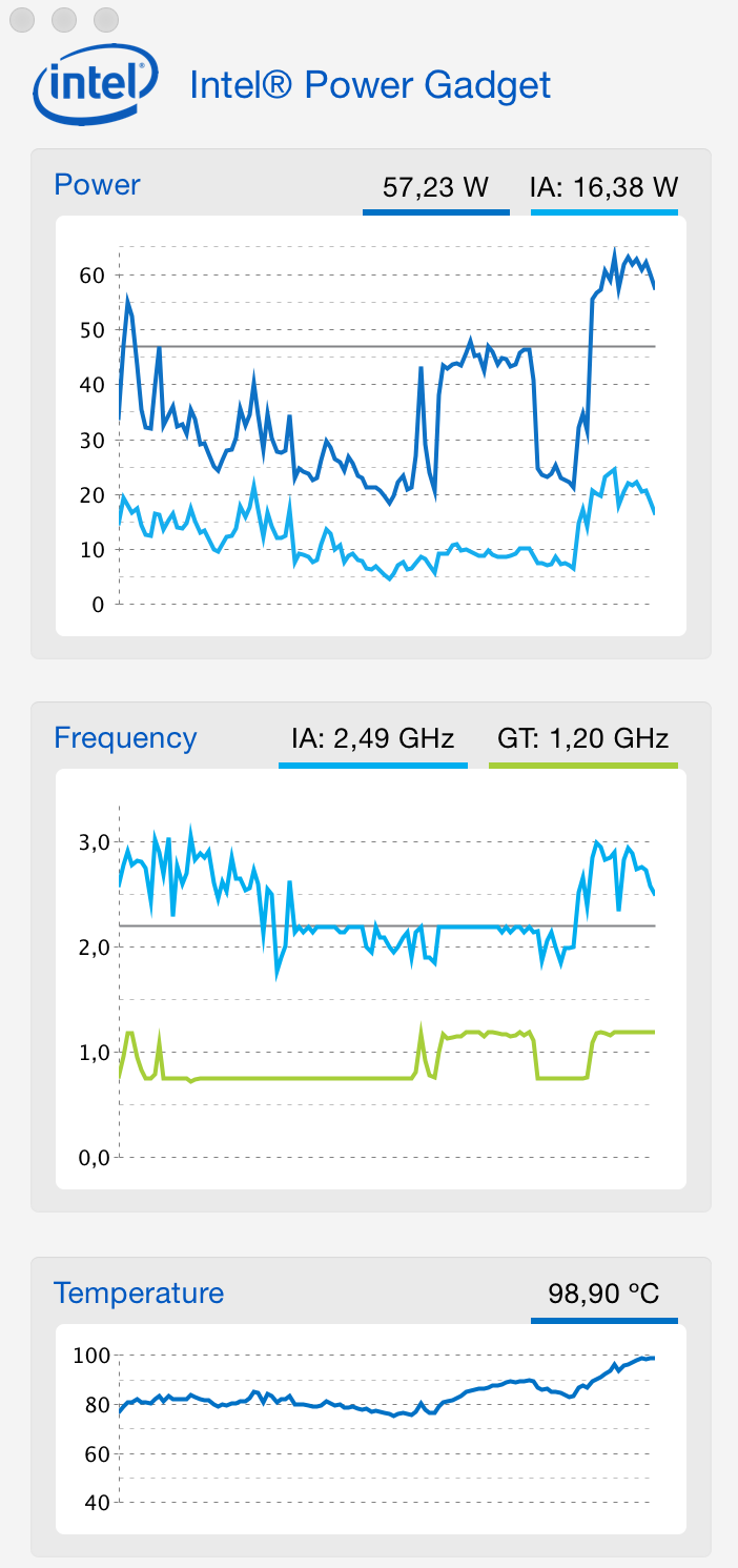

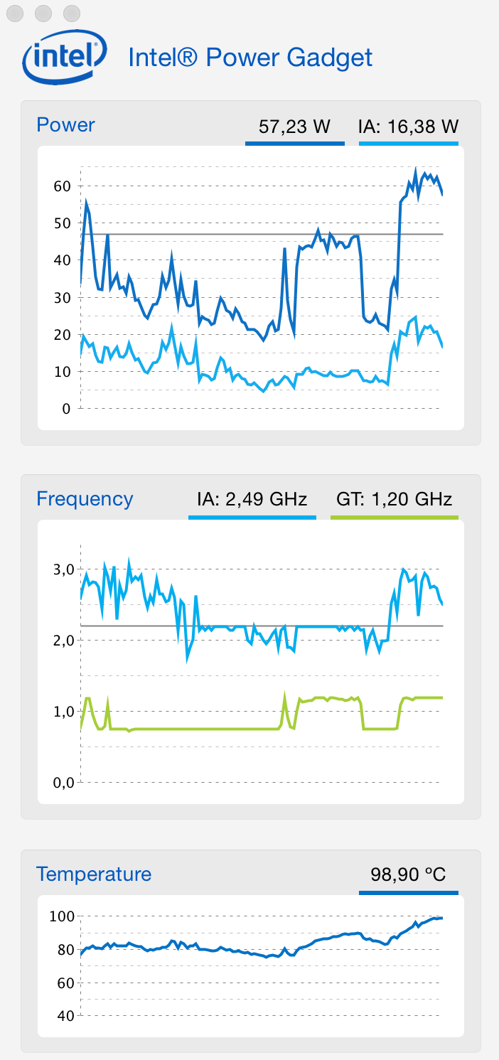

The first results are promising:
attachment.php
I pinched in an out for the desktop, while playing a 4K video.
The disabled phase is clearly visible.
Note how the power usage stays at 47W without turbo, but goes up to almost 70W with it.
