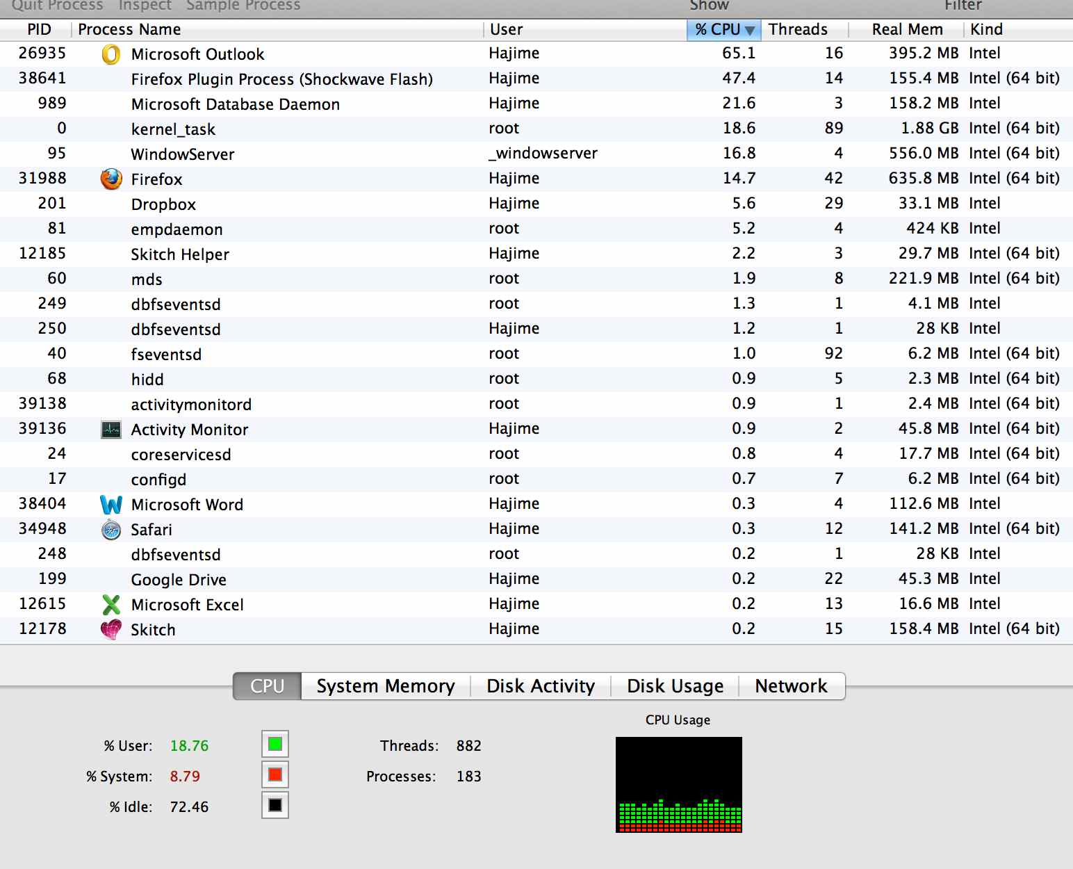

Thanks. Enclosed is he screenshot. The fan is kicking in. Never had this issue under Mac OS until few days ago.

It looks like for some reason Outlook is really eating up CPU cycles. Also looks like you have a Flash video or something playing in Firefox there.
Try quitting both Outlook and Firefox then see if the issue goes away after a minute or so. If it does, you need to figure out what is going on with Outlook that is making it do this. I'm not an Outlook user, so don't have much to offer you there. I did see this MS support info. Some info here also that might help.
Thanks. After I quitted Outlook and the CPU-hogging Firefox process (still using Firefox now), the fan slows down in about 10 seconds.
Okay... so now we know what the problem is.
