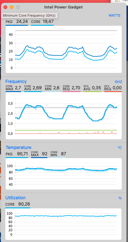

I don't think that the dGPU is the problem. Even when it is disable (I can check that with iStat Menu) the MacBook is still overheating badly. I can't touch the heatsink, attesting that it isn't a sensor issue also.
I've attached a picture of the clock going down to around 1Ghz. If I stay longer under load, it can reach as low as 800mhz. The computer becomes unusable.

Seems like the CPU, then, though it's odd that temps don't dip-bounce after throttling. My thinking is that if it was merely an element of the board near the CPU offering resistance, the board would not power on. But my thinking could be wrong. A repair shop could try to hunt down something heating up even while the board is powered off, in which case logic board could be repaired rather than replaced.
