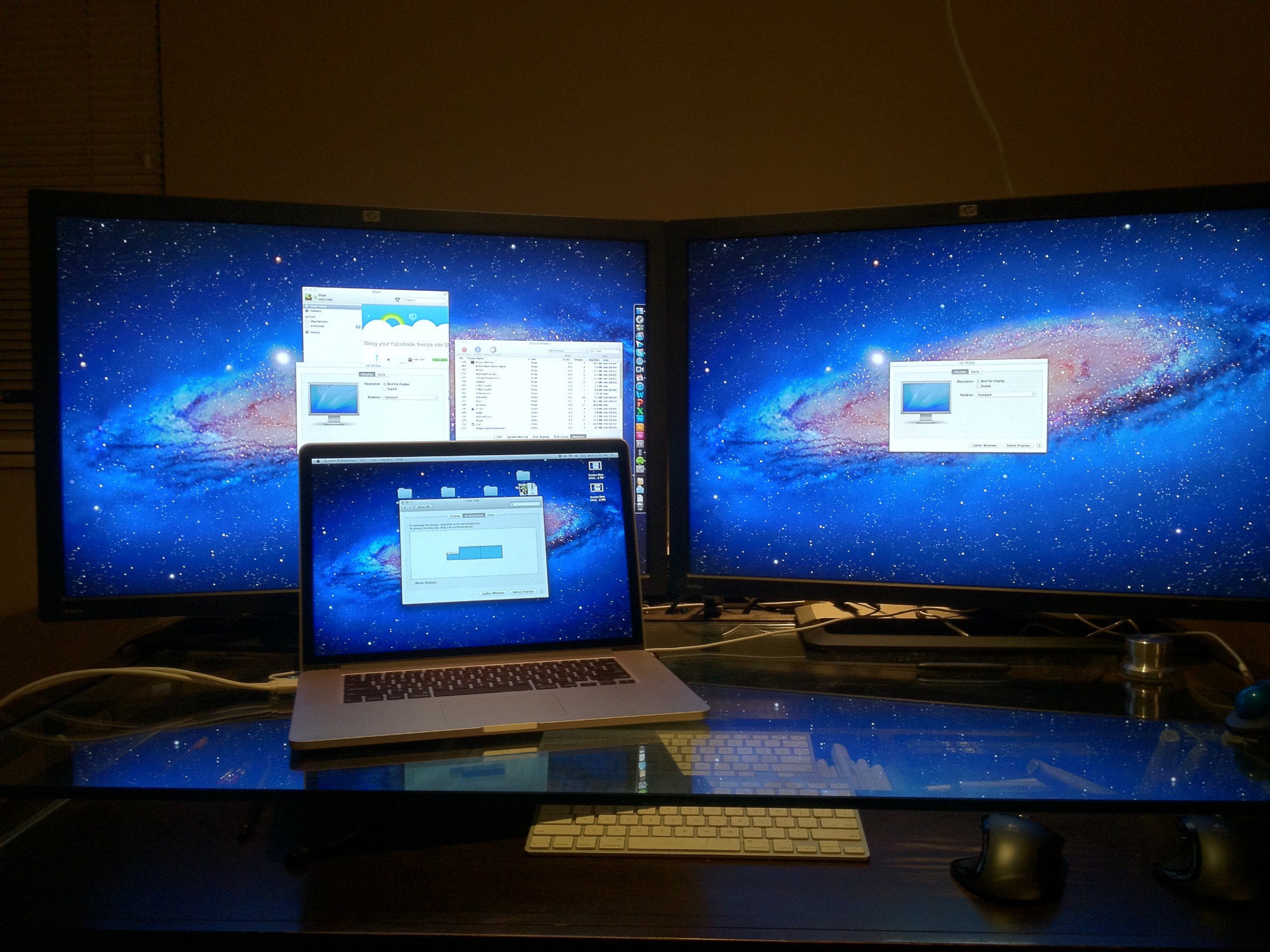

Just wanted to chime in and confirm that it does work; I'm running dual HP ZR30Ws with those cables. There's a slight bit of lag and occasionally when the screen goes back to sleep and I move the mouse to wake it up it'll stay black or wake up at the wrong resolution after sleep. Turning the monitor off and back on or unplugging the DP cable and plugging it back in fixes it. I had the same problem with my mac pro desktop and stumbled across other mac pro owners with the same issue - looks like the cable is the culprit. The "solution" seems to be getting a higher quality cable with the official DP certification although I didn't have any luck finding any (without using bulky DP to mini DP adapters) so I've chosen to live with the very occasional hiccup. Hope you enjoy the setup, it's a great machine.

I'm running dual HP ZR30Ws with those cables ... Hope you enjoy the setup, it's a great machine
Oh my, two beautiful displays, great setup indeed. Amazing to see a Laptop drive dual 30" displays along with its own panel. How does it handle under load?

I normally run it with the laptop screen off, but it feels somewhere in between my original 8800GT and 5770 on the mac pro which is awesome for a laptop (the 5770 card itself is about half the size of the MBP). It's definitely smooth enough to usually not call attention to itself but if I were to compare it to a normal macbook pro running on just its 15" screen side by side it wouldn't be that fluid. Photoshop and Illustrator run well on it but I can't compare it to the heavier 3D stuff because I migrated all of that to a dedicated PC workstation.
The 10 bit thing is quite odd isn't it? For a company that really pushes quality displays across the board far more than others it seems weird to stop short of 10 bit. Then again we're seeing a regression with the switch to glossy coatings and LED backlighting so maybe you're right 🙁
