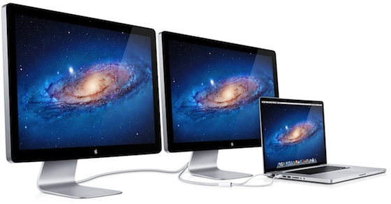

Well you could on the old 2011 MBP so I don't see why not on the rMBP.
Connect two Thunderbolt Displays to a 15-inch MacBook Pro or to an iMac and put an extra 7 million pixels to work. To make a desktop workstation out of your MacBook Pro, just daisy-chain additional Thunderbolt devices, including high-performance storage and video and audio capture devices, through the display.

Yes you definitely can daisy chain TB displays, Apple even shows it on its site:
The question however is what the maximum number of Displayport over Thunderbolt connections is, and I believe I read it was 2.
