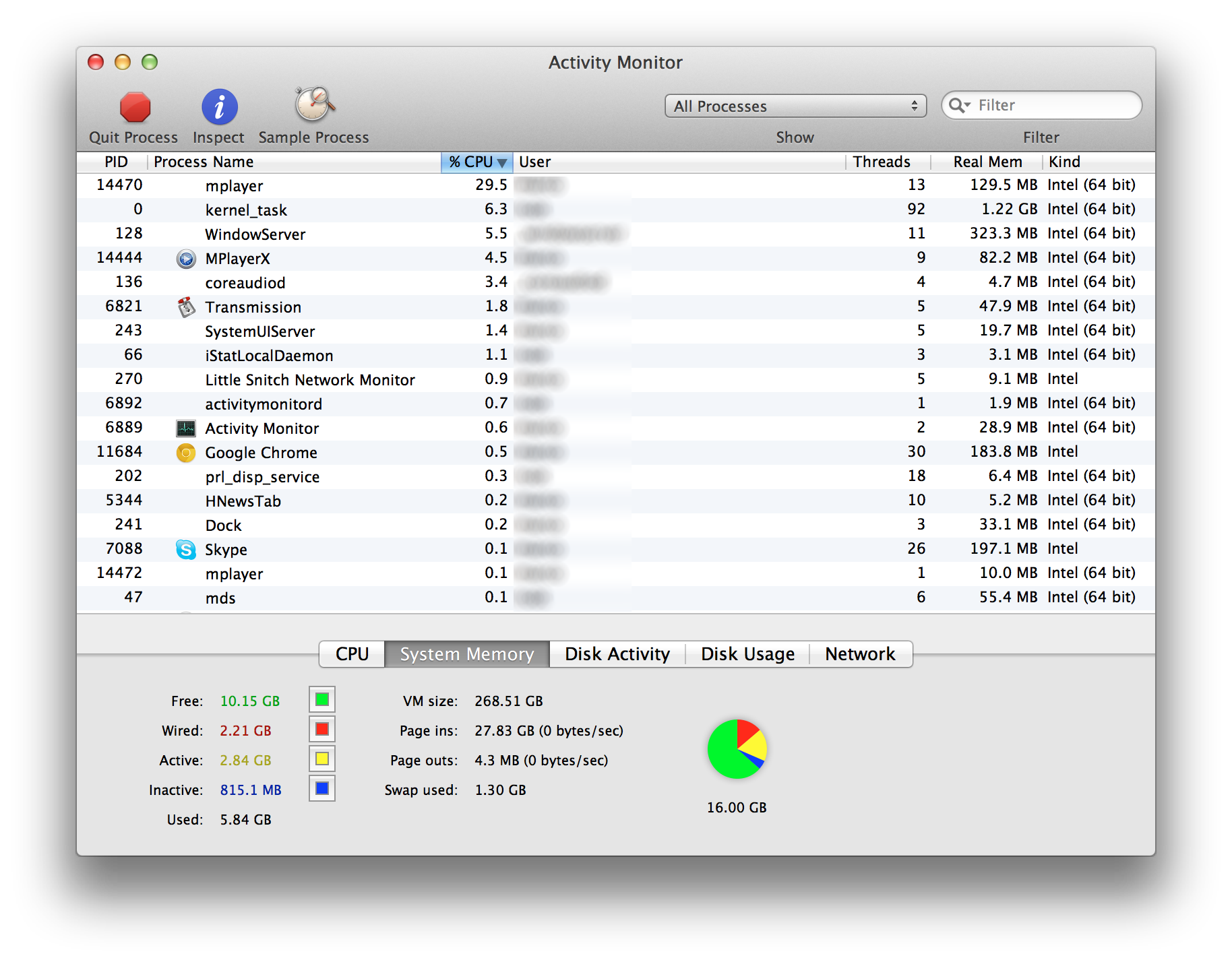

Here. Note this is single-core cpu usage.
That's significantly higher usage than the 5% you mentioned earlier. As you can see, Mplayer alone is using over 30% of CPU. That will consume more battery than if you were under 5%.
30% for one core is 7.5% cpu-usage since it has 4 cores, isn't it?
I was talking about the numbers given under the cpu tab in activity monitor (see attachment).

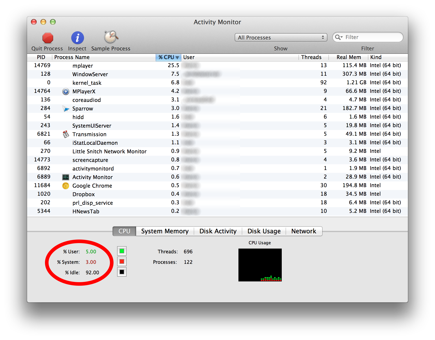

Ah, I see what you're referring to. Still, that's enough usage to drain your battery faster than if you weren't running Mplayer. As I stated before, your battery life is dependent on many factors, which change as the workload on your system changes.
